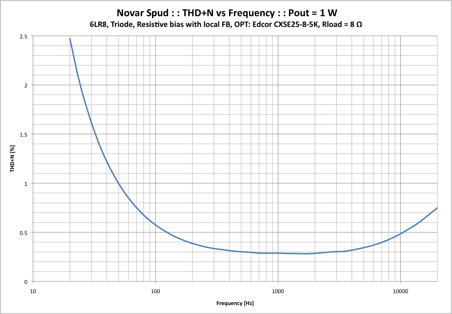

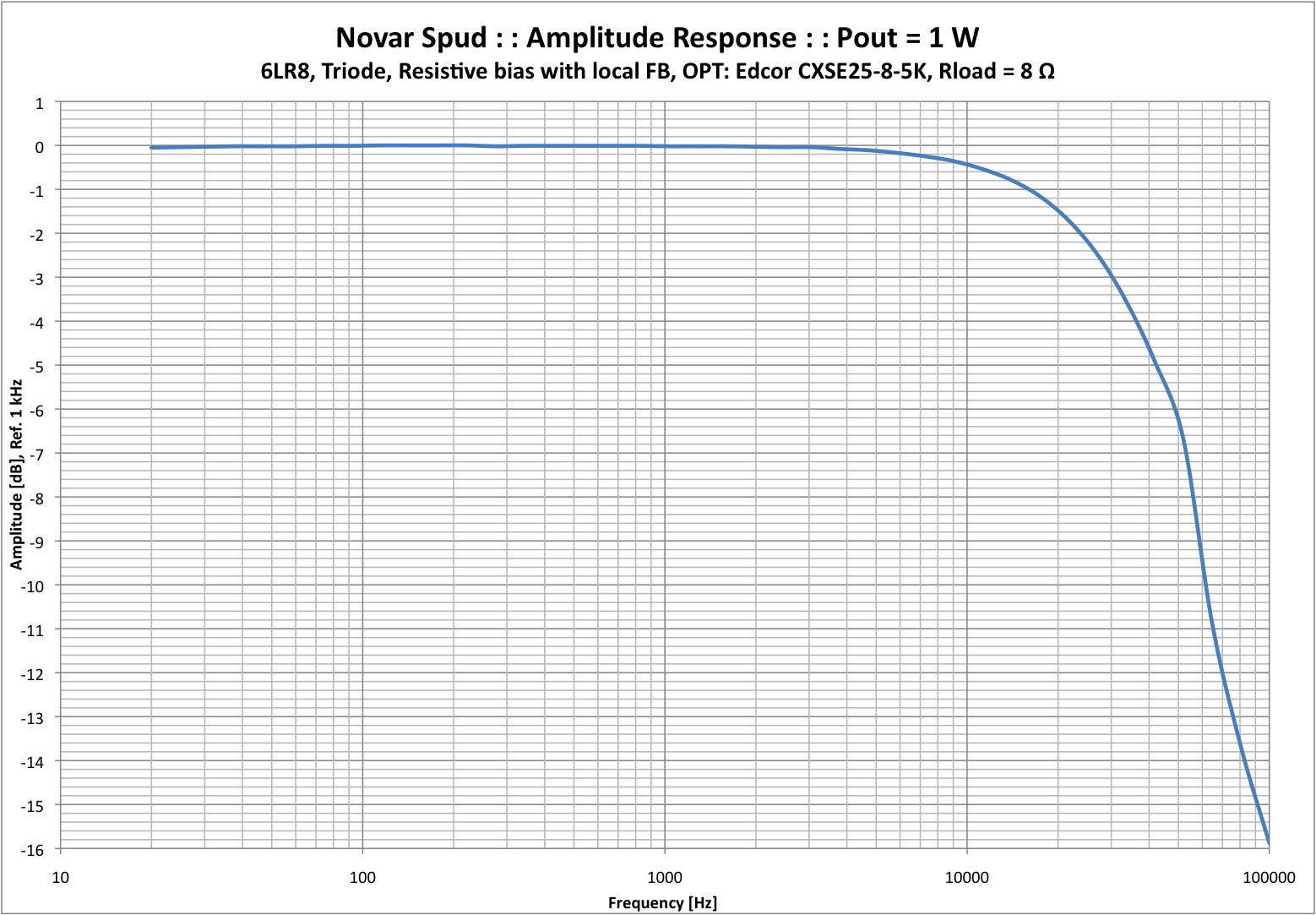

Amplitude response and THD+N vs frequency (Pout = 1 W). This with the 6LR8 in triode mode and Edcor CXSE-series OPTs. Note these OPTs are rated for use down to 50 Hz, so I'm pushing them a bit to get to 20 Hz, which shows in the THD curve.

Are you sure that is the CXSE?
CXSE is only available in 25W and rated tdown to 20Hz.
The XSE series is only rated to 70Hz, and the GXSE is rated to 40Hz.
I suspect you are using the GXSE series.
I switched to them from the XSE and chose the 15W transformers over the 10W ones even though I'm putting out less than 5W, after hearing the difference.

I'm a bit surprised by the relatively high THD at LF. In my 300B amp, I seem to recall cutting the THD at 20 Hz by a factor of 2~3 by switching from the Edcor CXSE25-8-5K to transformers from Electra-Print. Granted, the price also went up by a factor of 3 (or maybe 3~4)...

I think I see why.
The Edcor is specified at <1dBu
I'm not sure how that is measured but I think that is about 0.775Vrms
The site I found this on however is referencing 300Ohms, so I'm not really sure what they are specifying.
Can anyone explain this?
I would have expected them to spec it at 1W, or at full power.
dBu = dB ref 1 mW in 600 ohm = 0.775 V RMS. That's a standard used in pro audio.
Why Edcor use that standard, I don't know. I would rather they spec it at 1 W out or at the rated power. That does explain the higher THD at LF, though. Technically, I don't think Edcor specifies the THD at full power either. Everything is at <1 dBu. Not a useful spec.

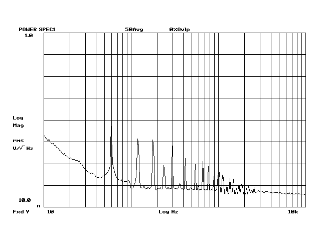

What noise?
Multimeter (800 kHz BW) says: 30 uV RMS
Spec an says 60 nV/rt(Hz) floor.
Note that I have done nothing to optimize the placement of the OPTs relative to the PT or supply inductor. My setup is an assembled board on a workbench. No chassis or shielding.
~Tom
~Tom

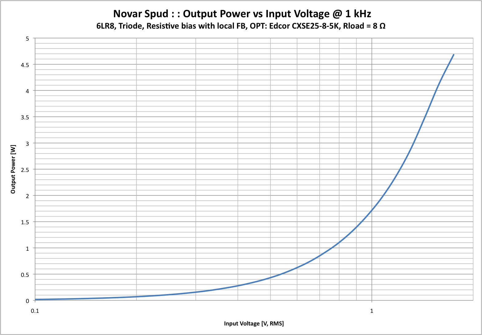

And, actually, the 4 W you get with 6LR8 in triode mode - or 6 W in UL mode - is more than enough for most speakers even when used in a reasonably sized living room. Unless you need 120 dB SPL, of course...
