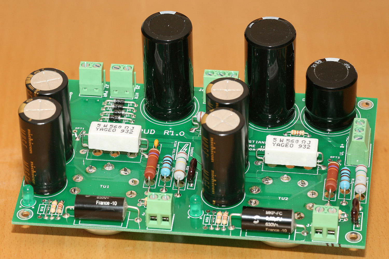

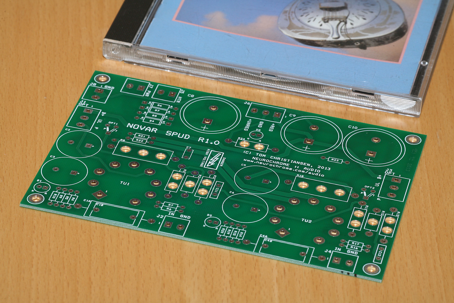

Hi Tom & everyone. The board looks great in the photo above, nice and compact. I'm keeping my eyes peeled for some kind of funky enclosure to mount all the parts into. With a very active 2 year old in the house it's going to need to be fully enclosed or at least have a cage over the tubes.
So an update on all the parts. The board is on it's way "downunder". (thx!) Antek transformer and Triad choke are ordered. 6LR8 tubes and pcb sockets from ESRC ordered. Stan was great to deal with, replied to email in like 10 minutes! My *awesome* missus has ordered the James OPT's for my birthday present! Digikey order is also done (it's just easier, last order from th local supplier wasn't good..) Already have IEC power inlet with fuse and switch. Likewise RCA jacks and speaker posts.
One part number didn't work for me at digikey, solen PPE 220. I'll try to find an Aussie supplier for those.
So I'm getting just a bit excited and really looking forward to getting started.
Any chance mine could be the first one working in the southern hemisphere?
Best regards, Pete.

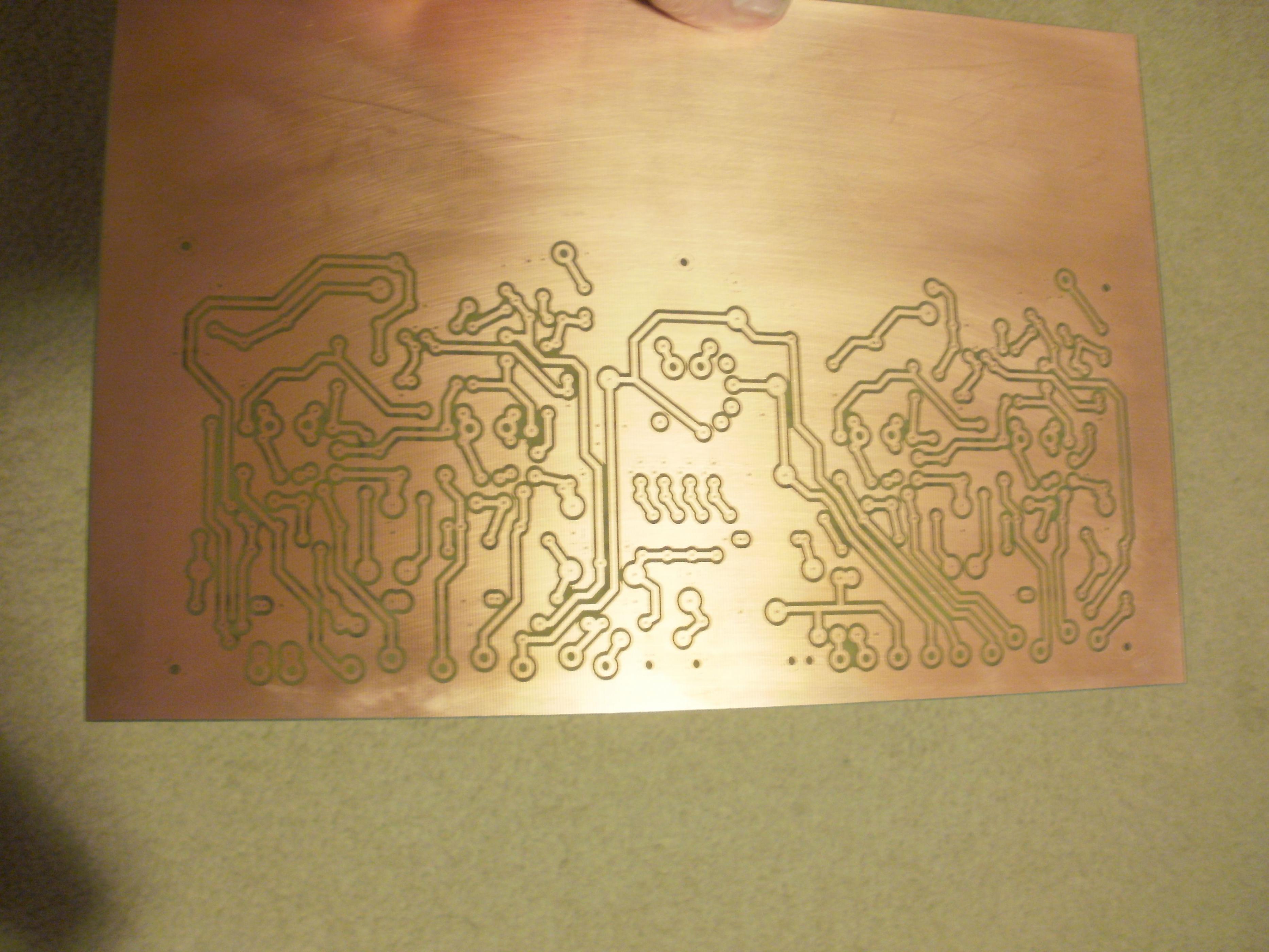

They make a very respectable PP amp. I did a toner transfer PCB design for a quick build. Sounds awesome with Bogen MX30A output iron. 6.6KRaa.
It was a universal PCB, allowed for Fixed or cathode bias, I chose fixed. Also allowed for Triode, Pentode or Ultra Linear configuration. I chose Pentode for the first amp.
I used toner transfer for my prototypes as well. Works great as long as you keep the trace/space rules reasonable. For tube circuits that's rarely an issue.
