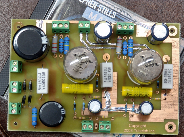

3"x5" board? That would make a nice tube amp 'mirror' to the Pass ACA diyAudio kit.
It won't fit in 3 X 5. I have a board that is nearly identical to this one. It is 4 X 6. You could physically stuff all the parts on a 3 X 5 board, but it would be cramped and heat buildup would be an issue.

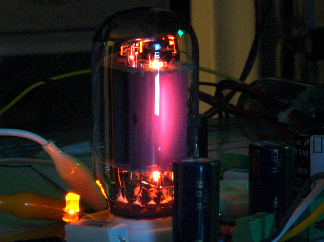

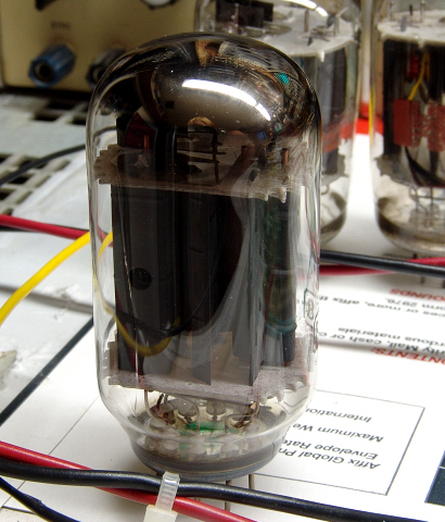

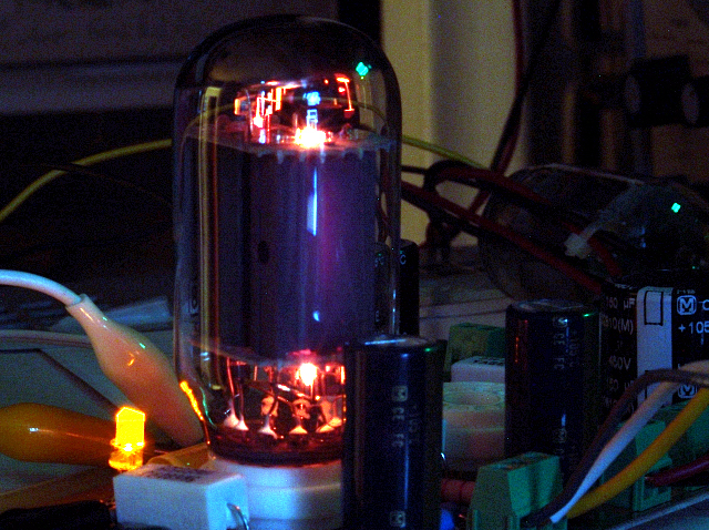

I found a 6LR8 with a crack in the glass running up the entire side of the tube. I did my best to blow it up. Didn't happen. That little amp still plays even with the cracked tube.

The board measures 3.8 x 5.8 inches (just shy of 10 x 15 cm). So 0.2 inches (5 mm) smaller on each side compared to Tubelab's board. It is possible to physically fit the parts on a smaller board, but I wanted a reasonable spacing between tubes and wanted the electrolytic caps to be a safe distance away from the hot resistors.
Note: If you open the dimensional drawing of the board in a new window and zoom in, it becomes easier to read the dimensions. Sorry for the small print...

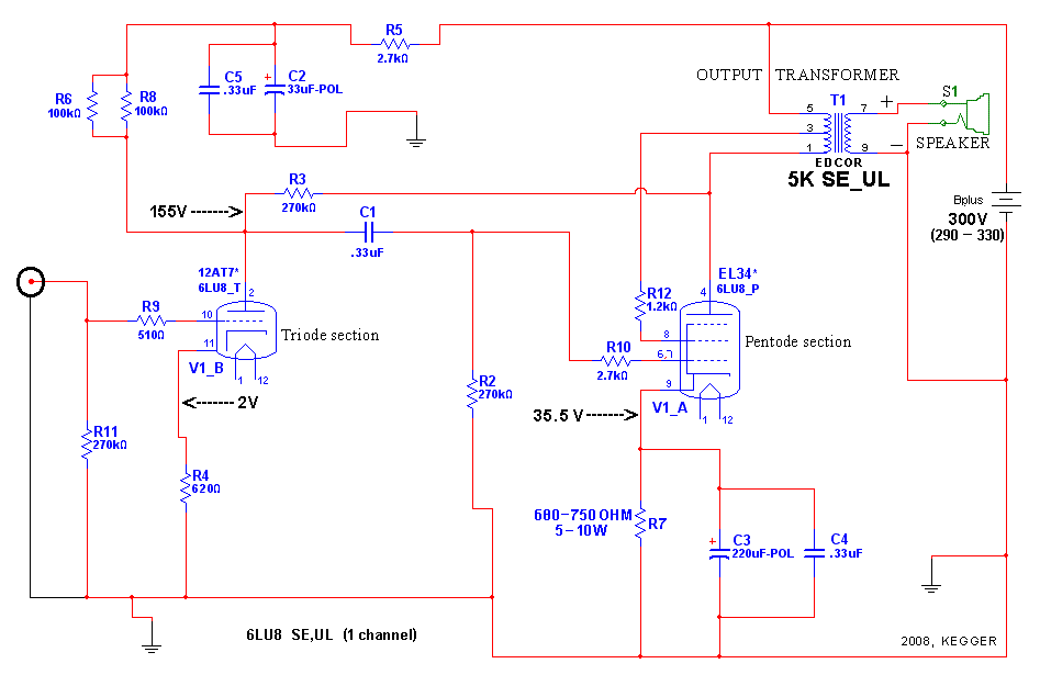

Hi Tom,
I noticed that for this new version you added some partial Schade local feedback via R3 (150Kohm), this is slightly too low based on an existing schematics nearly identical to yours from Kegger. He is using 270Kohm after many hours of listening test. Here is a link to the thread and his latest schematic.
The "$250" Amp? - 6LU8 Compactron SE, UL - AudioKarma.org Home Audio Stereo Discussion Forums
p.s. I have completed a few days ago the Kegger 6LR8 amp and it sounds great.
BR,
Eric
I tried 100k, 150k, 220k, and 330k. I found I get the best performance at 150 kΩ,
Tom copied mine ...post #2
http://www.diyaudio.com/forums/tubelab/210722-spud-what-again.html?highlight=spud+6lr8
And I copied Kegger's
http://www.diyaudio.com/forums/tubes-valves/125963-spud-anyone.html?highlight=spud+6lr8
There are experts on this forum who have told us dozens of times that this type of feedback can not be used with a triode driver. There is theory to back this statement up, but it does work quite well here. I tried several resistors and I also settled on 150K. The value seems to depend on your speakers and music choices more than anything else.
In addition to the Schade feedback, I tried feedback to the cathode of the output stage. That's what I used on my 6LU8 Spud, but I actually find that the amp works better with the Schade feedback.
I really like the sound with the triode coupled 6LR8 tubes. That's a rockin' li'l amp!
And yes, I allowed myself to be inspired by Tubelab, Kegger, and a few other designs on the Internetz. Thanks.
~Tom
