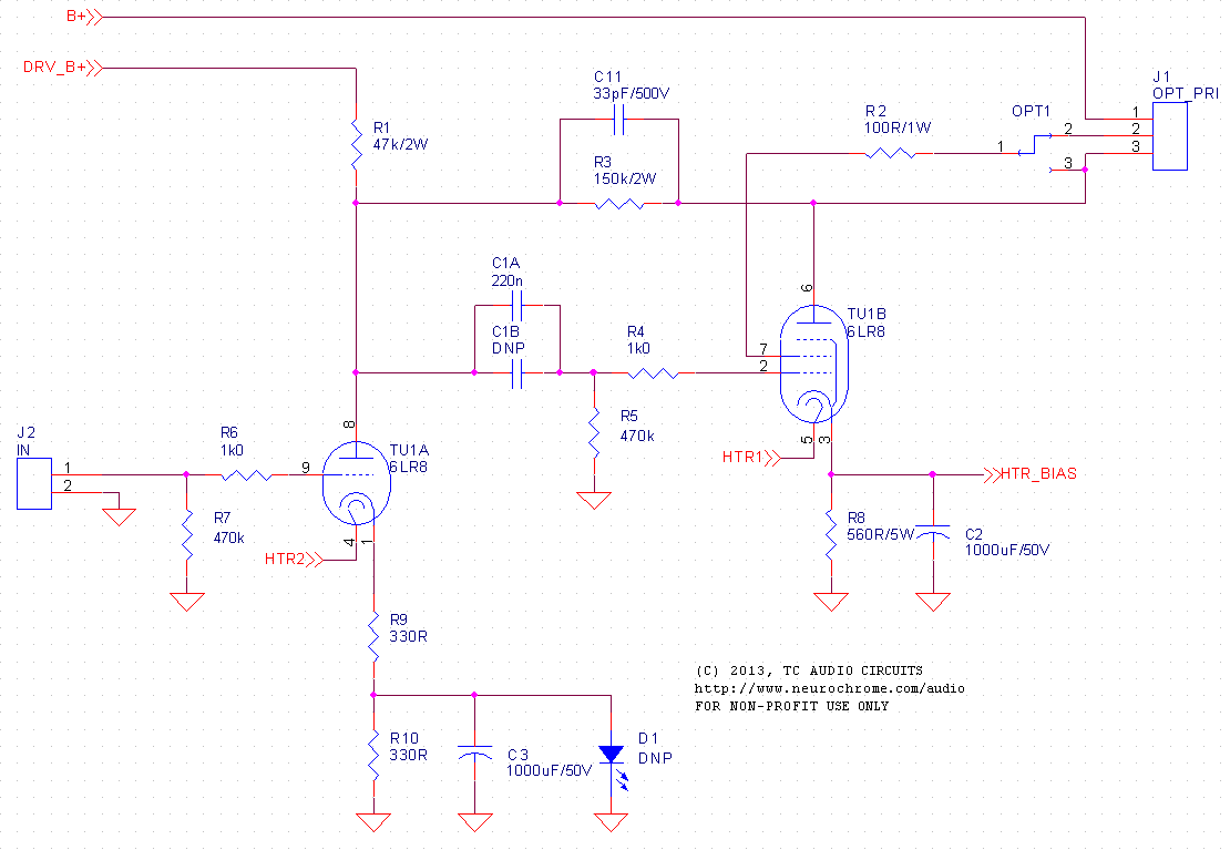

The 6LR8 does make nice music 😉.
That it does! Especially when triode strapped.
To really hear the advantage of Schade feedback; omit C3 and D1 on the driver's cathode.
Hmmm... Hadn't thought of that. I'll give that a whirl.
D1 is actually not populated by default. That's why it says "DNP" = Do Not Populate on the schematic. I included it as an option. I actually get quite good performance with a green LED in that spot. Then you'll need R9 = 0 Ω and R10 = DNP.
~Tom
I thought that this was the proper design.

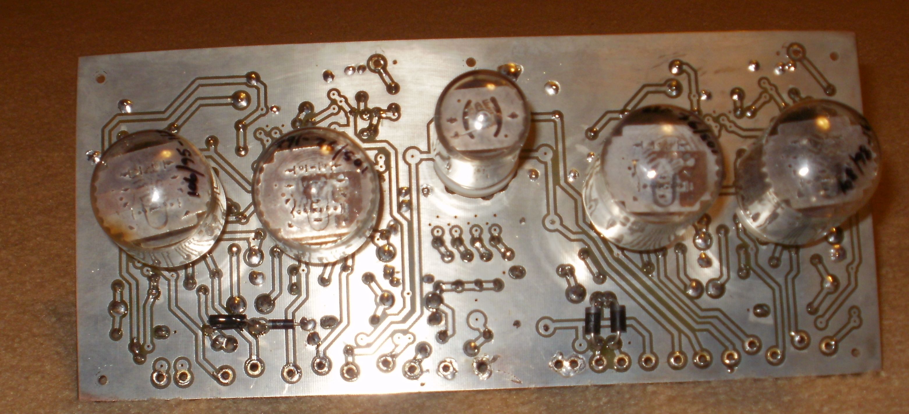

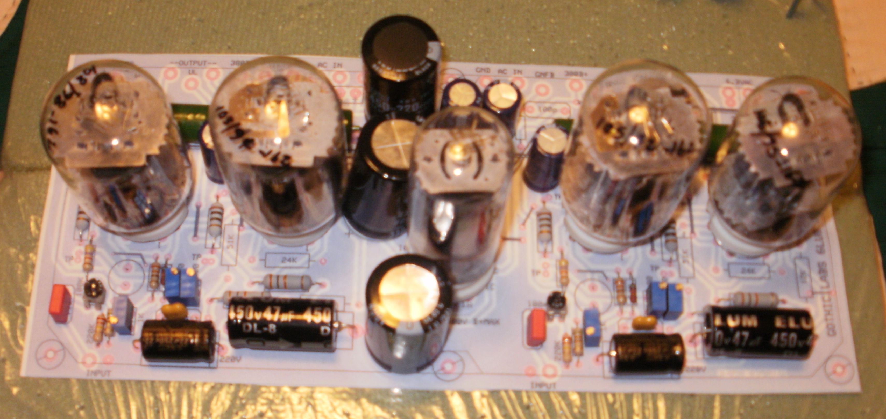

6LU8's makes a killer PP amp..... I did a PCB concept for Triode, UL or Pentode mode, I did Pentode mode for the first one... Great with 6.6K Iron!. I used a 6CG3 diode for slow B+ start in the power supply filter chain.
Tried that. Wouldn't recommend it.
So... I played around with the feedback resistor. I performed a sanity check with values of R3 both above and below 150 kOhm. R3 = 150 kOhm continues to provide the best performance.
I did find that the THD at higher frequencies was quite a bit higher than at midband, so I decided to investigate this further. It turned out that the transient response at the anode of the driver stage was less than stellar as the feedback from the output stage added significant overshoot. It made me wonder if the output stage was actually operating at the edge of stability.
To tame the transient response, I added a small (22~33 pF) cap in parallel with R3. That worked like a charm. This cap does limit the bandwidth of the amp to about 30 kHz (-3 dB), but its transient response is nice and symmetric without tendency to overshoot.
I need to run the circuit through my measurement suite, but I think this is it folks! Ready for prime time!
~Tom
I publish the schematics for all my circuits and nothing prevents you from building your own without using my boards. The PCBs just make it a lot easier.

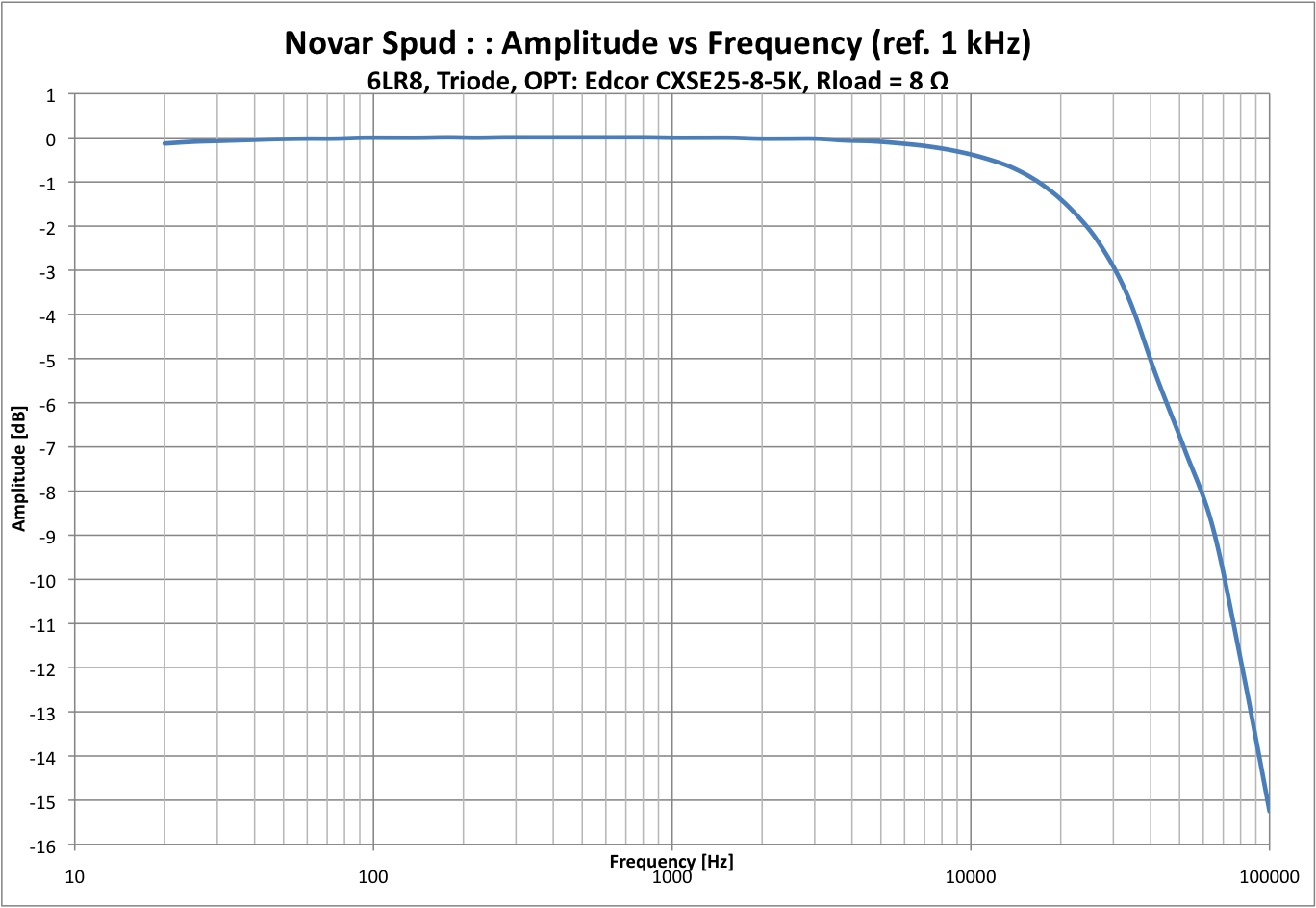

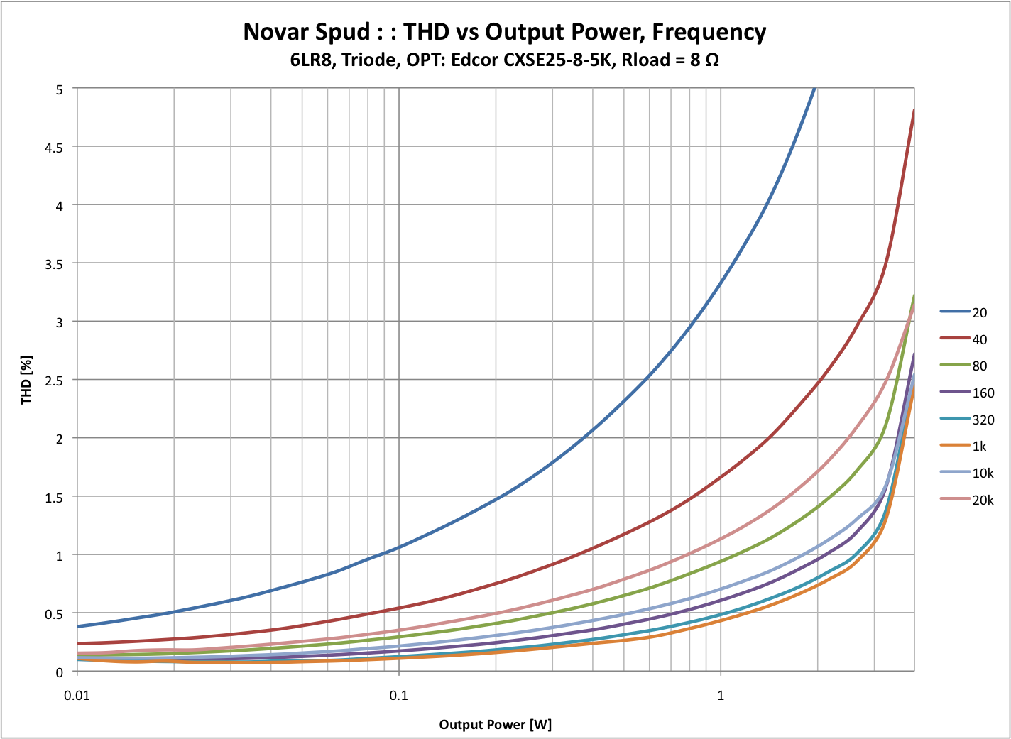

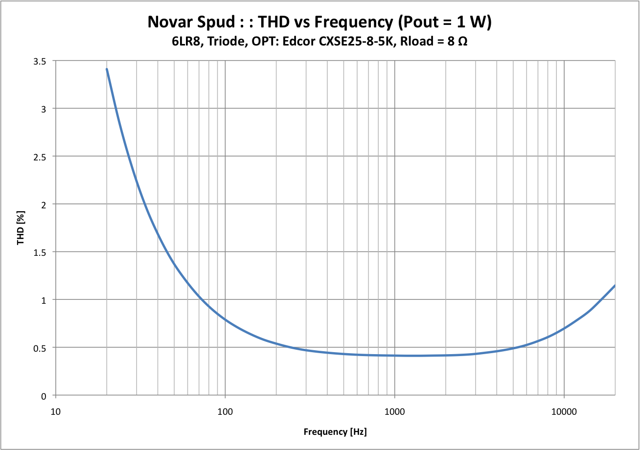

I must say that I really enjoy the sound of the triode strapped 6LR8. It's not quite up there with the 300B, obviously, but neither is the build cost.
I've attached the measurements of amplitude response and THD vs power, frequency for the 6LR8 in triode mode. It's curious that the THD increases a bit at the higher frequencies. This may be an effect of the Schade feedback as I haven't seen it for other feedback types. The higher THD at the low frequencies is due to the output transformer. No surprises here. The Edcor CXSE series is rated for operation down to 50 Hz. I measure to 20 Hz.
~Tom
