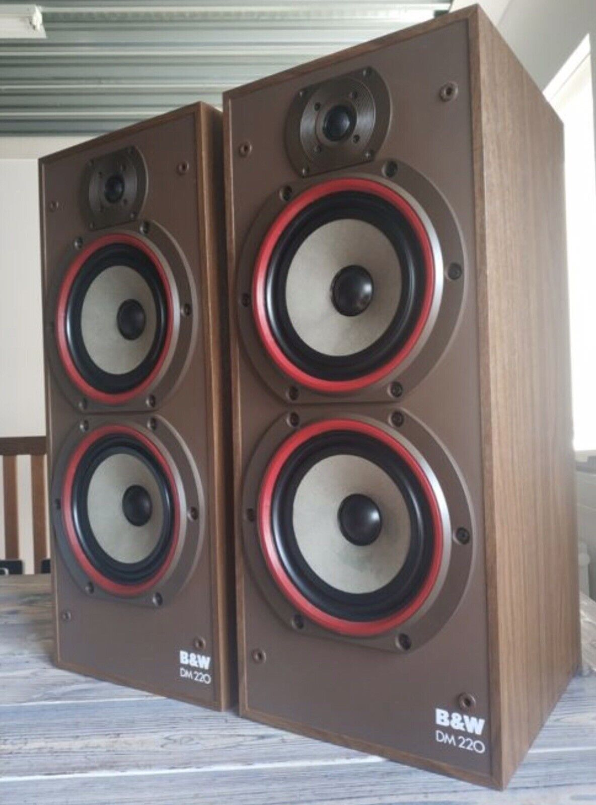

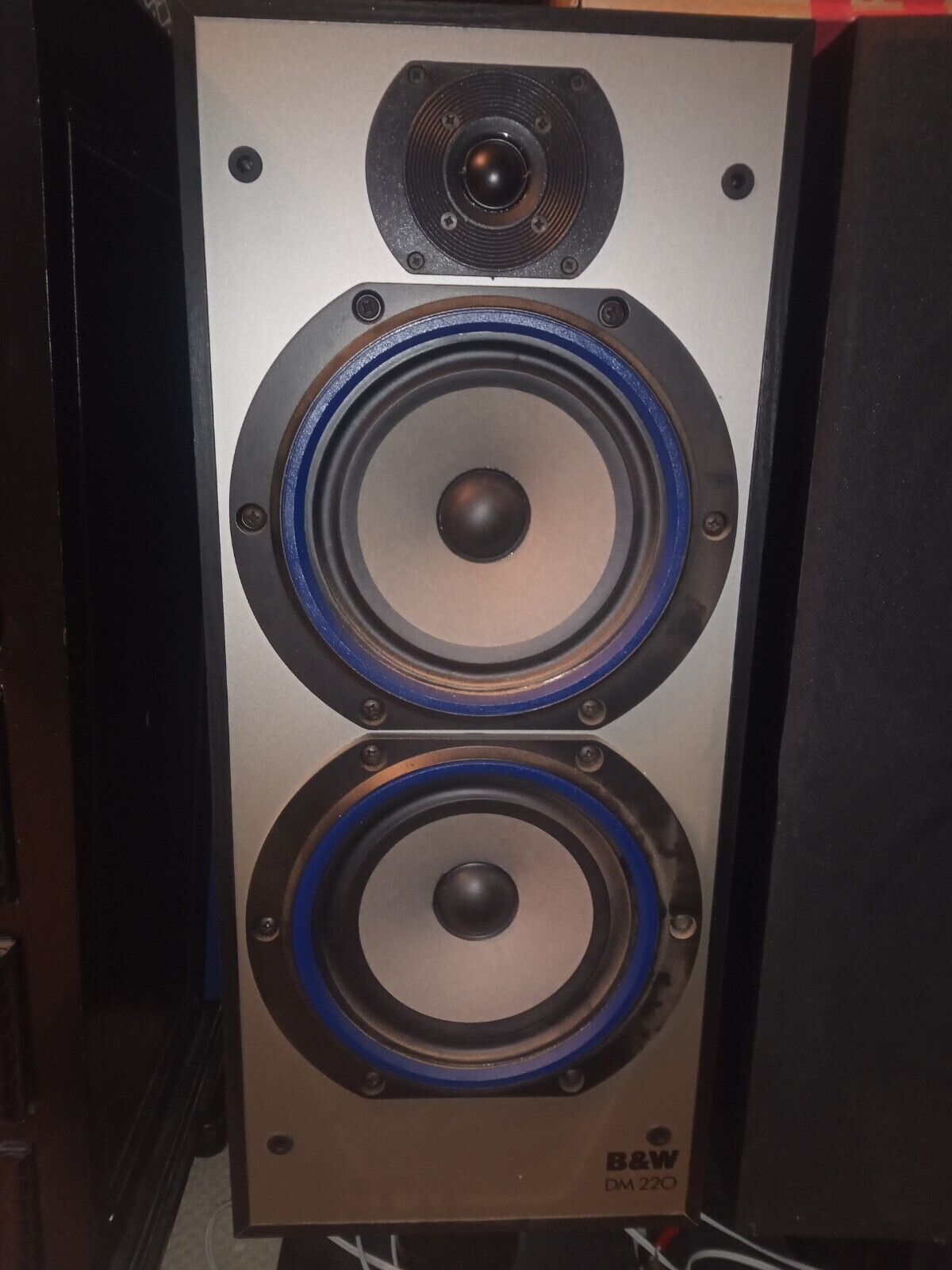

I can tell you a story regarding the B&W DM 220's.Just for interest, I attach a photo of the B&W DM 220 speakers from which your replacement 16 ohm B&W drivers originated.
Both the brown version and the black version!
I have a pair of B&W DM 110's which you helped me reconfigure.
We put effort into upgrading the XO's, but on completion I discovered the tweeters were cactus.
A couple of months later, I noticed a pair of speakers in a pile of hard rubbish placed on the kerb.
I immediately thought, what was the probability of finding a pair of B&W DM 220's.
The boxes weren't in good condition, but the 4 woofers & 2 tweeters turned out to be fully functional and cosmetically in good condition.
The tweeters were harvested to save the DM110's, a pair of the Woofers were shipped to Sydney to save another pair of speakers there, and now, the last pair of woofers have been used to save the Rotels.
I love salvaging and repurposing, and saving.
Much effort, energy & expense went into manufacturing these things, and in many respects, can match or even better some of the rubbish being sold on the market today.
Naturally enthusiasts, such as yourself and other forum members, provide the necessary knowledge and expertise to make such things happen. 🙂
