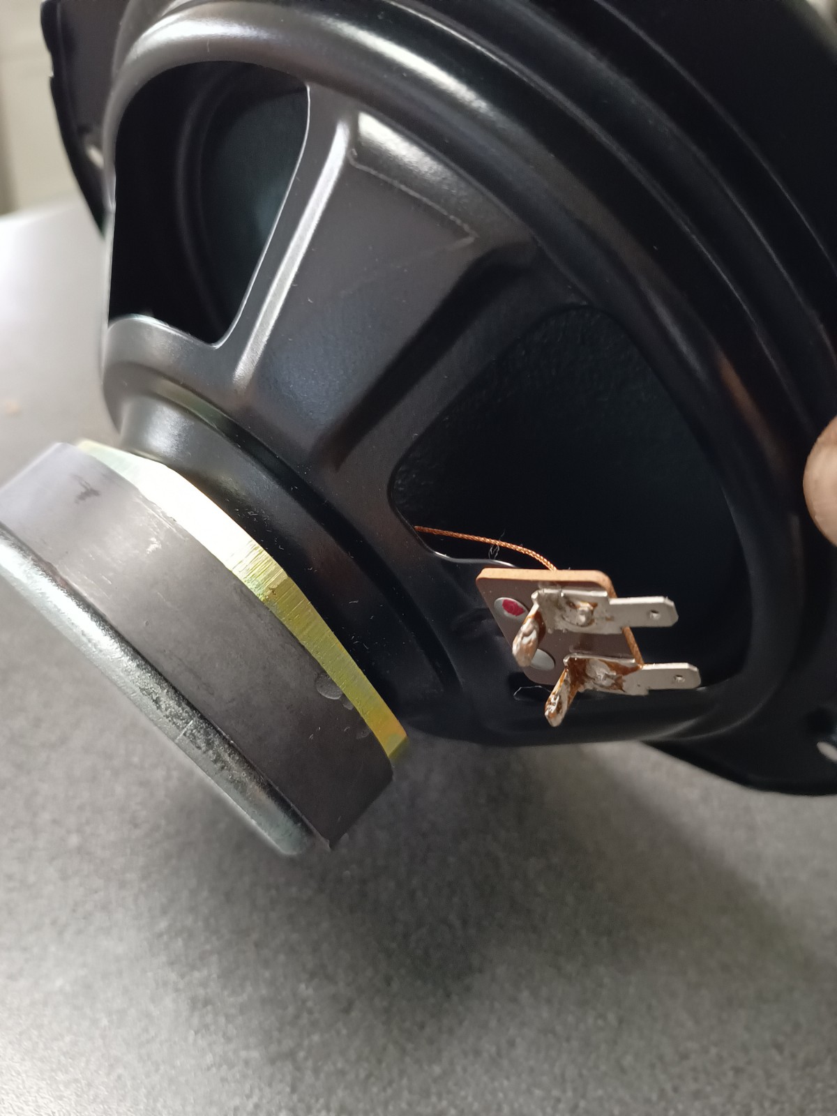

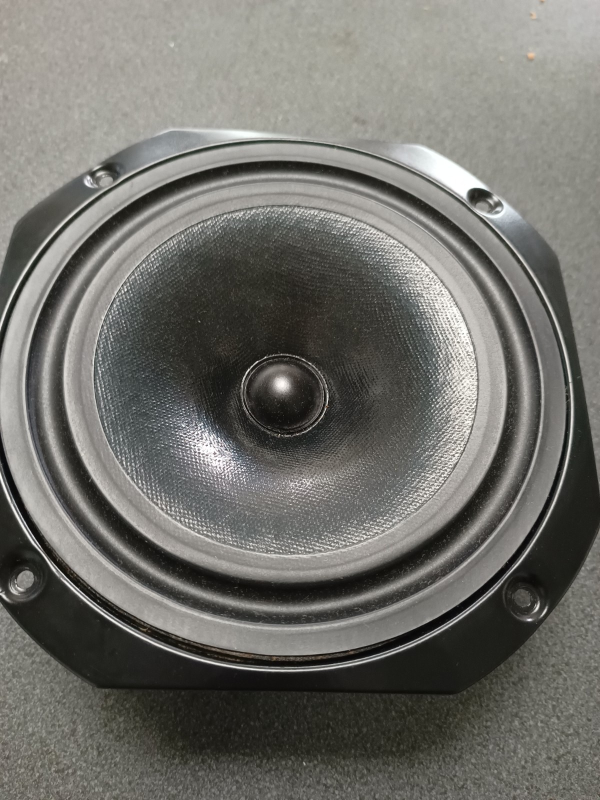

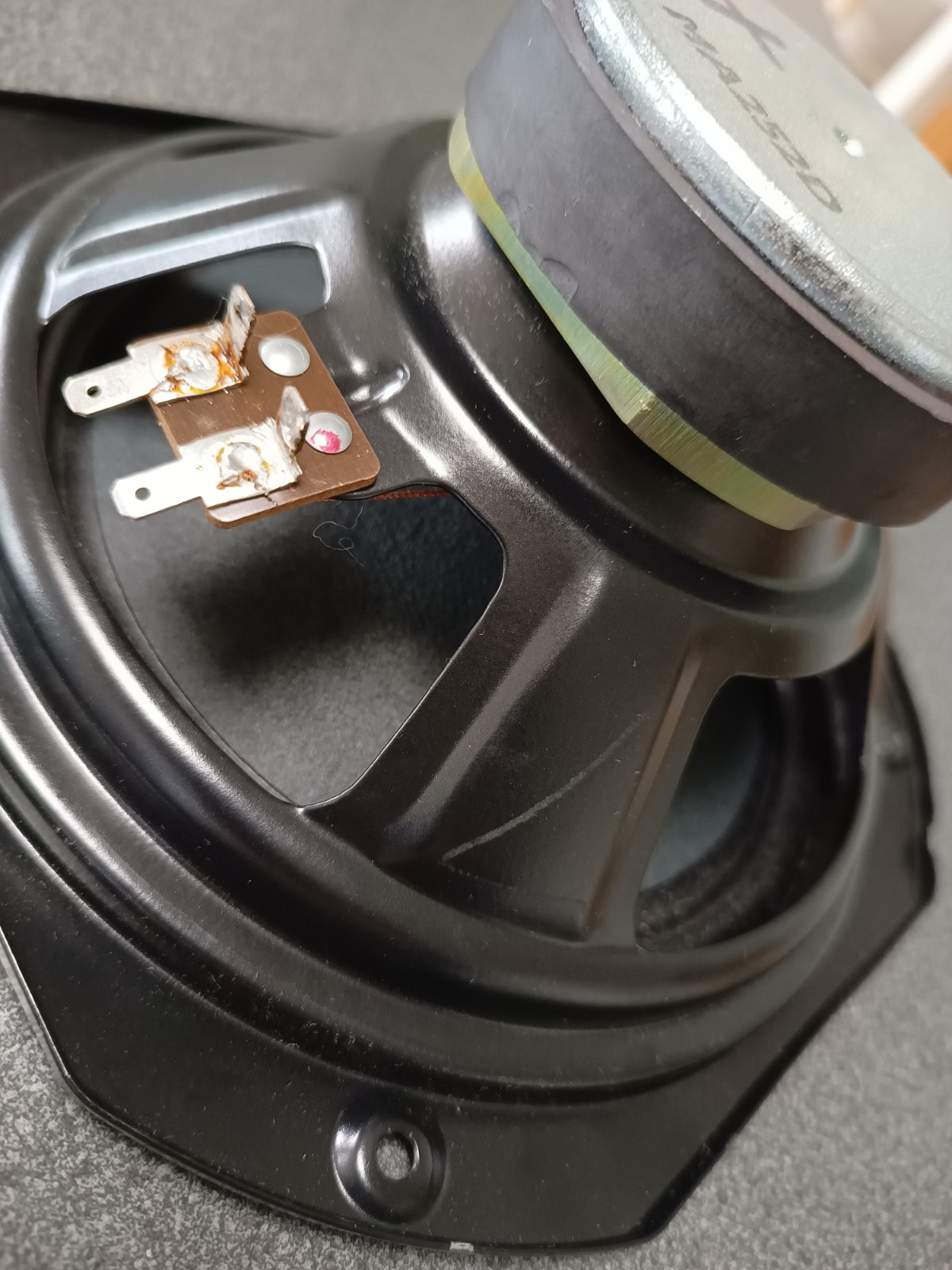

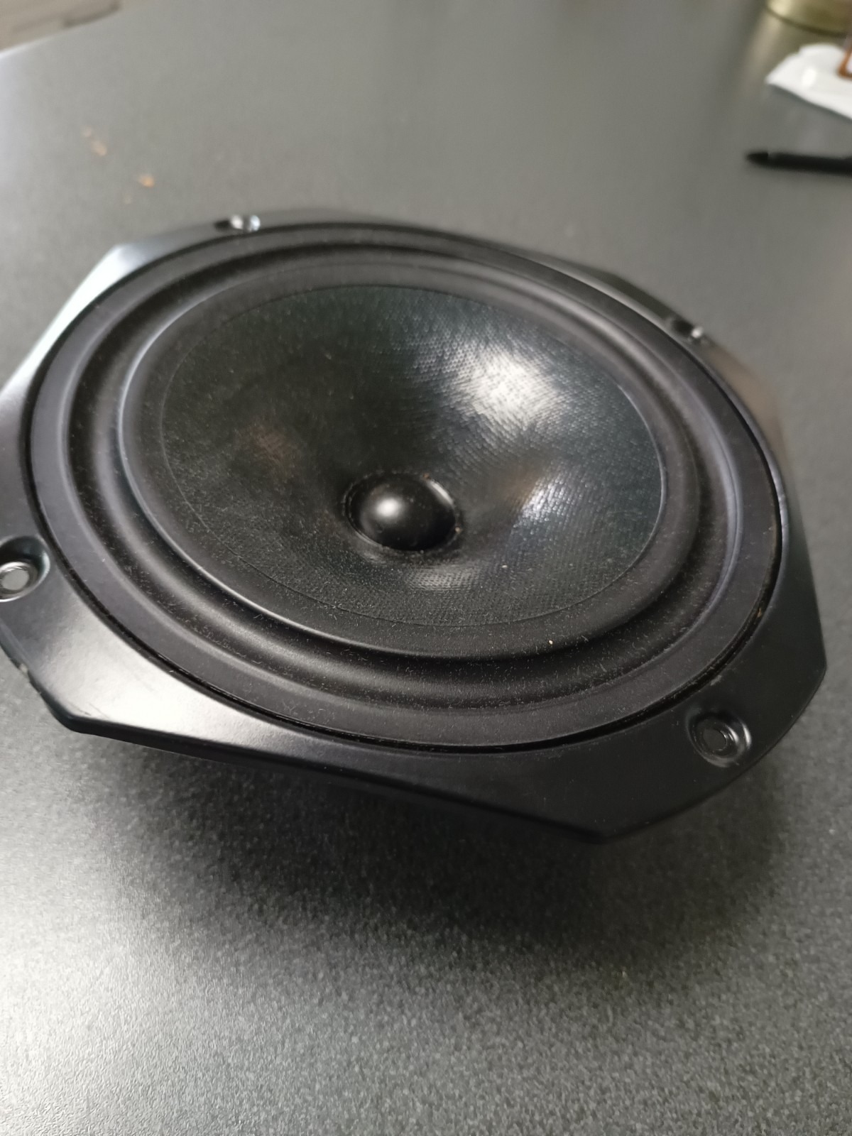

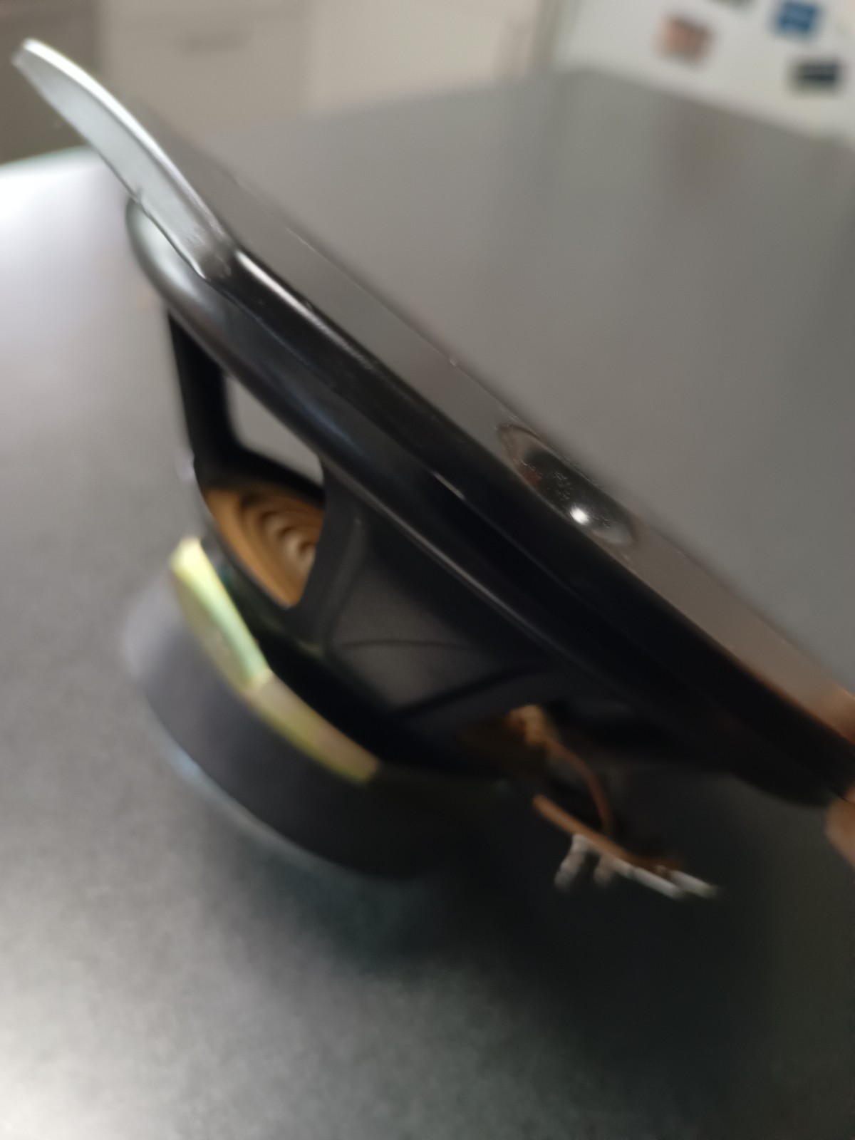

The woofer in those speakers look remarkably like the Peerless I just got at a garage sale.
I'be been unable to find any factory information about them but listening they are OK
Apart from the "MA252D" printed on the back of the driver, there are no identification markings.
Looks well built though.

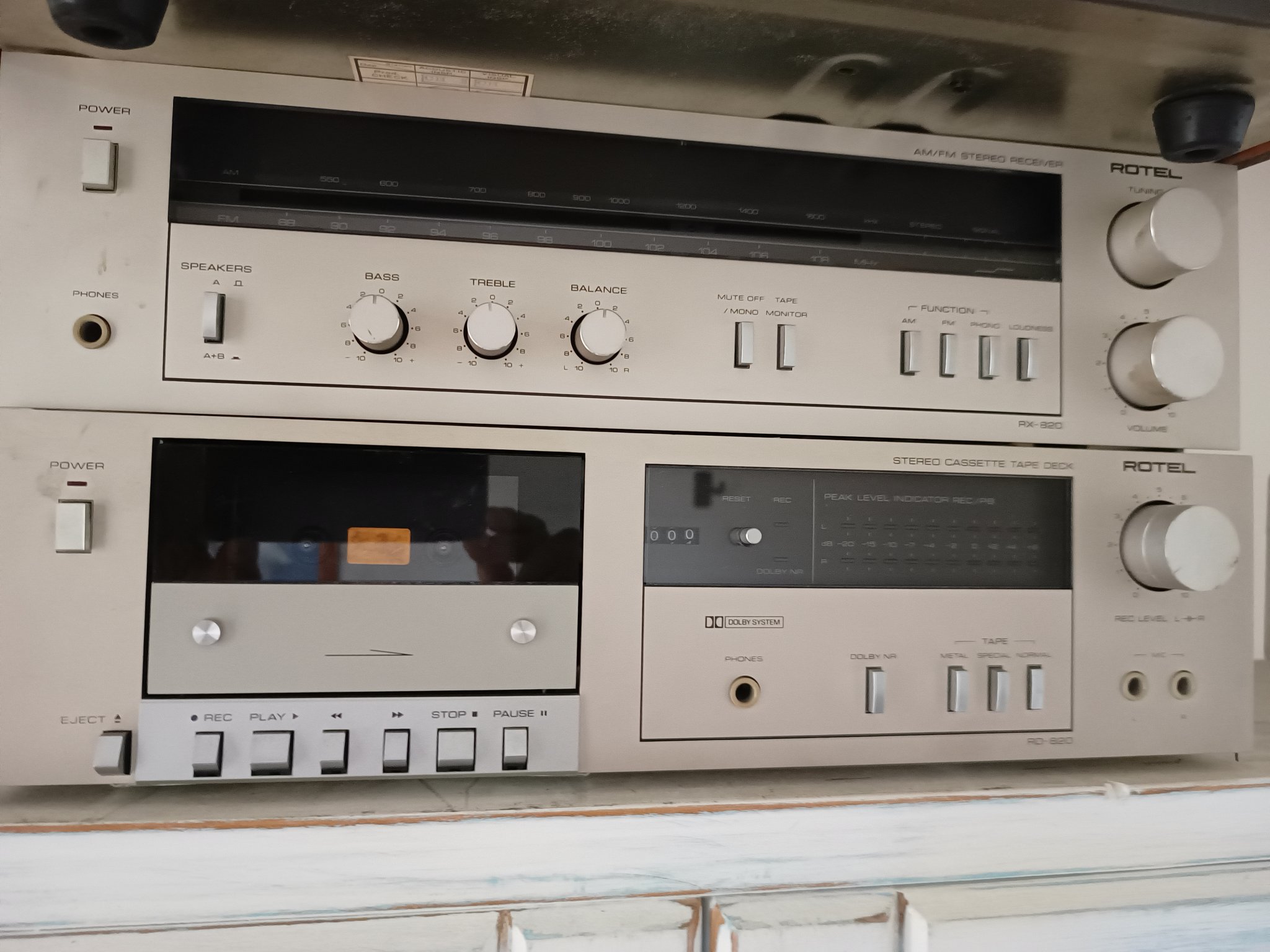

Alex Encel used to sell the Rotel RL 870's along with Rotel Amps & CD Players.
I also have the Receiver Rotel RX 820, & Cassette Player Rotel RD 820which was sold with these speakers.
Both also need work.

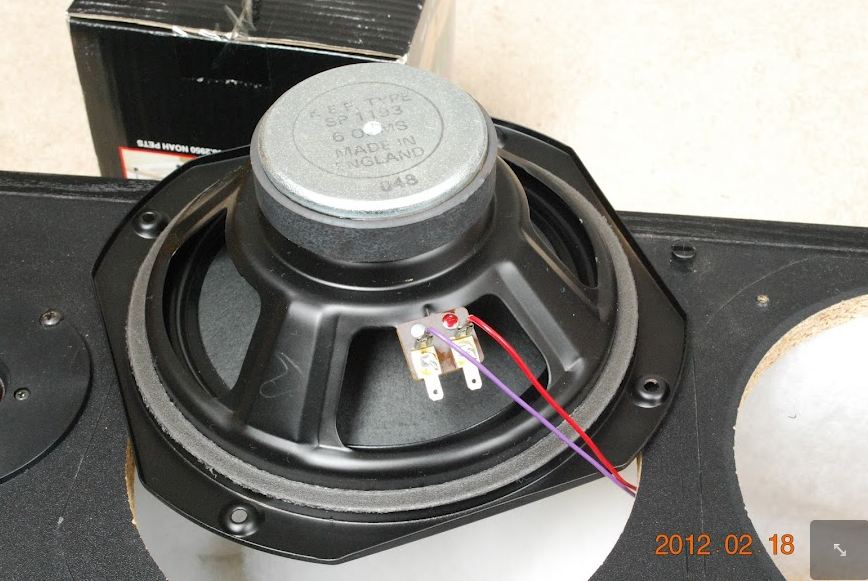

The 'MA' likely stands for 'Monitor Audio'.
As I said earlier, my sources say that the Rotel bass/mid drivers were made in England by Elac.
Elac supplied mid/bass drivers to Monitor Audio as well as to KEF (see attachment).

A contemporary of the Rotel RL850, the KEF Coda III, has a similar looking mid/bass driver which was said to have been made for KEF by Matsushita!
It's quite possible that baskets and magnet assemblies were made by a common supplier and that companies like Elac and Matsushita added the additional components to their own specifications.
