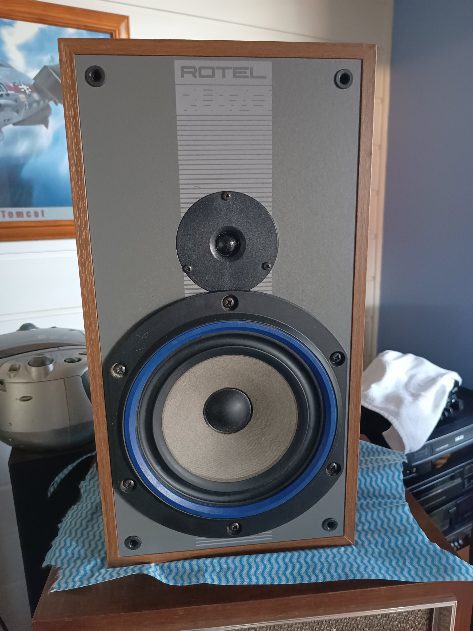

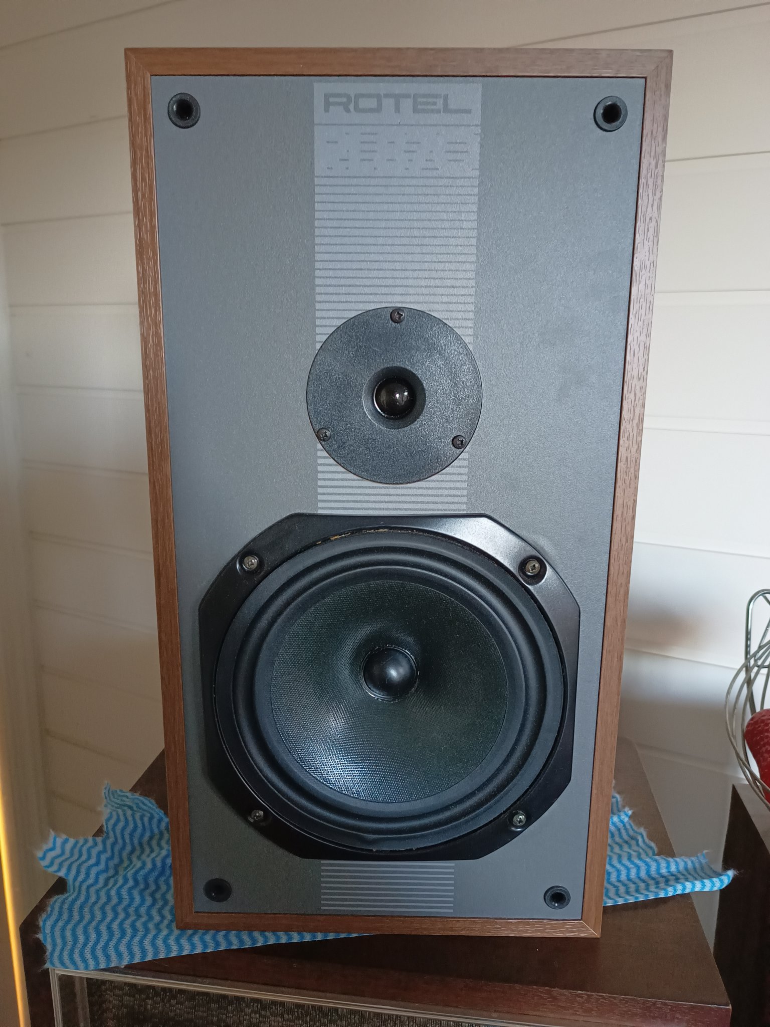

Progress report.
I've restored the Rotel RL870 crossover back to standard.
The parts I cut away for testing have been re soldered for the purpose of a driver comparison test.
The router wasn't suitable, but my jigsaw worked well.
After masking the baffle to protect it, I cut the woofer hole diameter on one of the boxes by approx 4mm to accommodate the B&W Woofer.
Being larger, the new woofers surround covers part of the Tweeters surround (ala Andrew Jones Elac).
I lightly chiselled the rebate to make the Tweeter flush with the baffle.
Finally I re stuffed the box with the original wadding (sealed box) and reassembled everything.
Now ready for a test.

Well done!
It certainly looks the part. Fingers crossed on how it sounds.

There's slight water damage on the B&W paper cones.
They also appear to clash with the overall tones of the Rotels.
I thought painting them with a thin coating of Mod Podge should mask the water mark and tone down the color mis match.
I read on another thread that an application of Mod Podge changed the T/S parameters of a member's driver.
A less radical suggestion would be to mask off the cone and spray it lightly with matt black paint from an aerosol can.

The amp I was using doesn't have balance, so it was the ear up against each speaker.
I asked my son (younger ears) to evaluate.
He said "original" was louder, but B&W upgrade was clearer and gave the impression it could handle more power.
