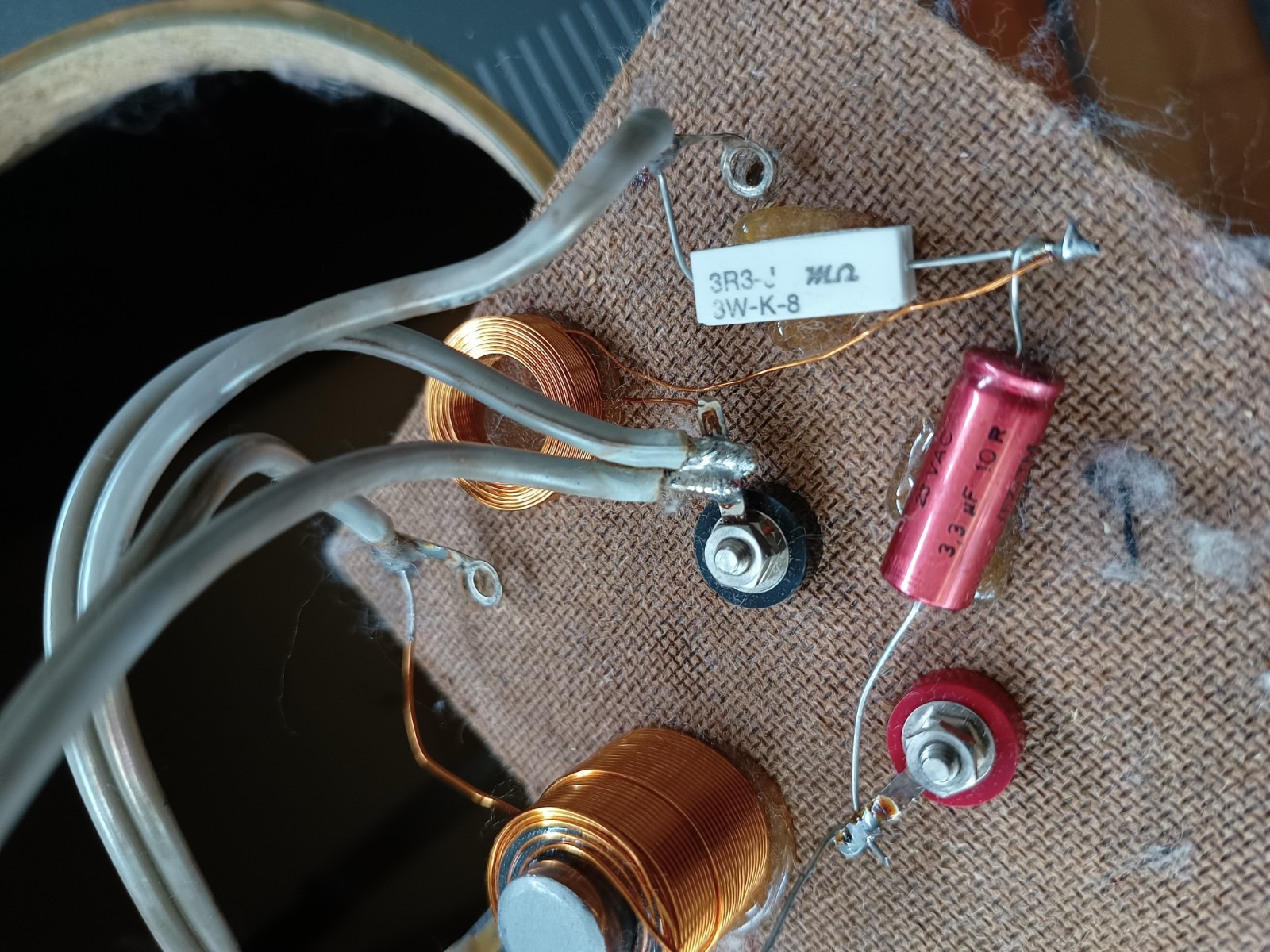

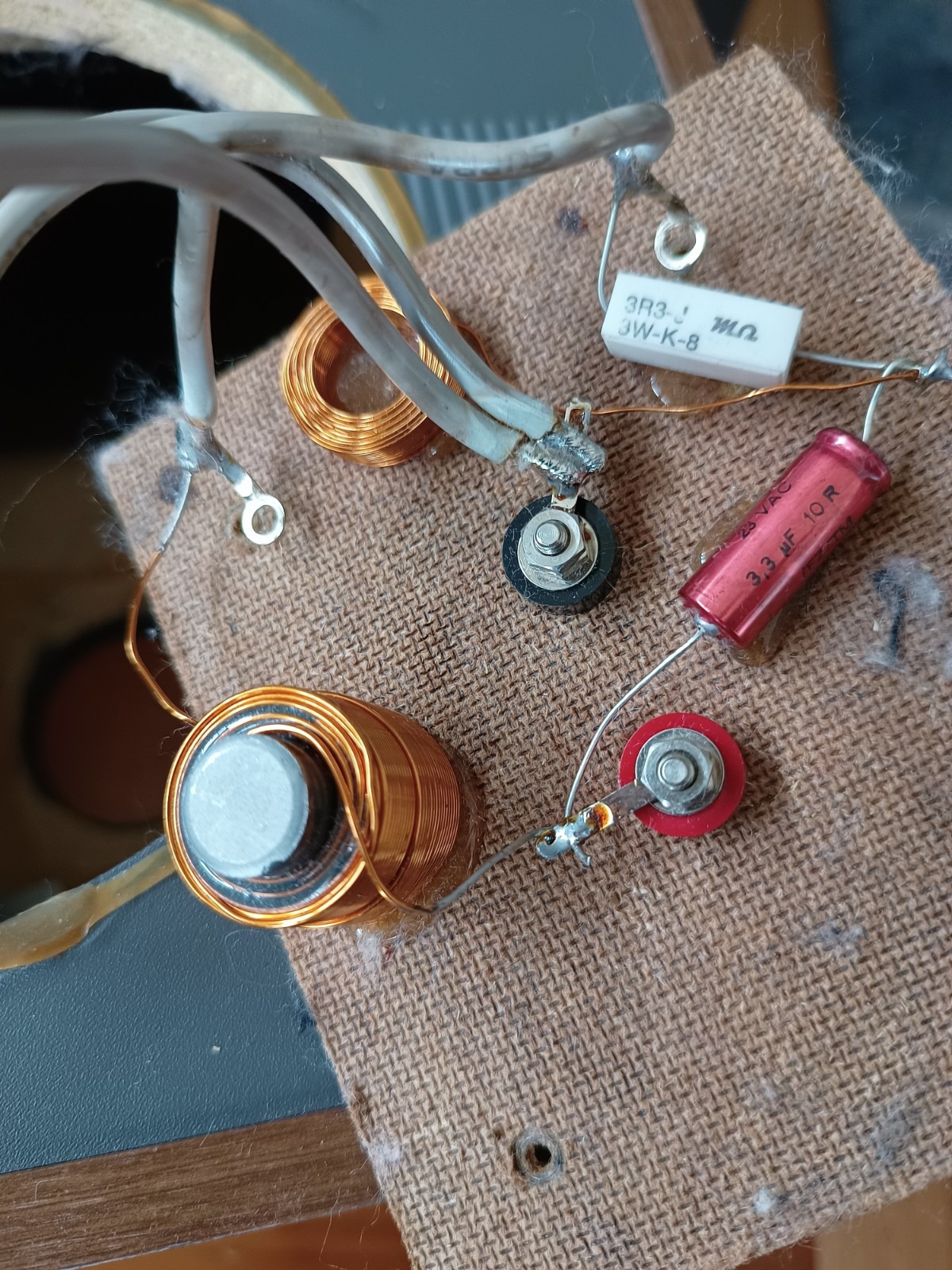

Photos attached are one of the existing XO's belonging to the RL870's.

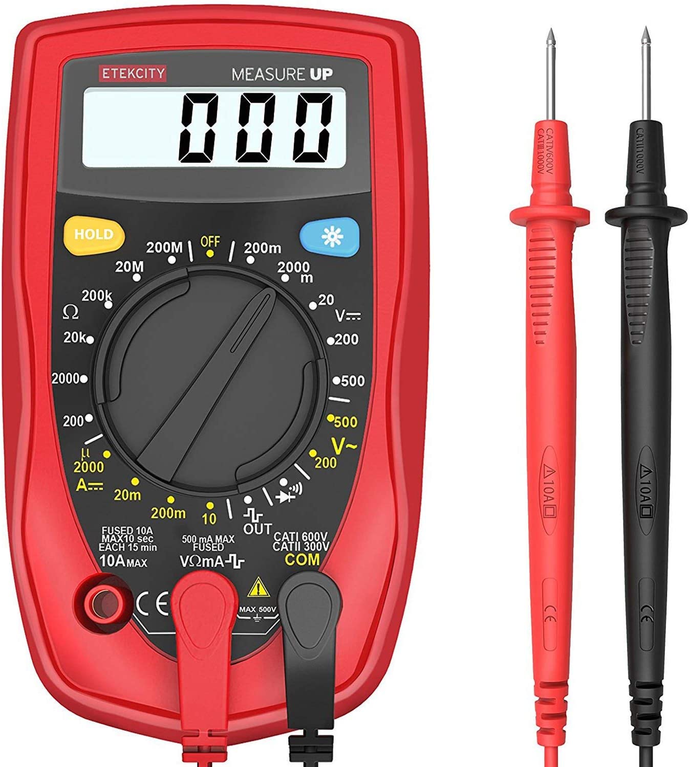

I set the Meter to 200 in the Ω section for the test.
Maybe it's where I connect the terminals.
Choice includes: COM, & 1000VDC 200mA MAX, & 10A DC
Where should I connect the terminals on the Meter?

My hunch is that Cliff isn't using his multimeter properly.
Cliff, perhaps you should show us a picture of your multimeter.
Usually, an Ω symbol is found on the same multimeter socket as the V and mA symbols. Plug the red test lead into that socket and the black one into COM.
Then the 200 Ω scale has to be selected with the rotary control.

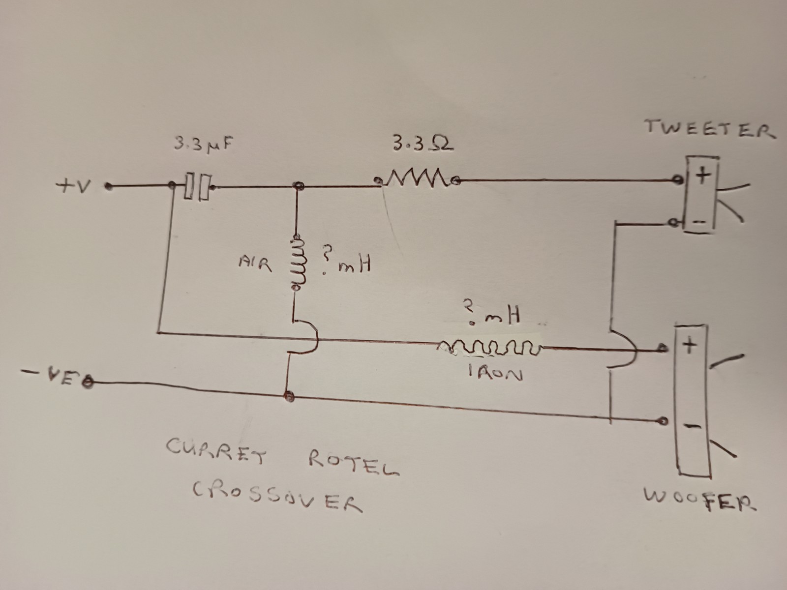

Now we're cooking! Add one third of 12 onto 12 and we have the nominal impedance of 16 Ω.
These B&W drivers could be suitable as replacements in your 20 litre sealed Rotel enclosures.
The problem is adapting the crossover.
If you're keen to experiment, you could start by replacing the current iron-cored inductor with one of twice the value.
I'll have to remove it from the XO and place a meter on it.
Here's the current schematic.
Should I interfere with the cap/resistor?
The current 3.3µF Cap reads 4µF & ESR 0.85Ω

I would replace the electrolytic capacitor, but not the resistor.
P.S. It would do no harm to any of the components to try out the replacement mid/bass driver with the existing crossover before going to the expense of buying a new iron-cored inductor of twice the inductance.
Who knows, you might like the resulting sound balance with the current inductor.
P.S. To get accurate measurements you must lift one leg of the inductor or other component in order to effectively remove it from the circuit.
EDIT: I see you said you would remove the inductor to measure it, so that's OK.
