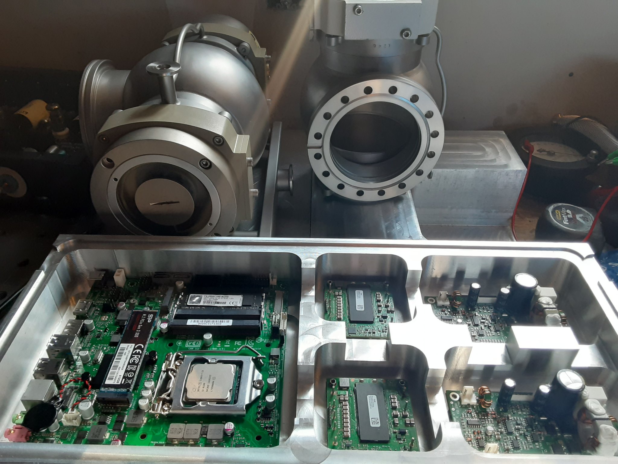

Relating to the Huber+Suhner modules in the above video, it dawned on me to show this project. It's a mini-ITX quad core with icepower modules and multiple DC/DC converters. I was inspired by the newer Jeff Rowland monolith slab style amps. Now getting into RF stuff I can see where Mr. Rowland got his inspiration from. Even better for me because I know how to make RF tight enclosures entirely by accident...thanks Jeff lol!

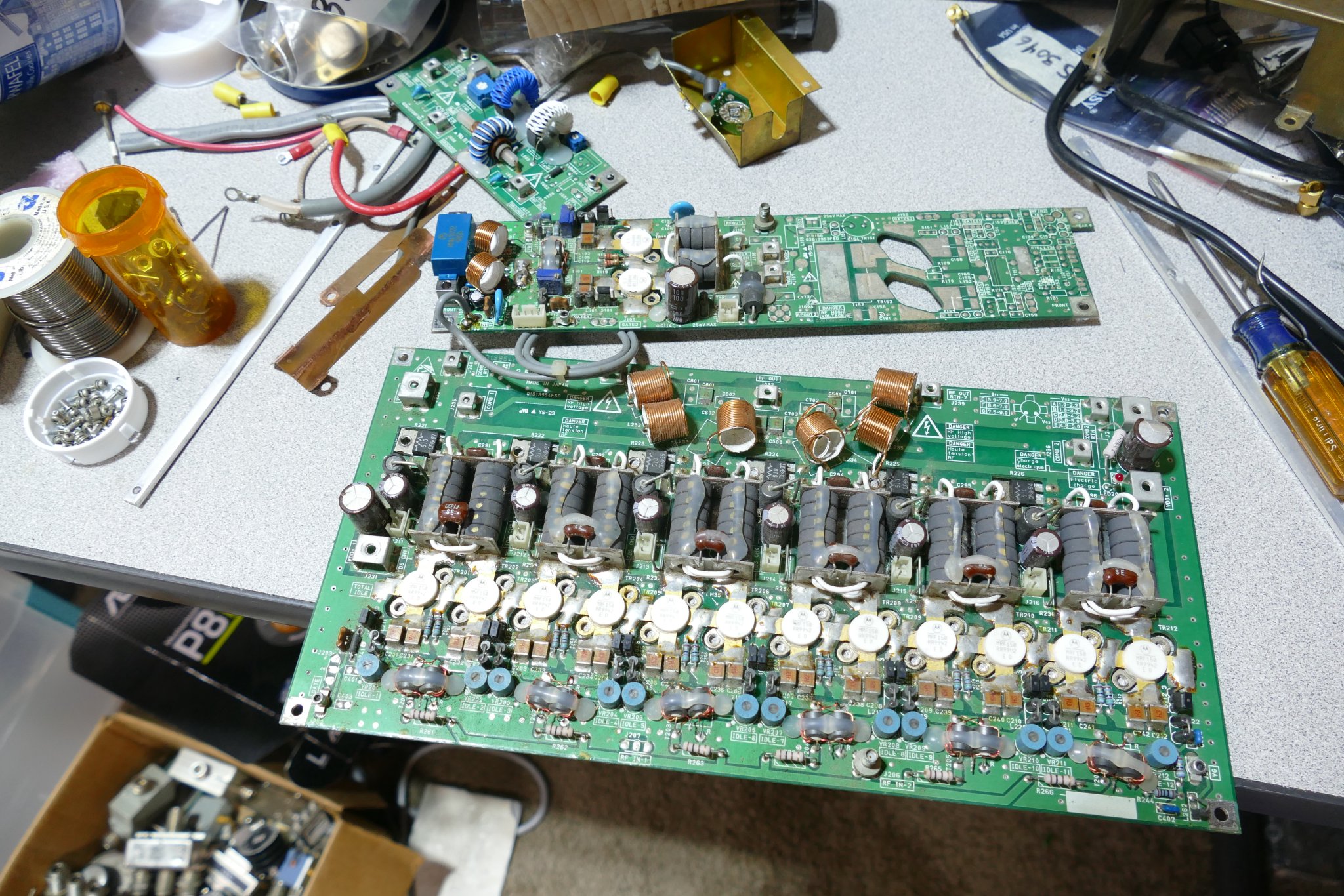

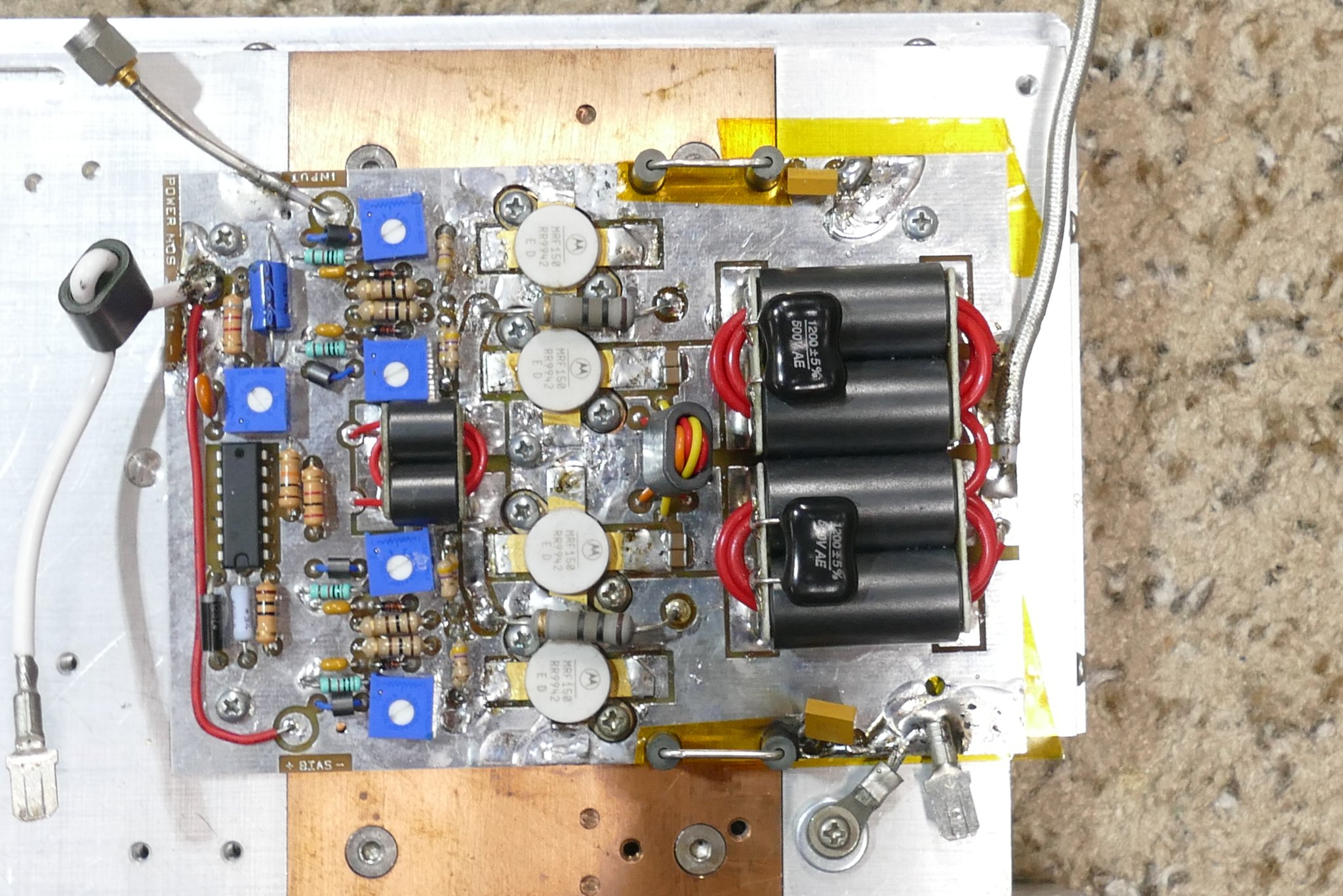

This thread sprang to life about 6 years ago. Back in post #7 I talked about designing my own ham radio. A couple months ago a friend in Florida asked me if I could help him make a power amp for his new Hermes Lite 2 SDR which put out about 5 watts. I have a Yeasu FT817 which puts out 5 watts, so I went for it.
I remembered buying a bunch of scrap MRI amplifier boards from 1999 and 2000 at the Dayton Hamfest back in 2011 mostly for the heat sinks. I had stuffed the remains into a box which has been in an abandoned modular home ever since. I found the box which yielded a collection of large RF transistors. One board had 14 MRF150 transistors on it. A little Googling said that I had hit the jackpot. There was a Motorola paper detailing the design of an amplifier that could get 600 watts from four of these devices in PPP from 5 watts of RF drive and cover 1.8 to 30 MHz. What was even more surprising was that the company that was mentioned as a source of parts in this 30 year old App Note was stillaround and still had the PCB and parts for it. I got the board and parts, less the MRF150 transistors for about $75 shipped. Does it work?

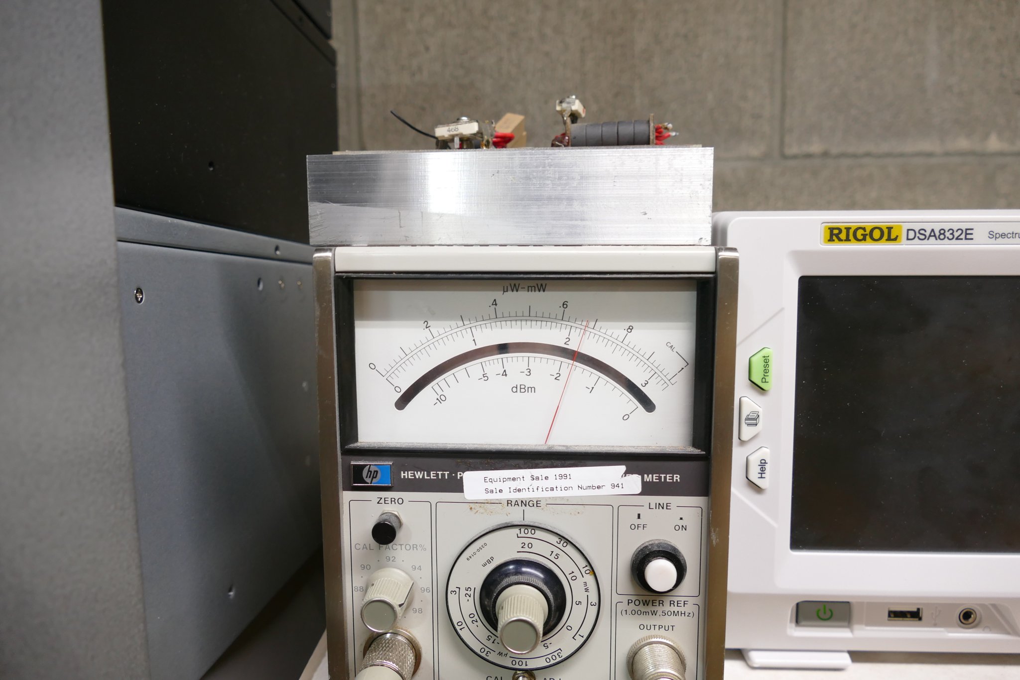

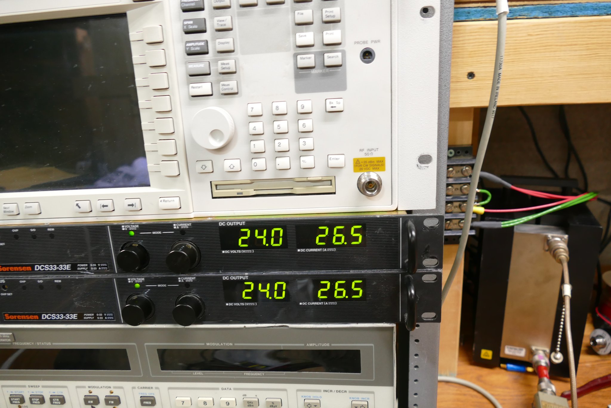

Here is a picture of my new creation. Note the 1999 date codes on the transistors. Note the power meter needle pointing to .675 on the 100 mW scale. There is a 40 dB attenuator in front of the power meter sensor so this is now a zero to 1000 watt scale, corresponding to 675 watts. I have a pair of Sorrensen power supplies wired in series to run this beast. I had to run a new dedicated line to the breaker box to feed them. Each supply is set for 24 volts, so this amp eats 26.5 amps on 48 volts or 1272 watts for an efficiency of 53% and this is near saturation. The efficiency is lower if I keep the amplifier in the 500 to 550 watt range for linearity. I'm currently looking into some newer LDMOS parts that get efficiencies in the high 70's.
I am using a two stage a broadband amp from QRP labs to drive this thing. It will turn the HP sig gen output into 10 watts.

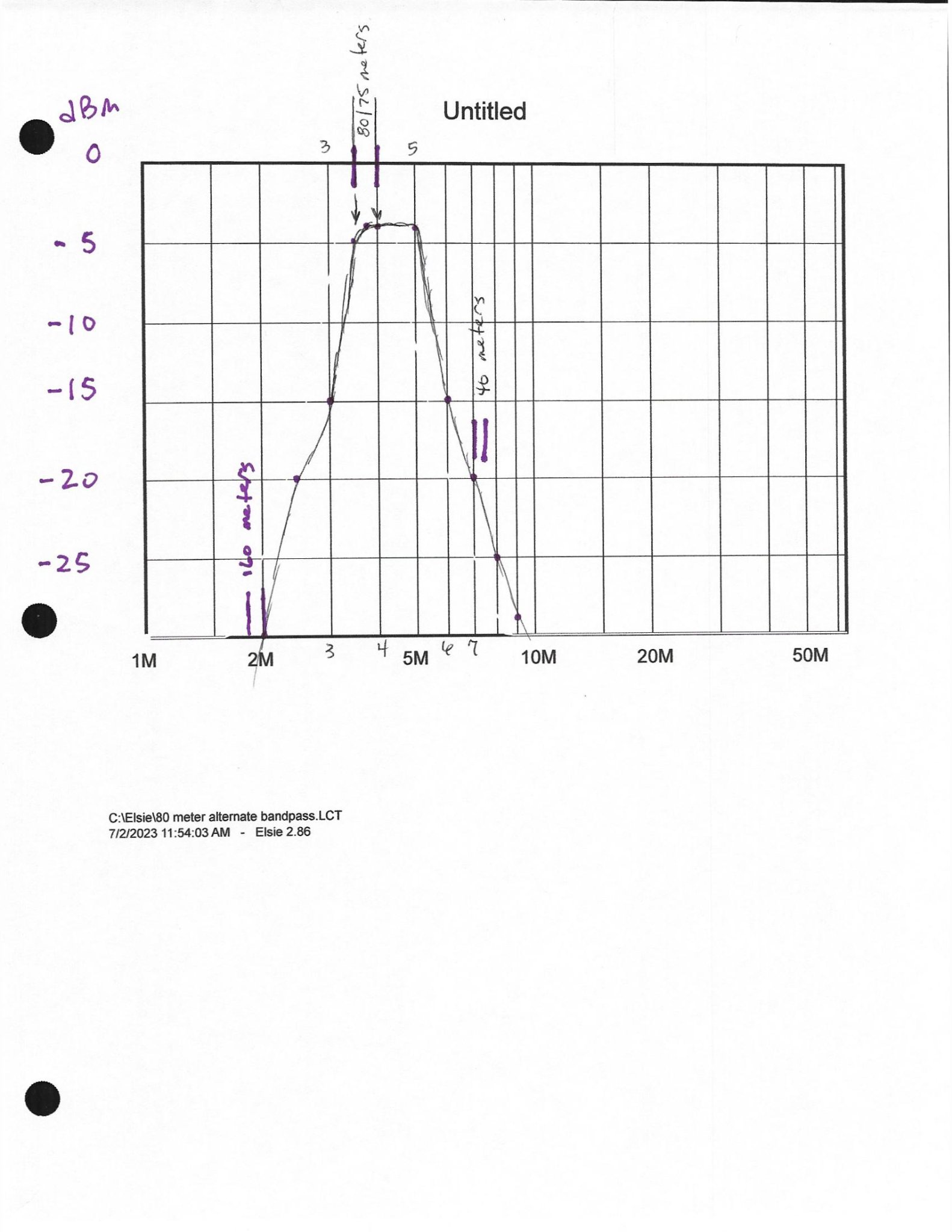

I was working on an all band communications receiver, using an extra QRP Labs VFO to seamlessly switch the prototype bandpass filters as the VFO tunes, and it worked well as the VFO firmware allows the switch points to be user programmed. The only thing remarkable is that I learned the band select lines on the VFO provide a low output rather than a high when engaged, so I had to add some transistor switches to the board to route 5 volts to the selected filter. This part of the VFO does not seem to be documented for use with non QRP Labs filter boards.
Then I carelessly hooked the VFO unit up to 12 VDC and smoked it.

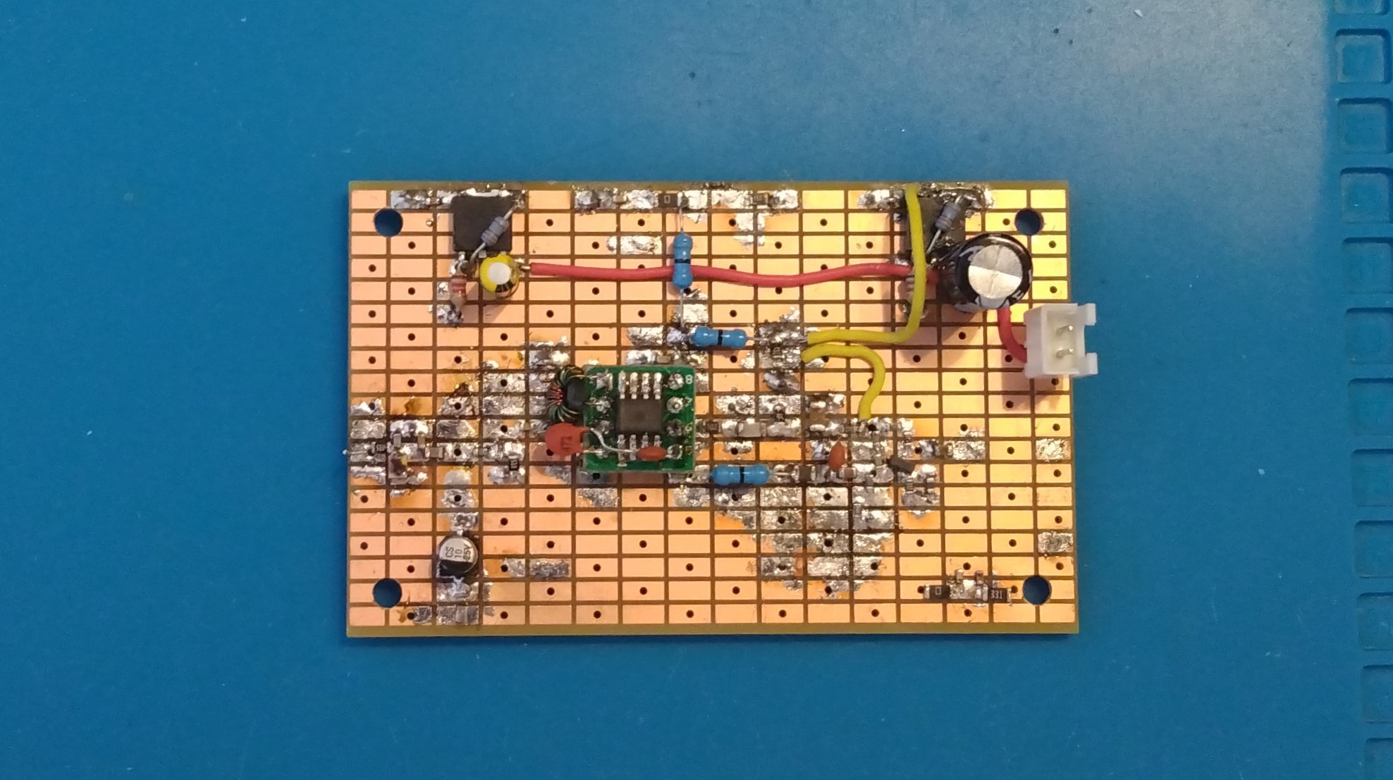

So right now I am ( maybe) working on a simple DC receiver to listen to the local SSB nets. It will be at least 75 meters, and probably 40, although there is only a bandpass filter for 75 on the board right now. I thought I would use a 3 pin header and jumper to switch between two filters to the input.
The detector is a SA602. This board shows the scars of a fair amount of trial and error. Besides the single filter and detector, there is a simple audio amp and a couple of voltage regulators on the board. At one point I was taking balanced audio from the SA602 but I found I could not tell any difference between balanced and single ended, so I stripped all the balanced stuff out.
Progress is glacial. I'm not sure what I am going to use for an LO if this ever makes it to completion. Right now I am using the FeelTech FY6600 function generator.

Oh crap! I'm so sorry!Then I carelessly hooked the VFO unit up to 12 VDC and smoked it.
How is the LO tuned?

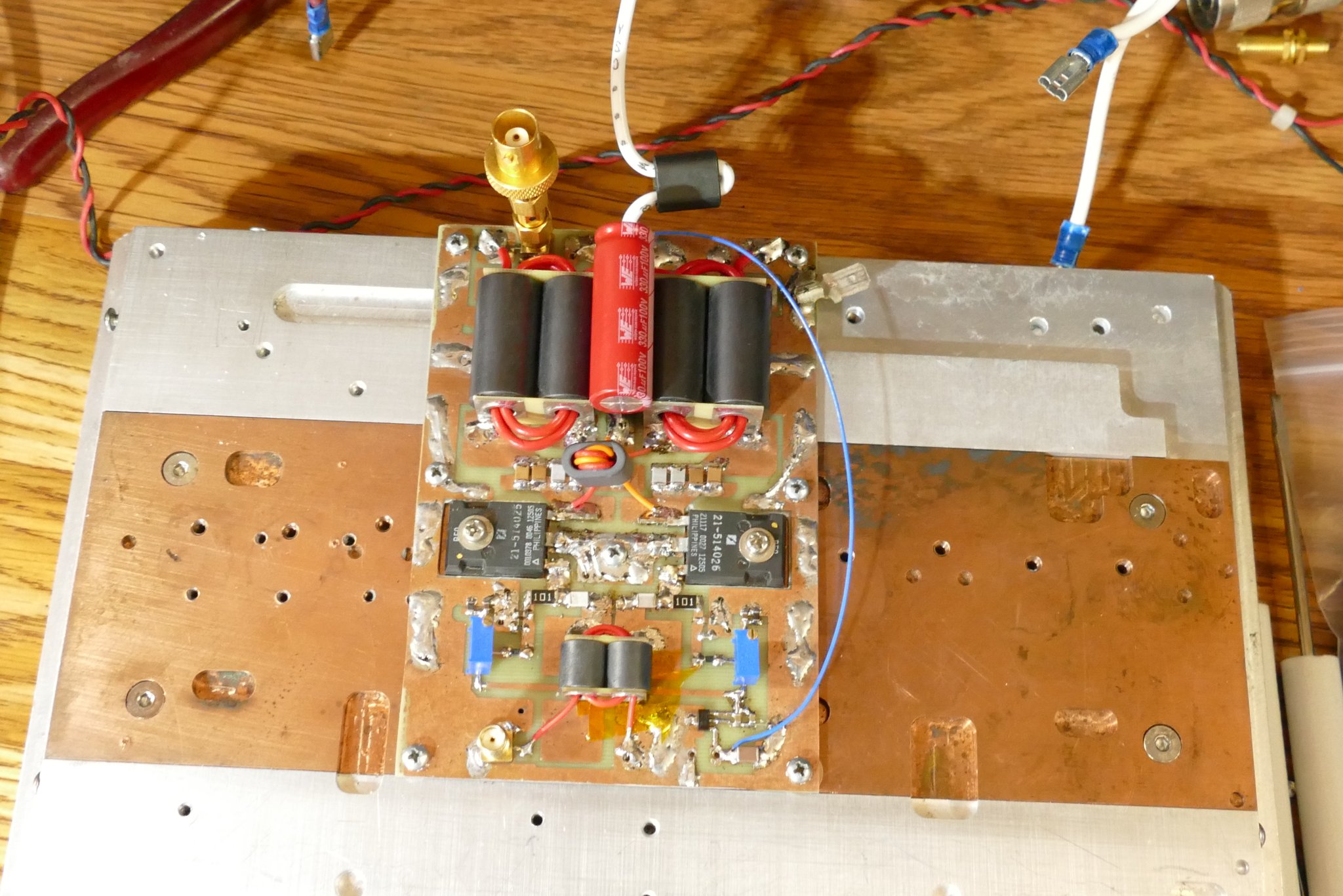

Before the heat sink from the 600+ watt test run was cool I dreamed up an idea for my own version of that 600 watt amp with some of those newer LDMOS parts. I threw together a simple PCB layout and knocked out a quick and (very) dirty prototype board, ordered some parts and built one. The first test ended when I discovered that the board has a case of SPS (smoking parts syndrome) but at least it didn't just blow up. The power output was only 150 watts, so something is not right. Most of the parts values that I put on the board were just SWAGs that were based on the MRF150 board. MRF150's are not LDMOS so their impedances are likely quite different than what's in the board now, which are some unknown "disposable" pulls with house numbers on them from an MRI amp. They didn't explode, so I can put in the correct LDMOS fets. Note that I'm using two 0 to 33 volt bench supplies wired in series with a total current capability of 33 amps. Parts DO EXPLODE when things go wrong. I will be away from my lab for one to two weeks, so no further work will get done for a while.
