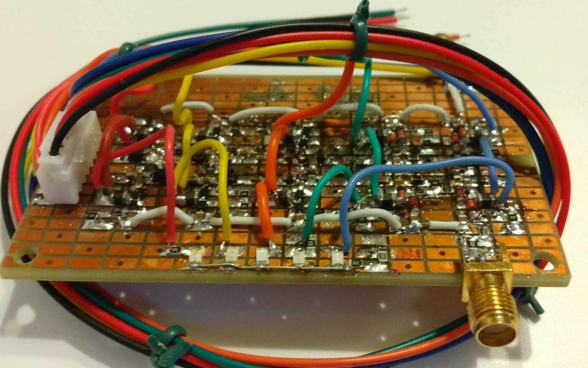

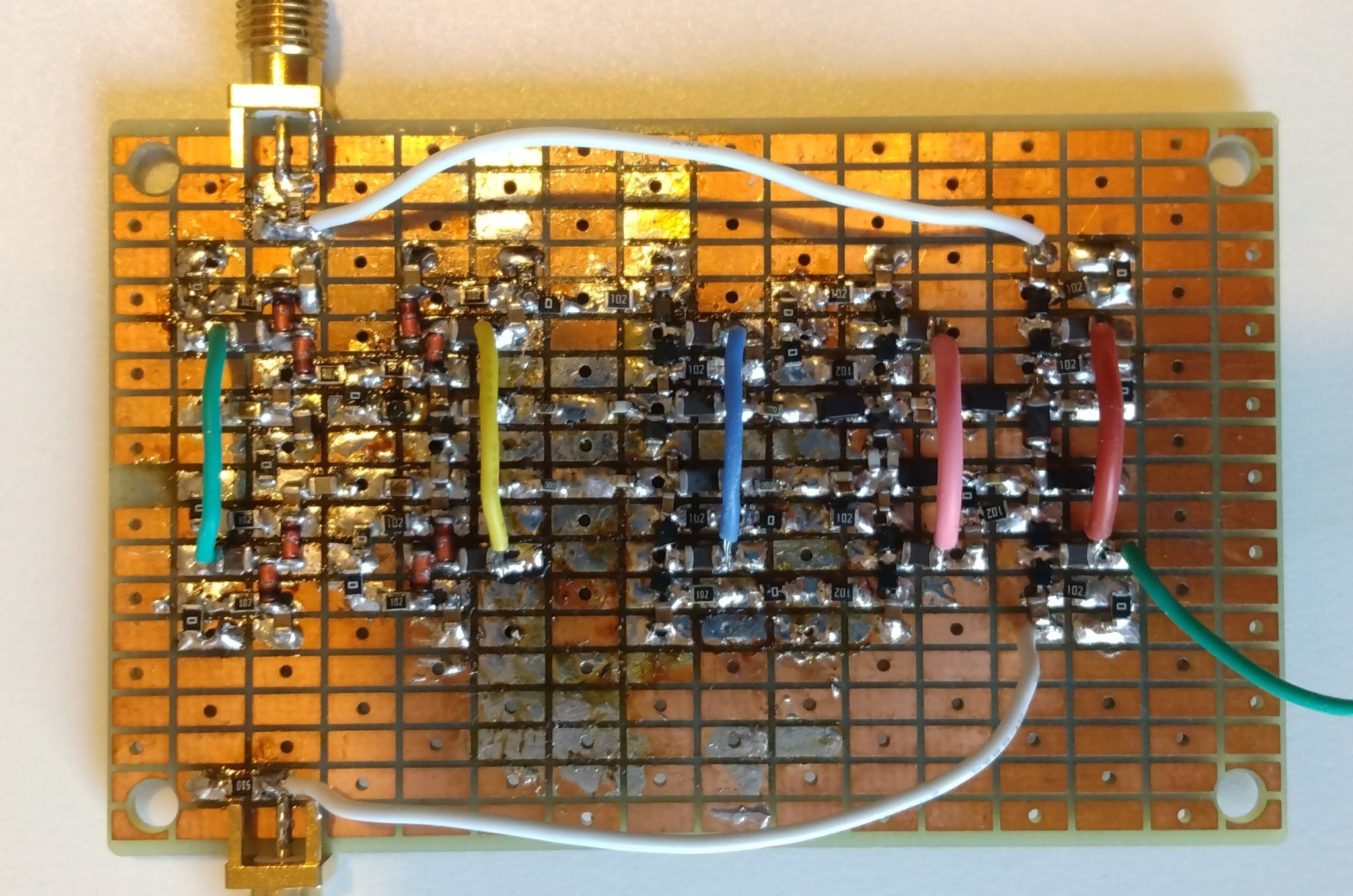

The 1N4148 diodes seem satisfactory for switching at HF. I used some AliExpress 100 / $1 USD SOD-323 devices for the last three filters. They also seem to work just fine. I can't tell any difference in the frequency response of the filters before and after adding the switches. The isolation looks good, or at least more than the RP can see.
I'm less pleased with the actual bandpass. I wound up with:
0 - 2.85 MHz (OK);
2.75 MHz to 6.75 MHz (OK);
6.0 to 16 MHz (wider than I wanted);
13-26 MHz (wider than I wanted);
24 -30 (narrower than I wanted)
I may set up a test board so I can tinker with the values and get a better understanding of how changes in the component values influence the shape of the filter.

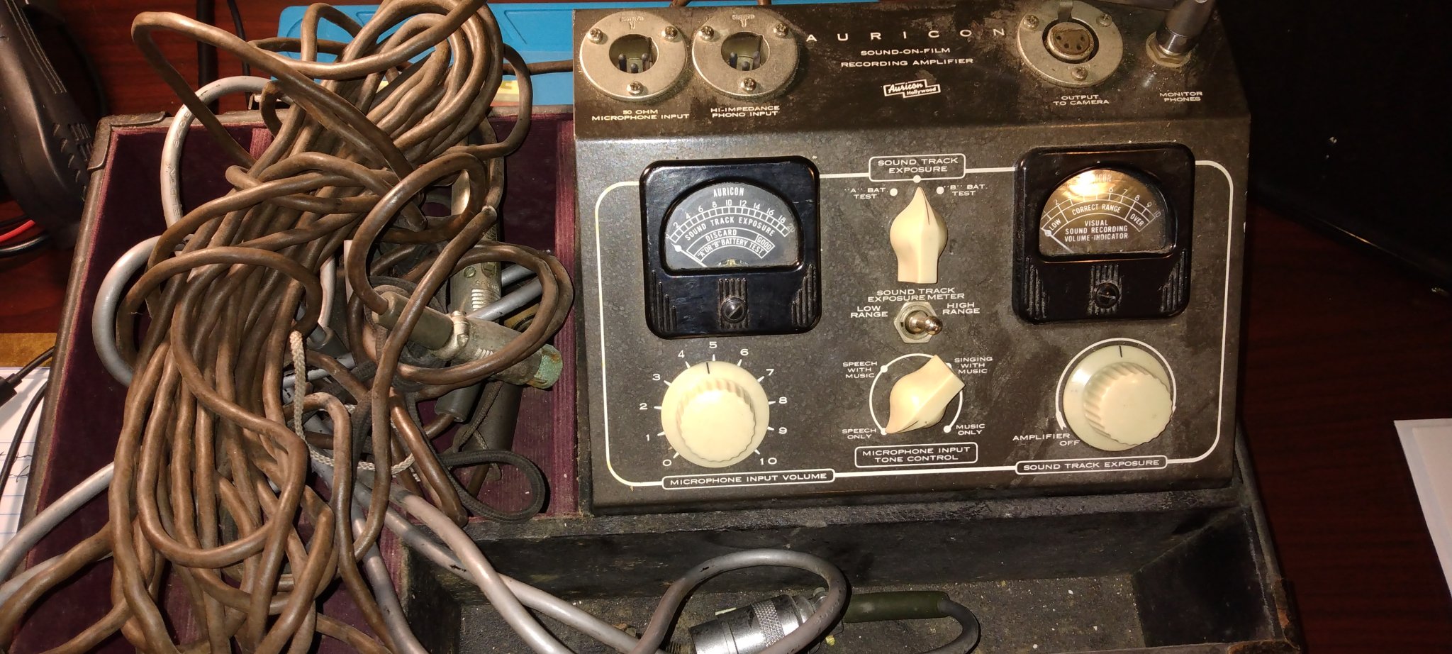

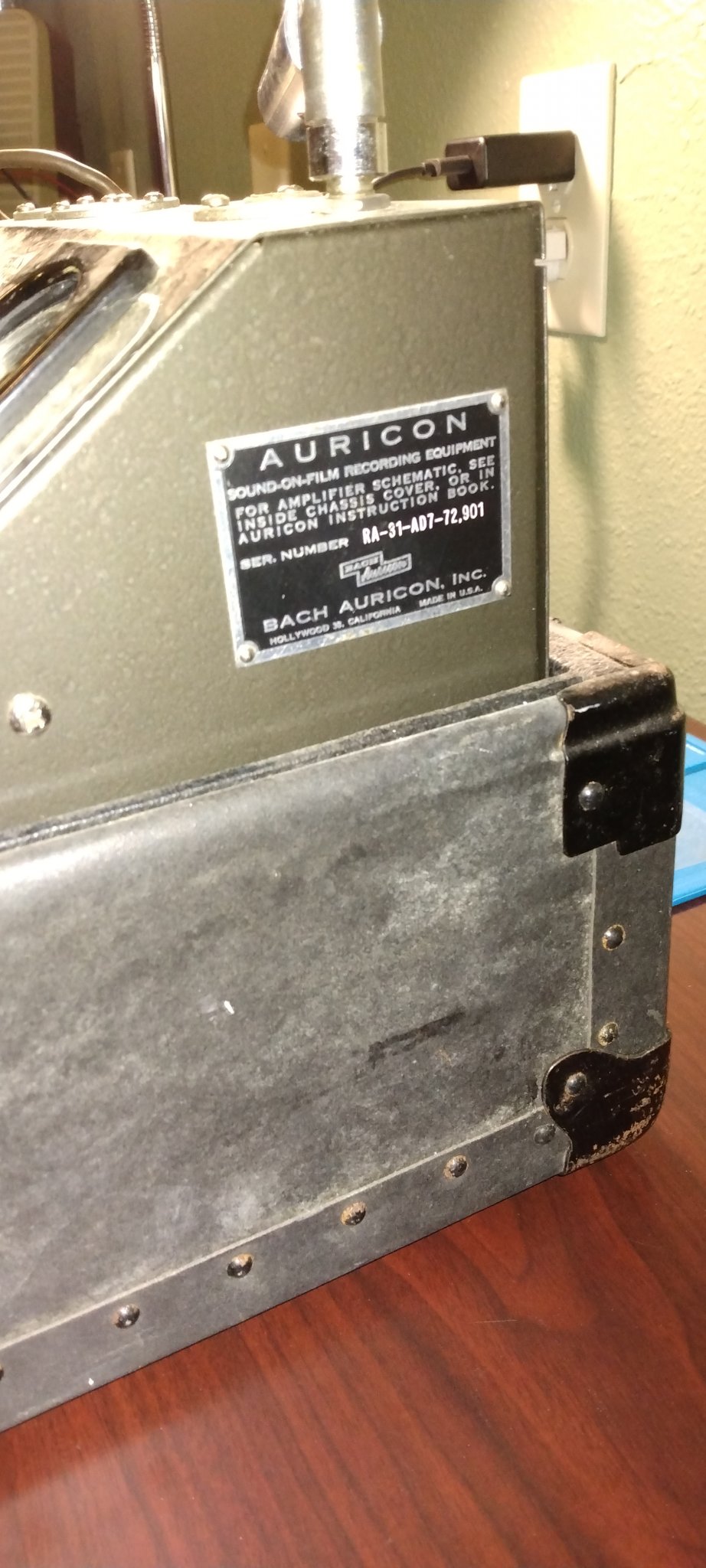

One of the artifacts of having practiced so long and having so much old ham equipment on prominent display in my office, is that clients just bring me "stuff".
A fellow I represented a few years ago just delivered this to my office. Anyone have any idea what it is?

A preamp for film recording, as it says on the plate. With dials for correct volume etc.One of the artifacts of having practiced so long and having so much old ham equipment on prominent display in my office, is that clients just bring me "stuff".

I tweaked around on the bandpass filters some, and have wound up with (at -3 dB endpoints):
0 - 2.85 MHz
2.75 - 6.75 MHz
4.9 - 12.5 MHz
9 - 18.5 MHz, and
19.5 - 30 Mhz
So, I'm going to leave it be for now.

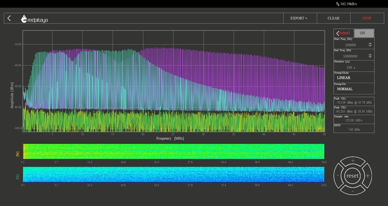

By alternating the inputs on the Red Pitaya, and allowing the signal generator to sweep 0 - 50 MHz, I made a crude graph showing how the filters overlay. I've got an undesired dip at 19 MHz, and I don't like the response of the highest filter - it's OK to 25 MHz, but down 3 dB at 30 MHz. I don't know if this is poor component tolerance because the inductor values are pretty small here, crude measurement equipment/ technique, or something else. The low pass filter for MW / 160 meters is not shown here.
On the other hand, the switching works well, and five HF bands easily fit on one 50 x 80 mm board.
I'll use a 5 volt line to switch the filters, and a color coded, brightness equalized, LED for each band shows when it is active.
