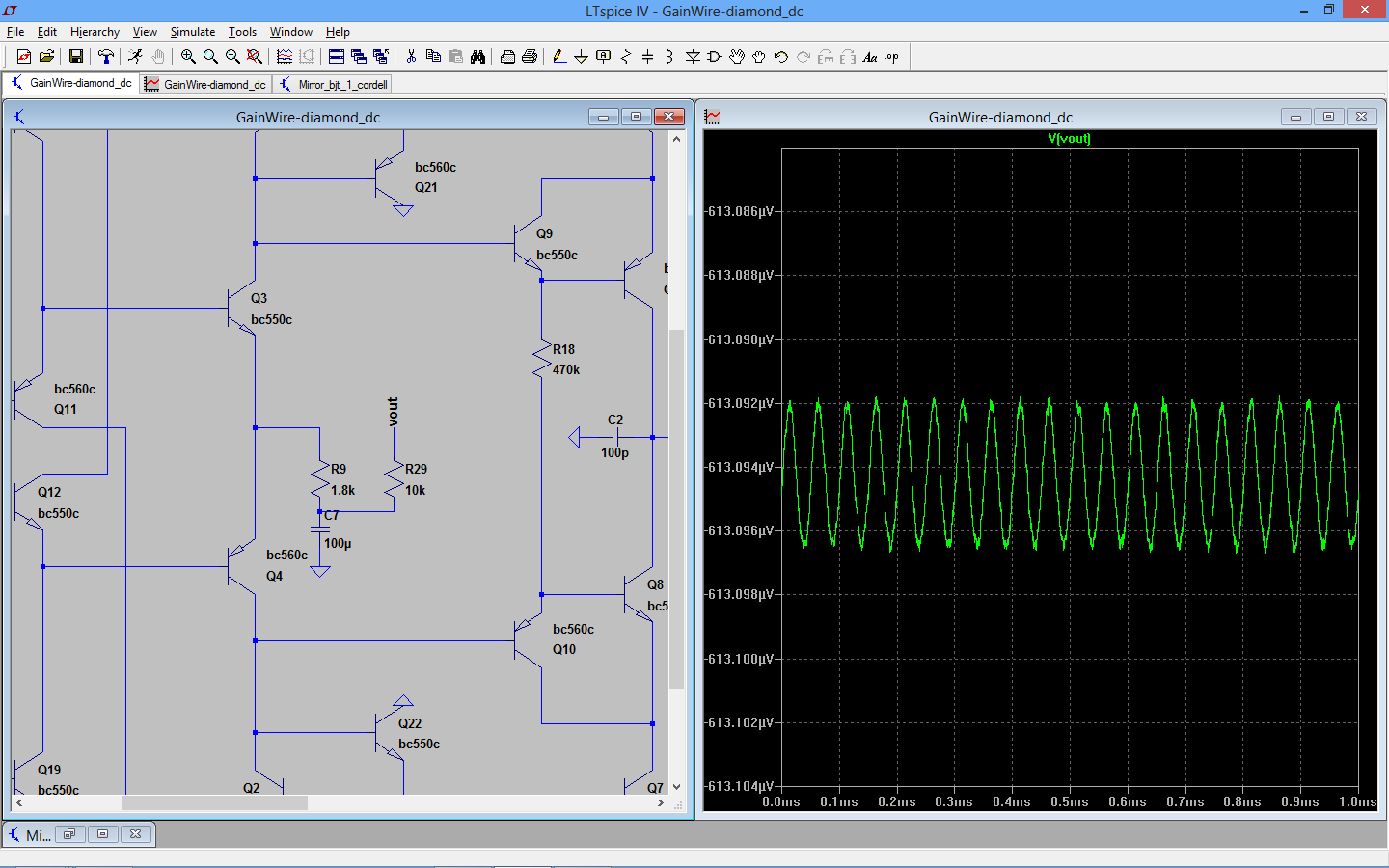

I would like to show you a way to use your circuit to control the output d.c. without the opamp, let me just take a picture.

Ok the change is simple, you only need to add a resistor and a capacitor to the resistor r9 , in this case the output D.C was -24mv without the change , and is now -600uV . Test it , have to do more tests , but it seems a good solution.

I have made a temperature sweep from 0º to 50º and the alteration have manage to compensate the temp. variation, except for the input stage, 13mv.
ofcourse a sub mv variation is only possible with a dc-servo.
You should also check the ccs at input, the bias current changed from 4.5ma to 3.8ma with the temp. variation, I recomend another type of ccs.
