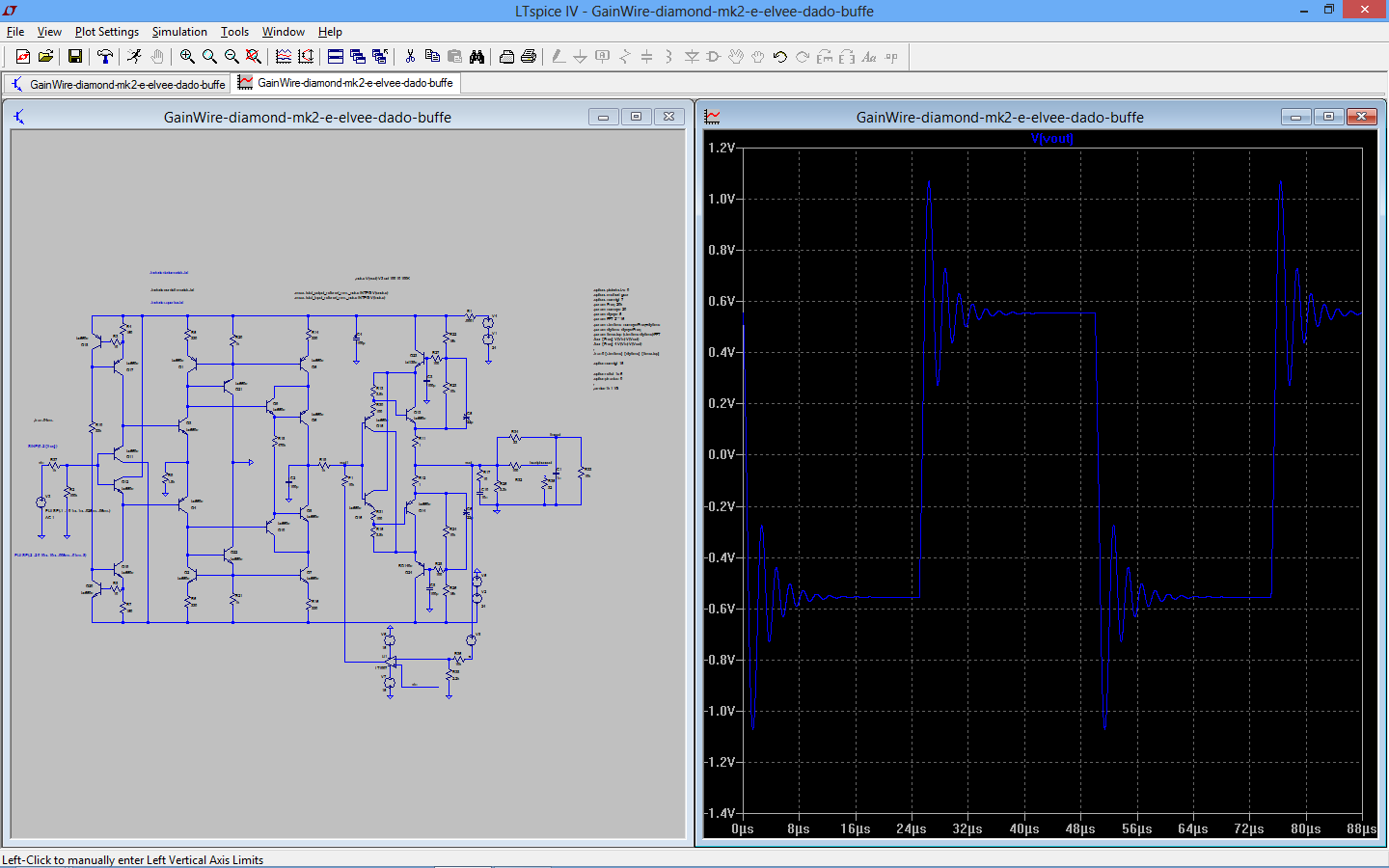

This feedback method can have very low distortion, and I think that it can be use in a class B power amplifier with good results.
Is this protected by a patent? who invented?
but this circuit have some points that needs to be improved.
the settling time of the circuit is very bad .

Thanks for the simulation, probably it needs input lowpass filter.
Sorry, highpass filter!

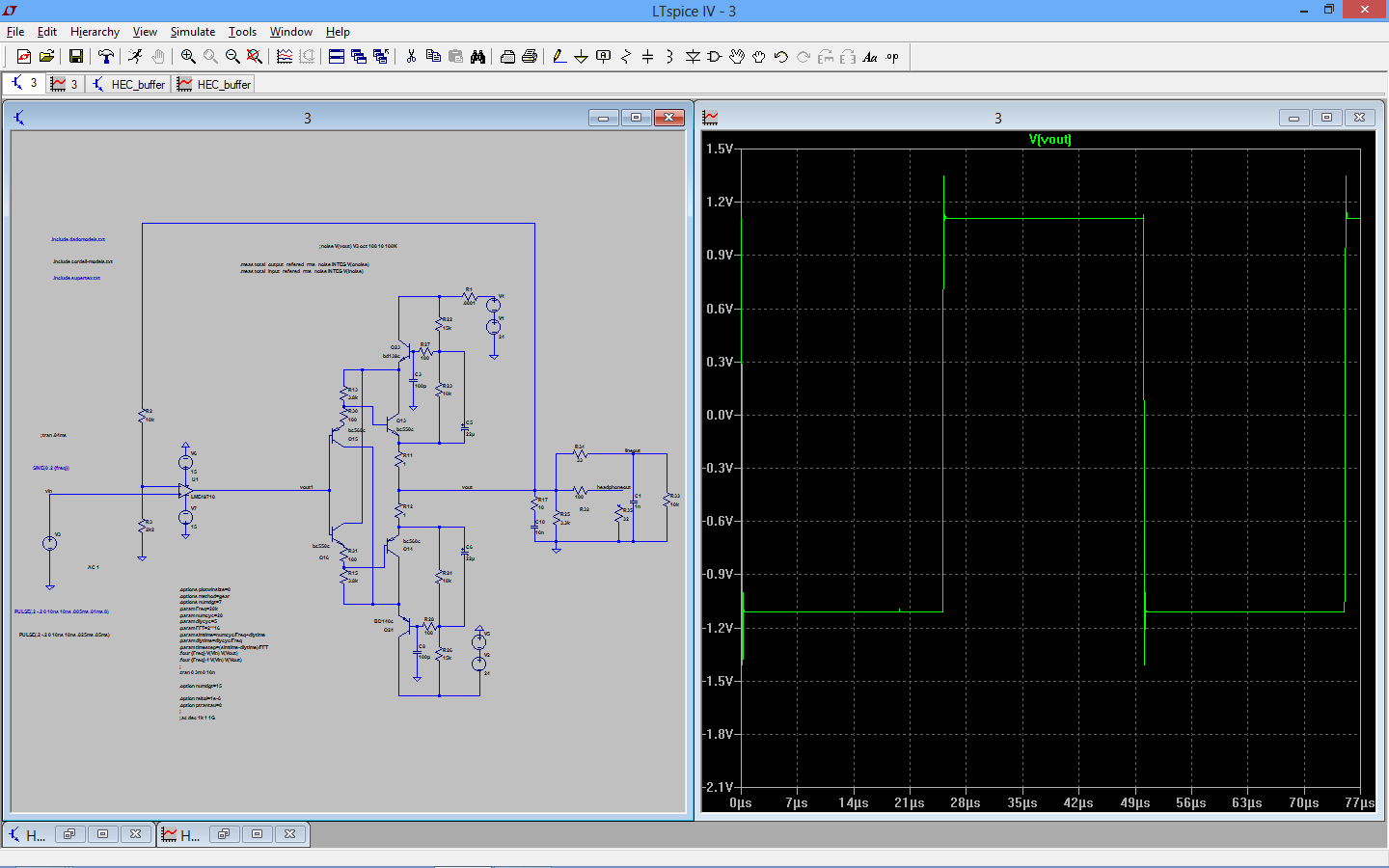

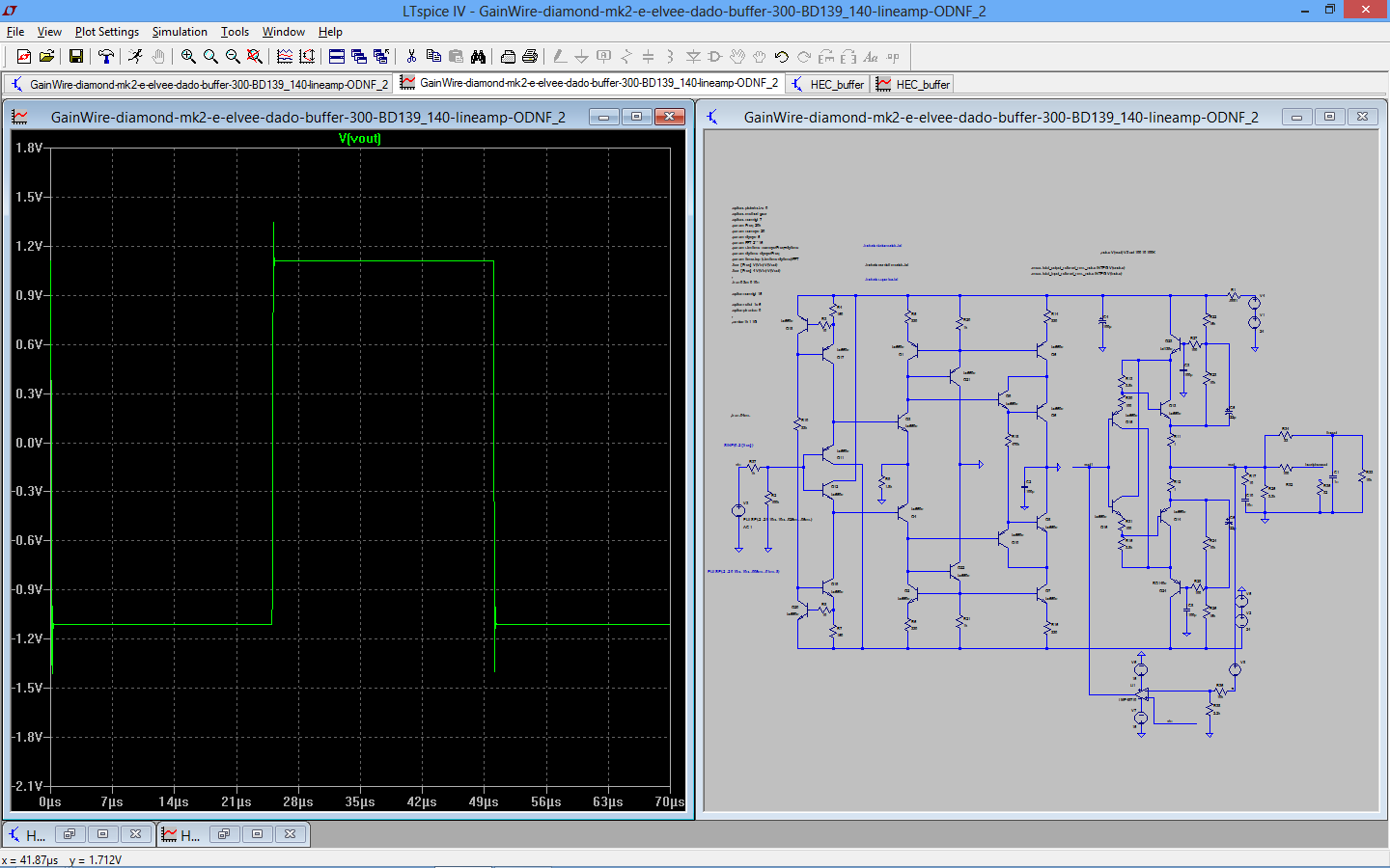

Yes there it is, ODNF op amp. Try to simulate.
In post #125 the simulation was made with a lt1007.

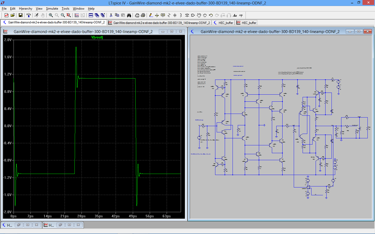

here is with the original lme49710. First picture with the ODNF, second with the normal feedback.
the resistor P1 (10k) is slowing the feedback action.
third picture is without global negative feedback.

What are you talking abouth here, what normal feedback??
In second case this is not any more my pre amp, you disconnected the gain block completely and op amp acts as the gain stage, please don't do that!!!
I am not sure you understood the main concept here.
what I am trying to say, is that your feedback loop is to slow.
And you can call it whatever you want, but this is a global feedback loop.
I like your original concept , and I am sorry you change it.
If you want I can help with the buffer, if you decide to ignore my advice is also ok 🙂
No it's OK, I like your help, just second simulation does not have any connection with my GaiWire. If you don't like ODNF concept then just don't use it. This pre amp is good enough without it and I did not change it. Only problem is DC offset at the output and I am not sure yet how to eliminate it without DC servo or ODNF. The PCB can be used both ways.

just second simulation does not have any connection with my GainWire.
the second simulation was just to show the settling time with only the opamp , I have redesign the circuit to better understanding.
Ok... now Forget this 🙂

If you do not want to use capacitors at the output, is mandatory to use dc servo ofcourse.
And you are right, the dcservo and the ODNF are so similar, that you can design the PCB board to use one option or onother.
One thing that may improve the settling time is using a small capacitor in parallel with the resistor (P1), but you have to test it.

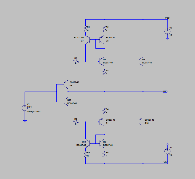

I know about Calvin buffer. What's wrong with my buffer? I wanted to use BJTs only here in this pre amp as I made the one with JFETs http://www.diyaudio.com/forums/anal...onveyor-voltage-amplifier-24.html#post3447084 and FETs are not easy to find any more.
There is nothing wrong with your buffer ,your buffer is perfect for line_out.
But if you want to drive low impedance loads like some headphones , the Calvin buffer that uses local feedback is more apropriate.
But for line_out I would prefer your buffer.

As I understood Calvin buffer is single ended and mine is pushpool, and I thig more suited for low impedance load.
I use buffers exactly like yours , and I know that with low impedance the distortion rises.
The Calvin buffer was tested with low load impedances by Joachim Gerhard, the output current can be limitating.
The amplifier that I use with my headphones (250 ohms) have also single ended output with 50ma d.c.
