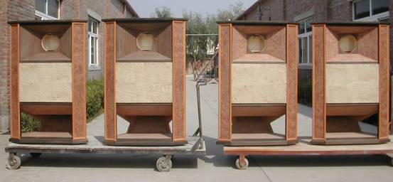

genalex said:Lowther club of China build Opus 1b
Here are the Lowther China Opus 1's

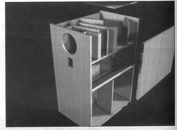

a variation on opus 1
Here is a link to an italian maker who is producing a slightly modified version of the opus 1.
http://www.maclementhorn.it/Lowther_Opus1.html
regards,
