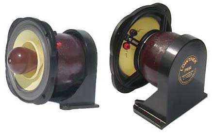

With regards to the Shokokuji (is it official yet?) horns, the PM4A's have a stand that can be fastened to the bottom of the compression chamber as well as to the supra-baffle. What would be the preferred way to de-couple the driver from the baffle? Or would we de-couple the supra-baffle with silicone instead? Would it be an idea to have the supra-baffle made of some form of stone?

Yes, you can use the PM4a's supplied stand if you wish. FWIW, my personal preference would be for a holy brace, as seen in some of Dave & my other cabinets -I don't like having too much metal in a cabinet, & the brace would allow the driver to be positioned centrally, should you wish it. BTW, for the sake of interest / accuracy, the rear-chamber is a low-pass filter, not a compression chamber. For (most) BLHs, the room is the compression chamber.
The driver doesn't have to be decoupled from the baffle per-se; it's a double mount, front & rear. A simple gasket should do the trick ~'good enough' to push any issues below the audibility threshold. As for materials, whatever you like; you might notice some audibile changes, although it's unlikely. Me, I'd use a nice quality hardwood of some description, or even (whisper it) fir, pine, spruce or similar, if properly dried & stable.
