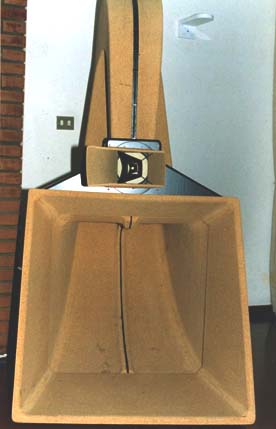

Just finished the bass horn part, will add front part in future. Any driver recommendation other than PM4A for Azurahorn? I am using DX3 now.
Following from Martin Seddon,
"No back chamber - I actually think one wants the maximum upward extension from the back horn - you can try sheepskin on the floor of the bass horn if you feel too many highs come this way. I am using Lowther PM2A on the bass horn alone up to 800Hz with 6dB roll off above. I have found the mid range sounds just great down the long horn."
What flavor do you want? The DX4's do fast & dynamic really well, the PM series does more warmth and harmonic development. As the magnets get larger you get more information and better dynamics, so the PM4A is the king, and below them are (in order) the PM5A, PM2A, PM7A, PM6A. All will work, and be thoroughly enjoyable. The Field Coil is truly outstanding, but pricey.
