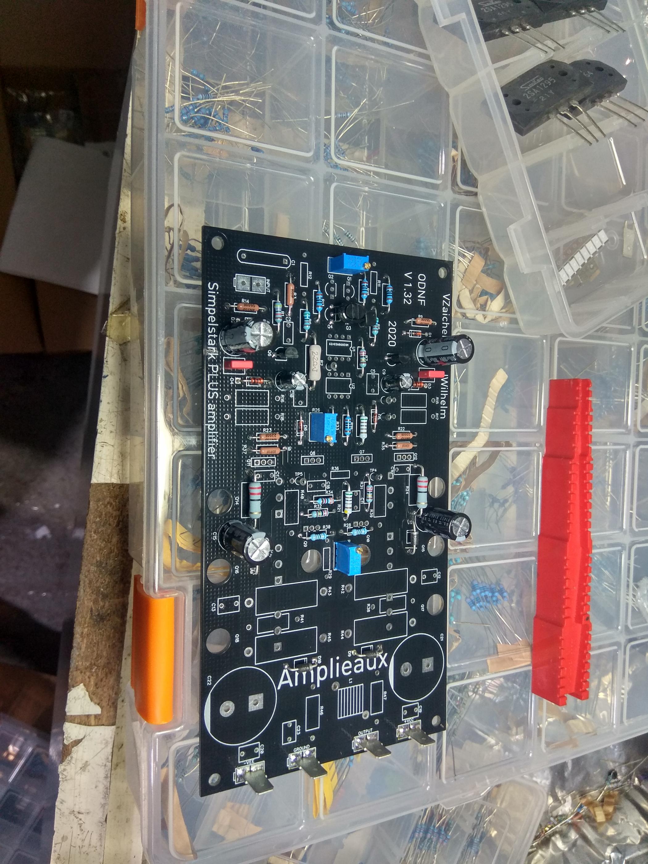

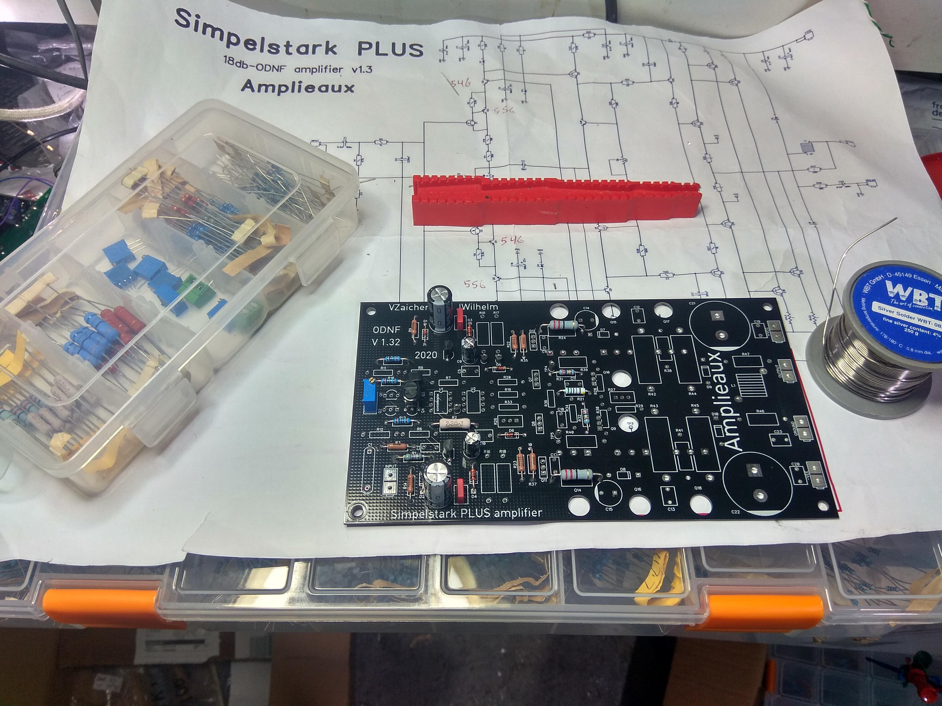

Thanks, i'm looking for protection boards schematic, this compatible with my version.
I need the bom also!😉
Here are the build guides for them. BOMs and schematics are in the guides. For Simpelstark Amps change R16 and R18 to 220R resistors and connect the bias inputs to a single emitter resistor on each amp board.

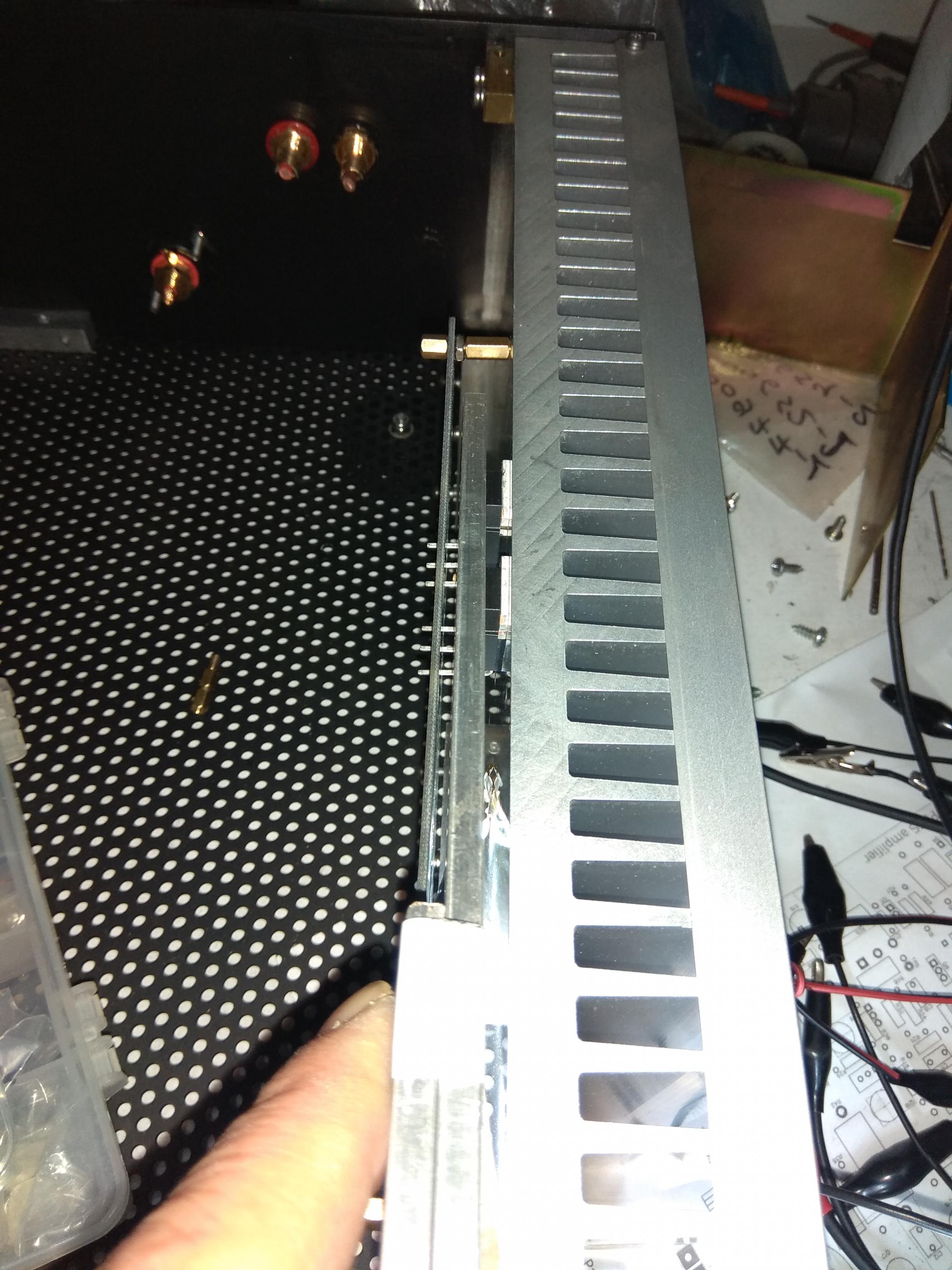

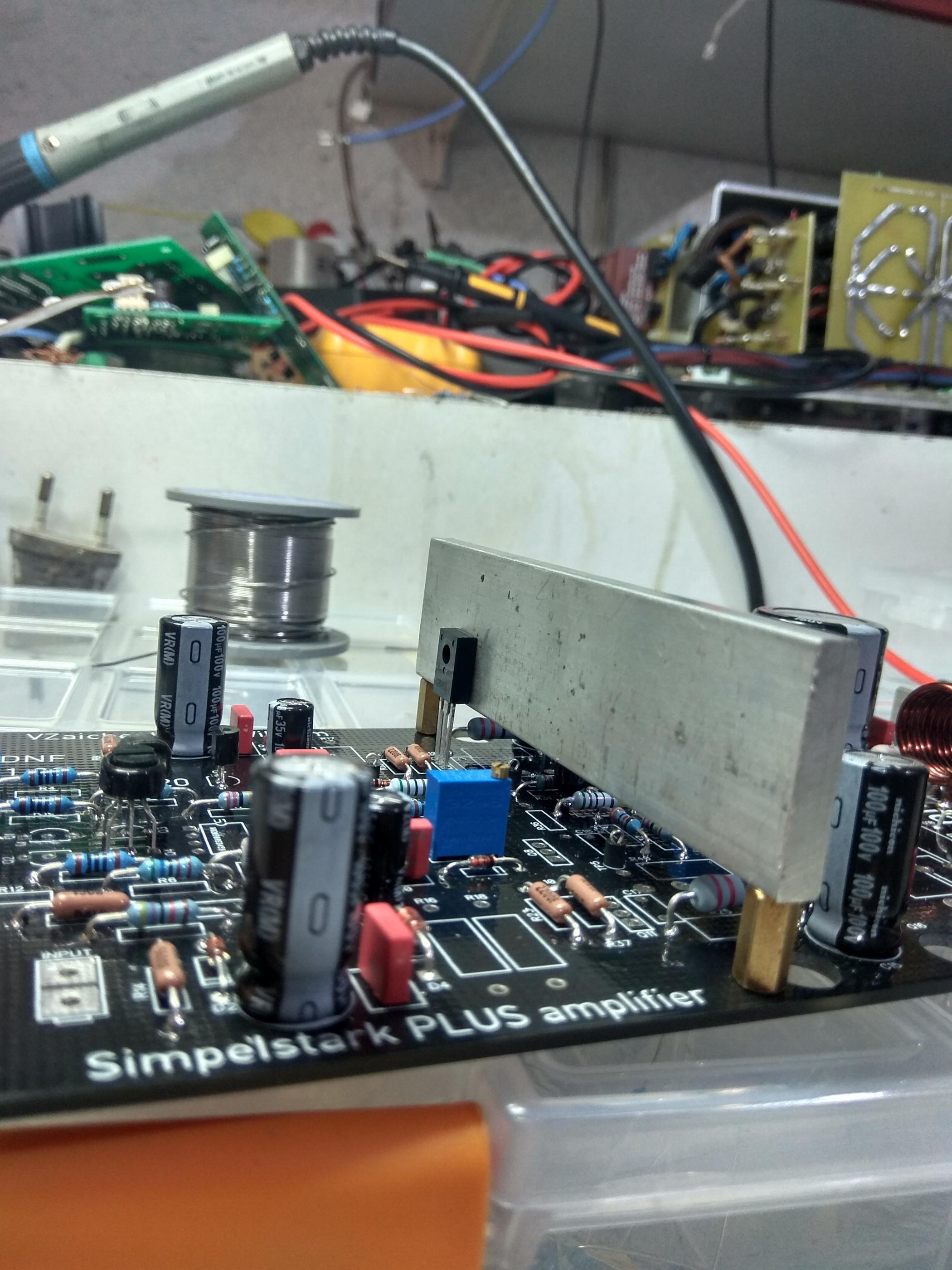

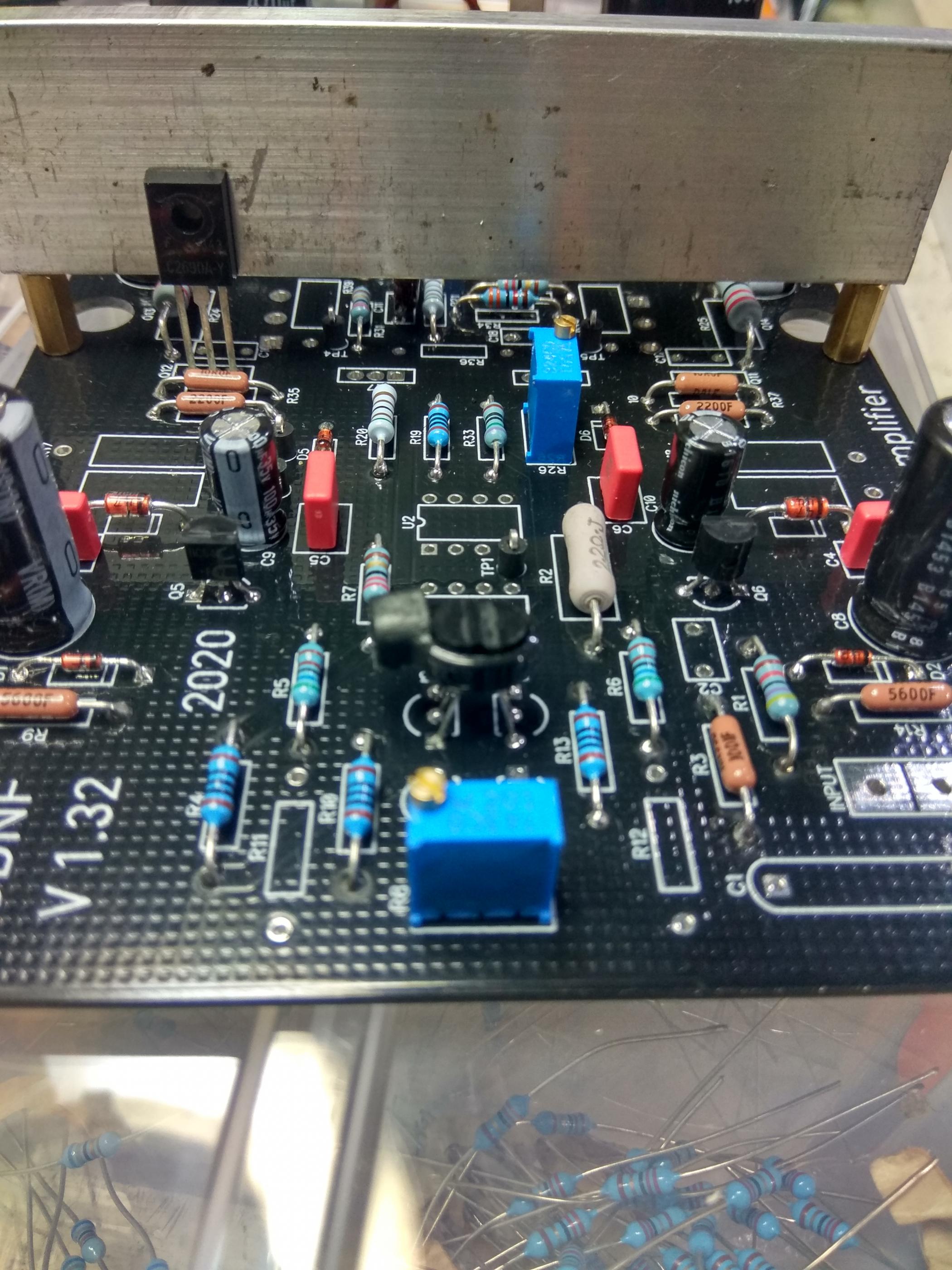

I think, either way is fine. In my build I have used a separate screw for each transistor.
Valery
Valery
This causes as many arguments as picking a wire type! The best way to mount transistors is to clamp two with a single screw in a U shaped channel to proper torque specs. Everyone over tightens them though and destroys the u channel causing uneven clamping force. The next best option is individual screws in each transistor. A bar across more than two transistors is a bad choice because any variation in the thickness of the transistors, ect will cause uneven clamping pressure.
Thanks both for answers!
I have the sense that heat sink isn't absolutely flat and the flat strip may be help but now i will go with separate screw for each one of the transistors.
You can put some fine sandpaper on a mirror or glass and run the heatsink over that to flatten it out (It's a lot easier than it sounds). Wet paper with a little water works really well.

I hate reading printed DipTrace schematic!

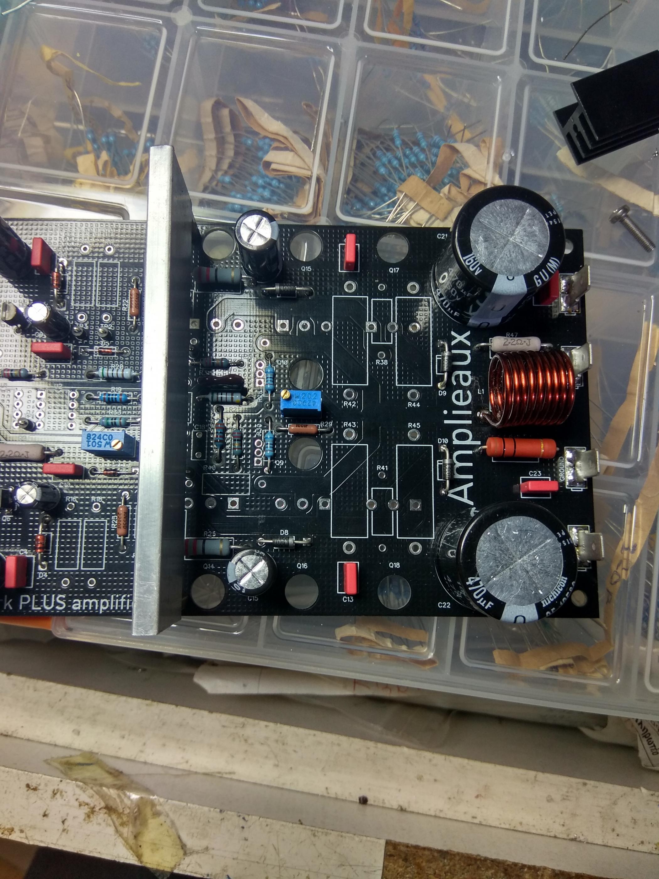

Can all these Q7,8,11,12 share the same heatshink?
If so i will use this configuration.
