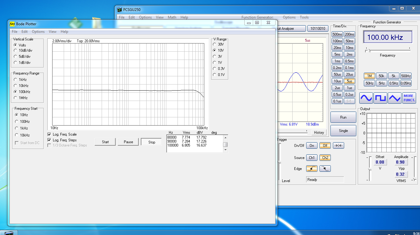

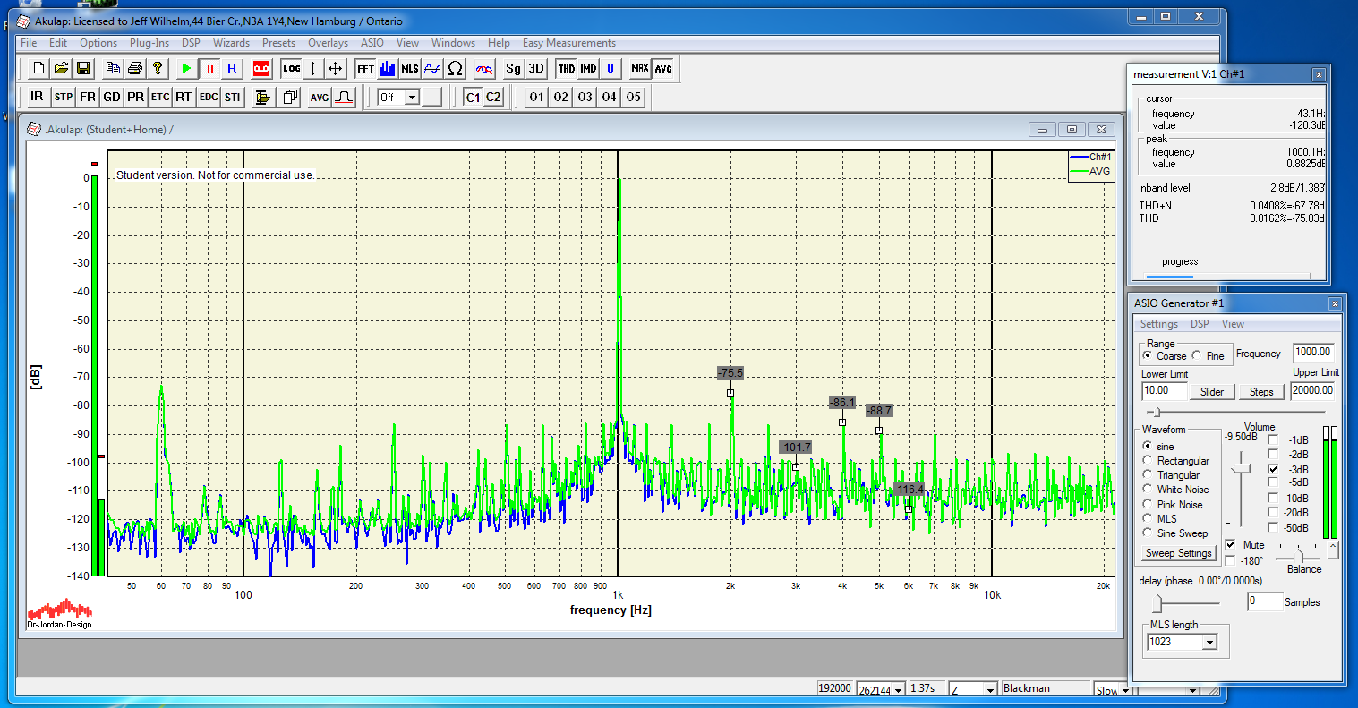

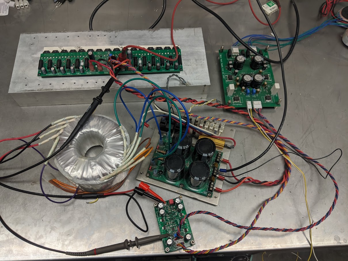

I've just move locations of my lab and am still setting up shop so I can't do any proper measurements yet. Here are a couple quick measurements I was able to take with the amplifier attached to some scrap metal, not very good cooling.
