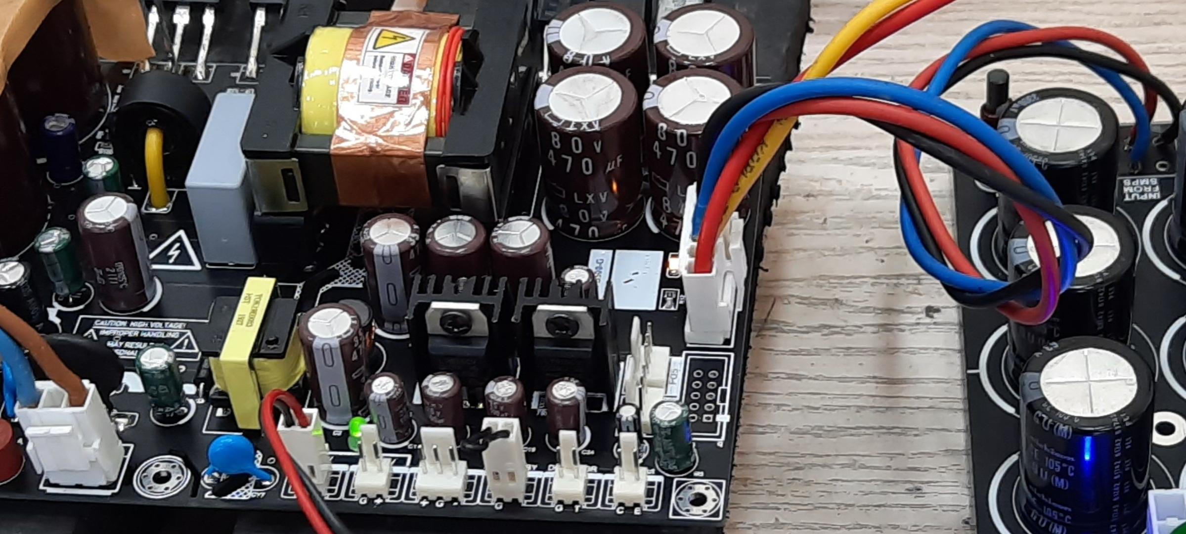

The Simpelstark has a new big brother in the works. First tester boards arrived today.

Nice new SMPS Sami!
Do
Thanks, still new things will show up later

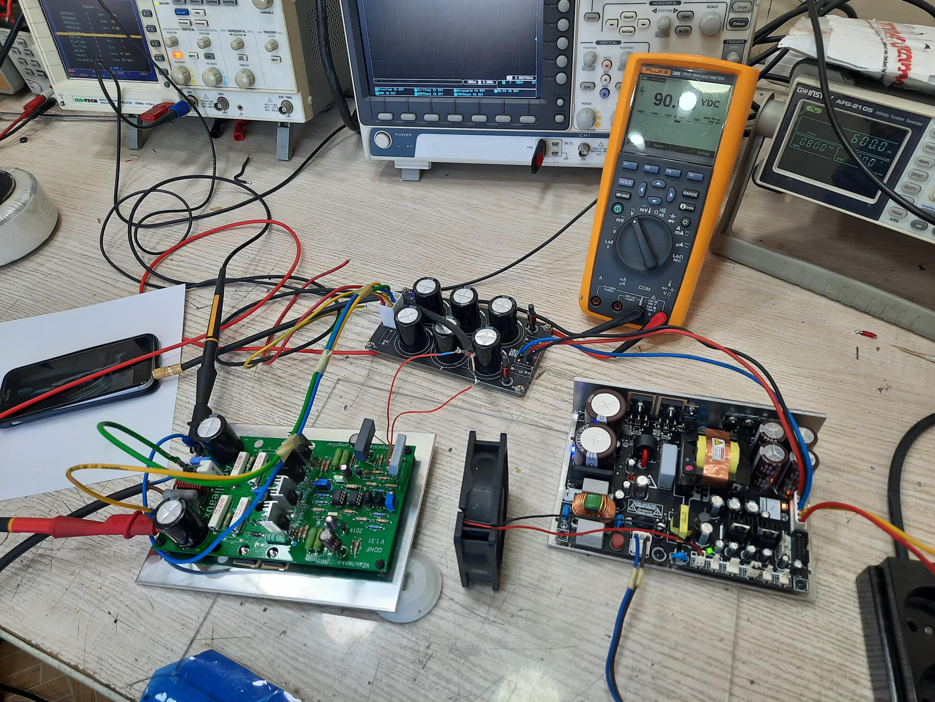

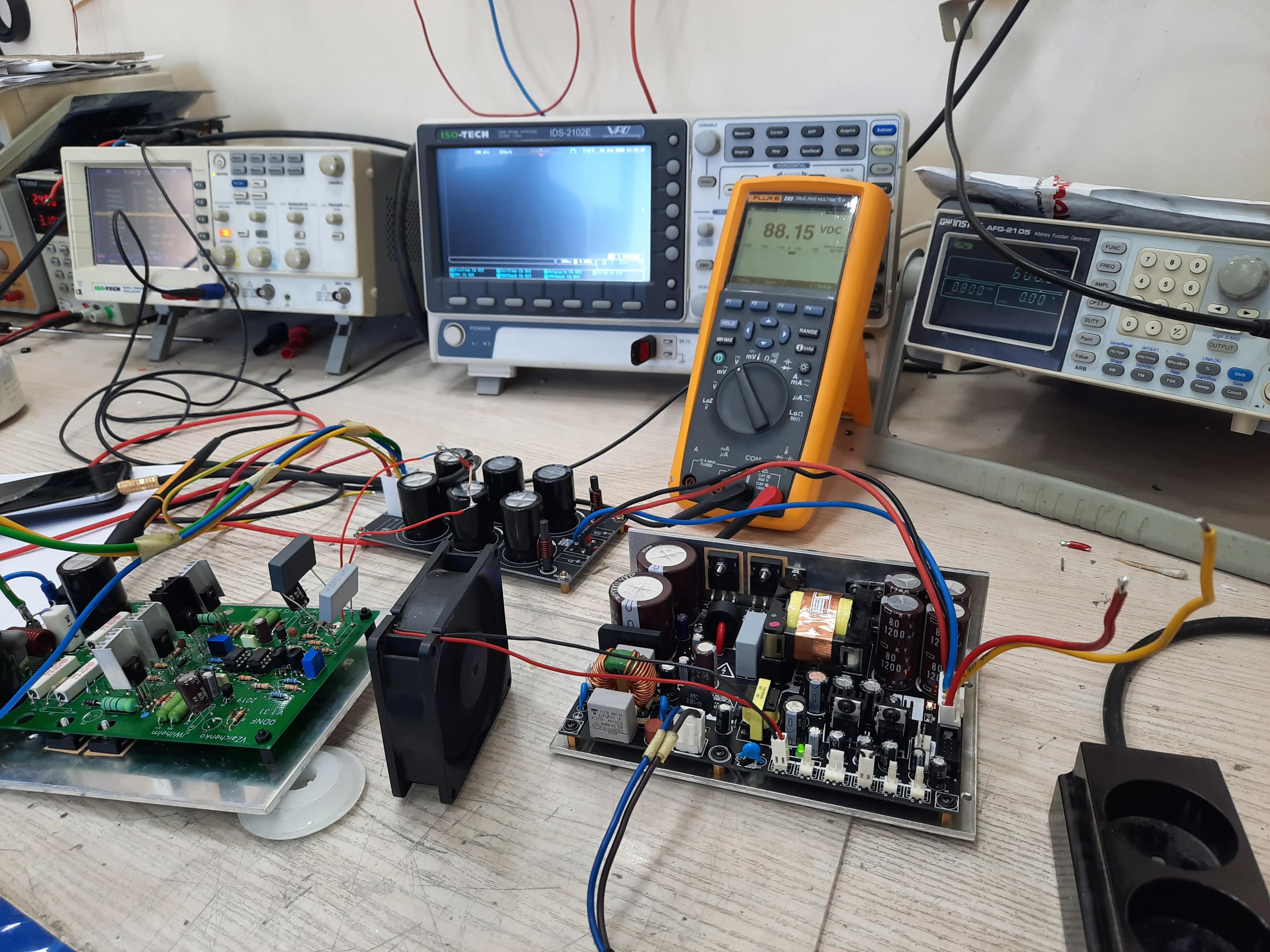

Testing started today.
The first impression, this amplifier sounds so natural from the first listening session.
I am enjoying the music right now, will report more later..
You know, the old Simpelstark AX2 (v1.3) has the famous decreasing harmonic profile, with dominant H2 between -73dB and -85 dB, probably the latest is a good compromise.

I was comparing transformer based PSU with the SMPS there was direct difference in the HF response with the SMPS, with the transformer based PSU the sound was dry.
Thats my opinion and what I noticed. And it is not a reference to follow.

There are some testing going behind the scenes for many PURIFI setups, and it will remain hidden until I get the results.
I'm curious why the sound is different with the SMPS? Do you think the supply droop is less?
To tell you the truth, the only reason forced me to use a linear PSU was some noise in idle buzz, after that, I had to use linear PSU to test and see if the SMPS is responsible for that noise.
When I started the music we both noticed that the sound is different, the HF was more open with the SMPS let say, I don't know if my description is true, but later I found that the source of noise is (my phone) is responsible for the noise, and immediately switched back to the SMPS to continue enjoying the music.
I am still telling you that this is my personal opinion.
However, when the phone (different one) was connected directly to the amplifier there was no noise at all, it was deadly silent. shown in the picture
