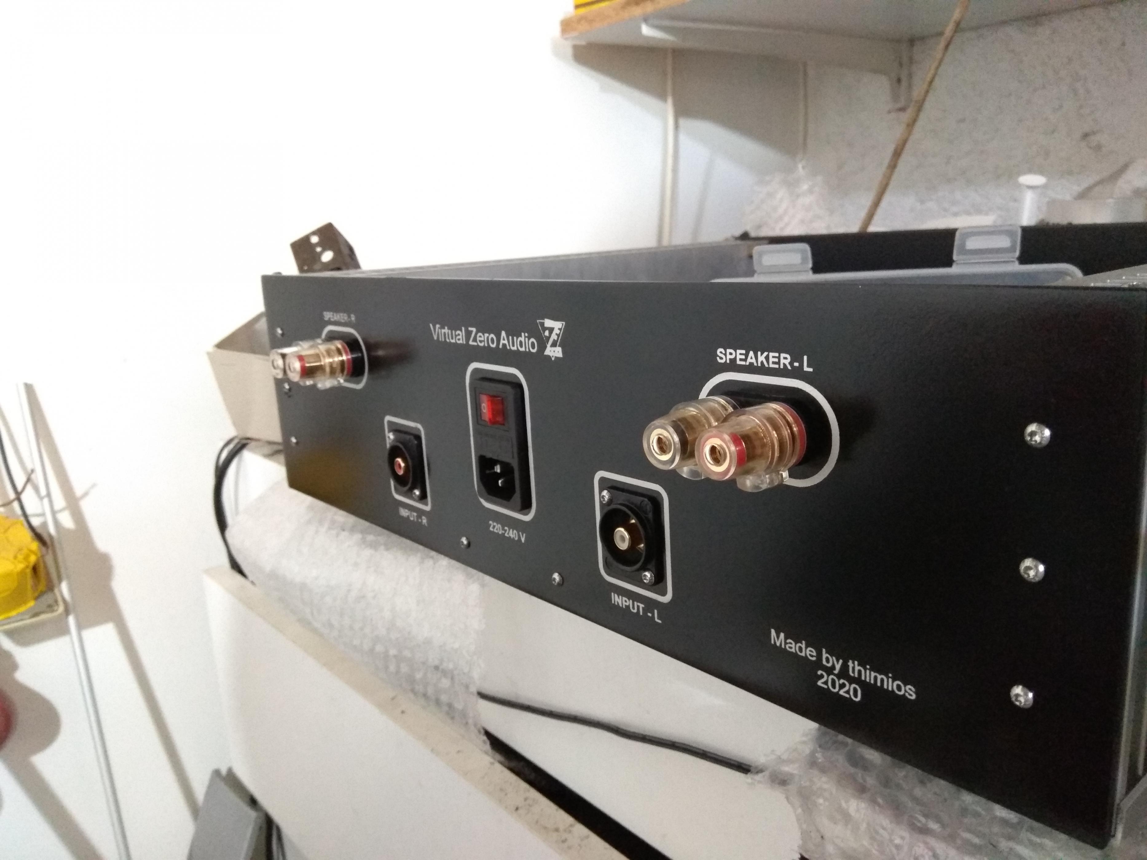

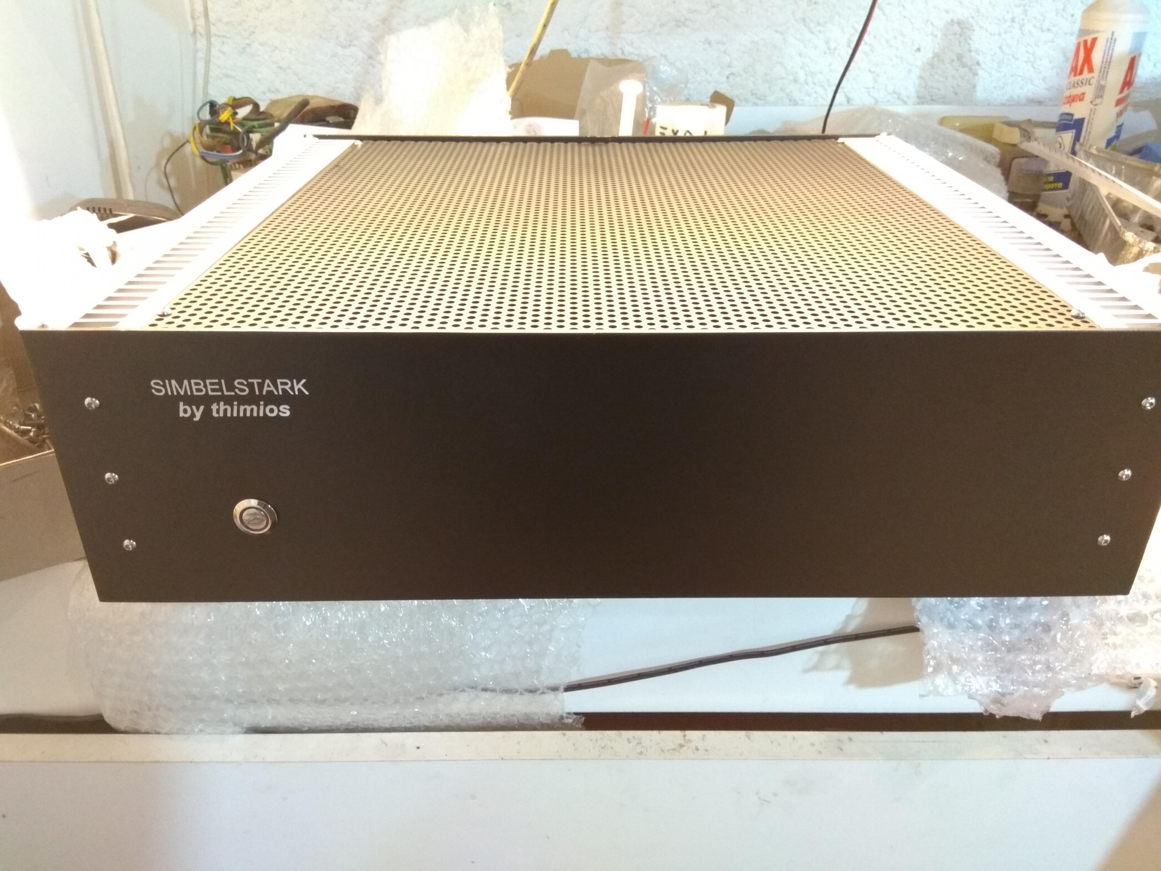

Lettering done.
Is that a spelling mistake I see, should it not be "Simpelstark" ?
The name Valery used "Einbahnstark" is a cool name to use as well.
Other than that, fine work, cheers to you

Thanks rsavas, this name is from post#1.Is that a spelling mistake I see, should it not be "Simpelstark" ?
Other than that, fine work, cheers to you![]()

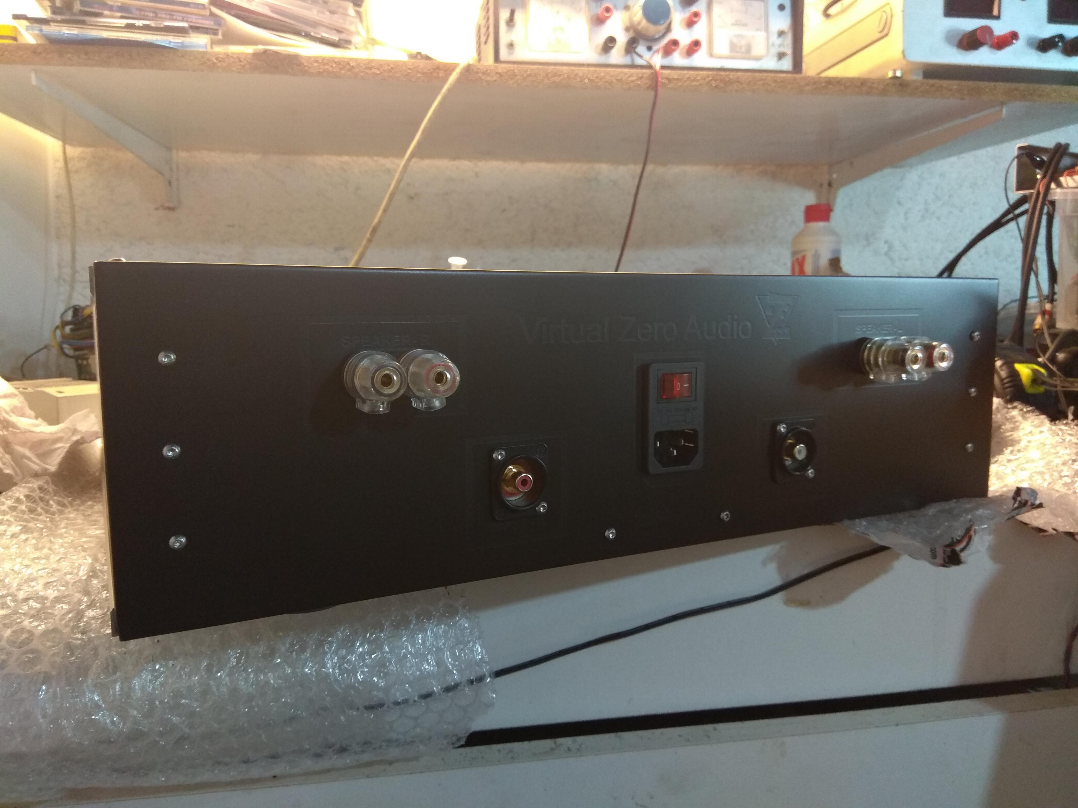

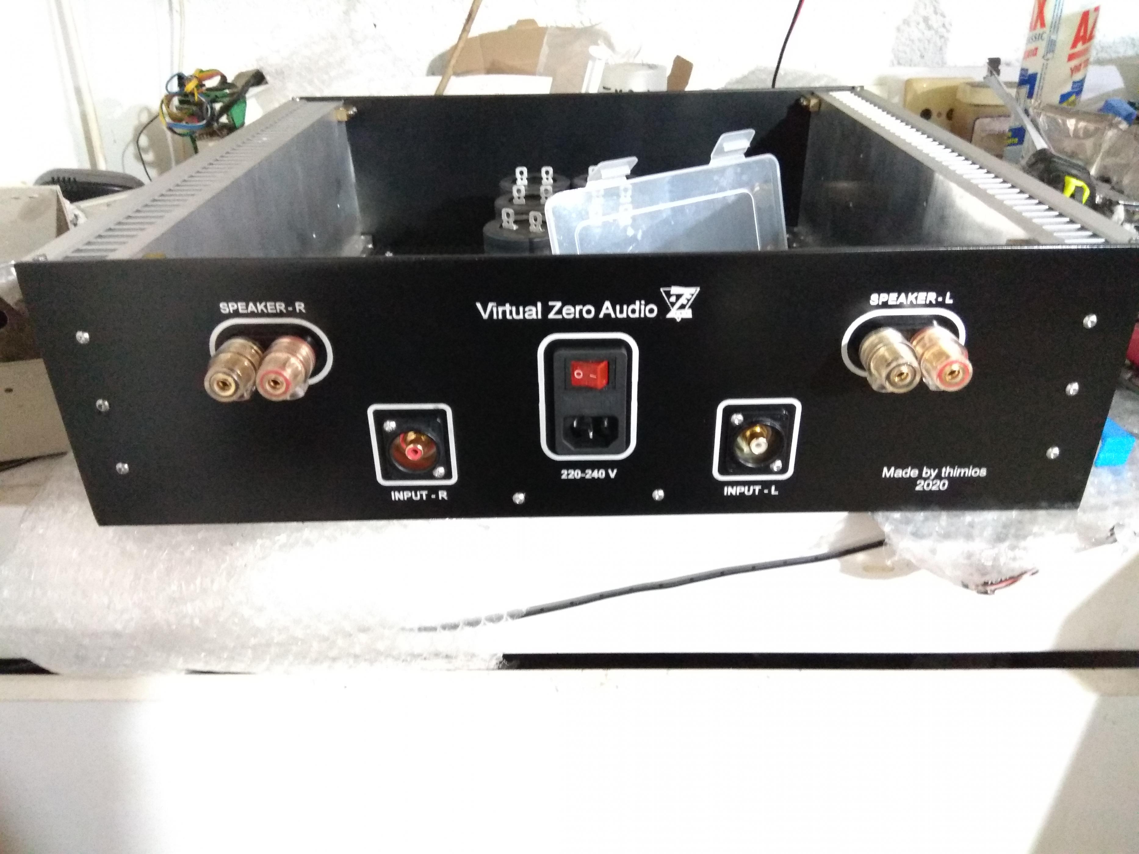

I'm busy reworking on the rear panel.
First attempt on lettering isn't successful.
I must rub,anodize and paint the rear panel again.🙁

Hi thimios, i don't really understand why you anodize the panel you will paint. The anodize surface provide a really non adherant surface for painting job. To paint anodized aluminium parts it's always recommanded to rub out the anodize layer. So you provide paint adherance and before finish paint it's recommanded to spray an epoxy primer.I'm busy reworking on the rear panel.
Marc
Hi Marc, i used the anodized surface as primer.
The first paint coating disappears by wetting the anodized surface.
I don't know if it is something wrong but works well for me.
Keep in mind that the anodized surface prior to heat sealing is porous.
This is probably the reason the paint works.

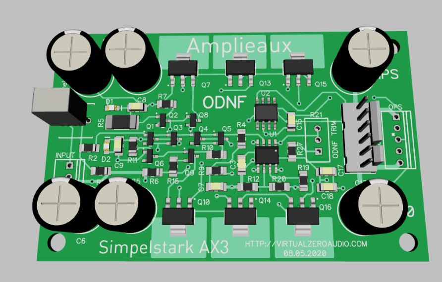

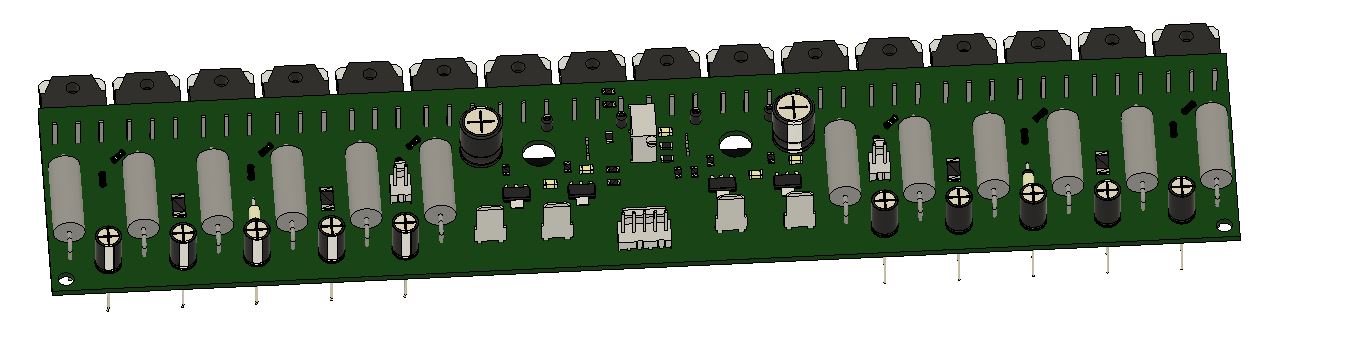

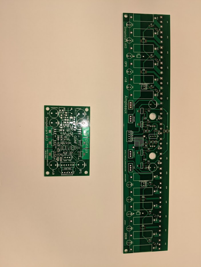

The Simpelstark has a new big brother in the works. First tester boards arrived today.

What's the specs on that new version? PSU requirements, output power 4 and 8 ohms, etc... I'm excited! hehe

I'll likely be testing it in a 250W @ 8R version, but it's got enough output devices for 500W operation, so it should load down well if we can cool it. It'll fit nicely in a 4U or 5U 300mm deep chassis. Everything about this amp will be unconventional, including the power supply and protection scheme, so lots of testing to be done before releasing it into the wild.
- No-global-loop amplification
