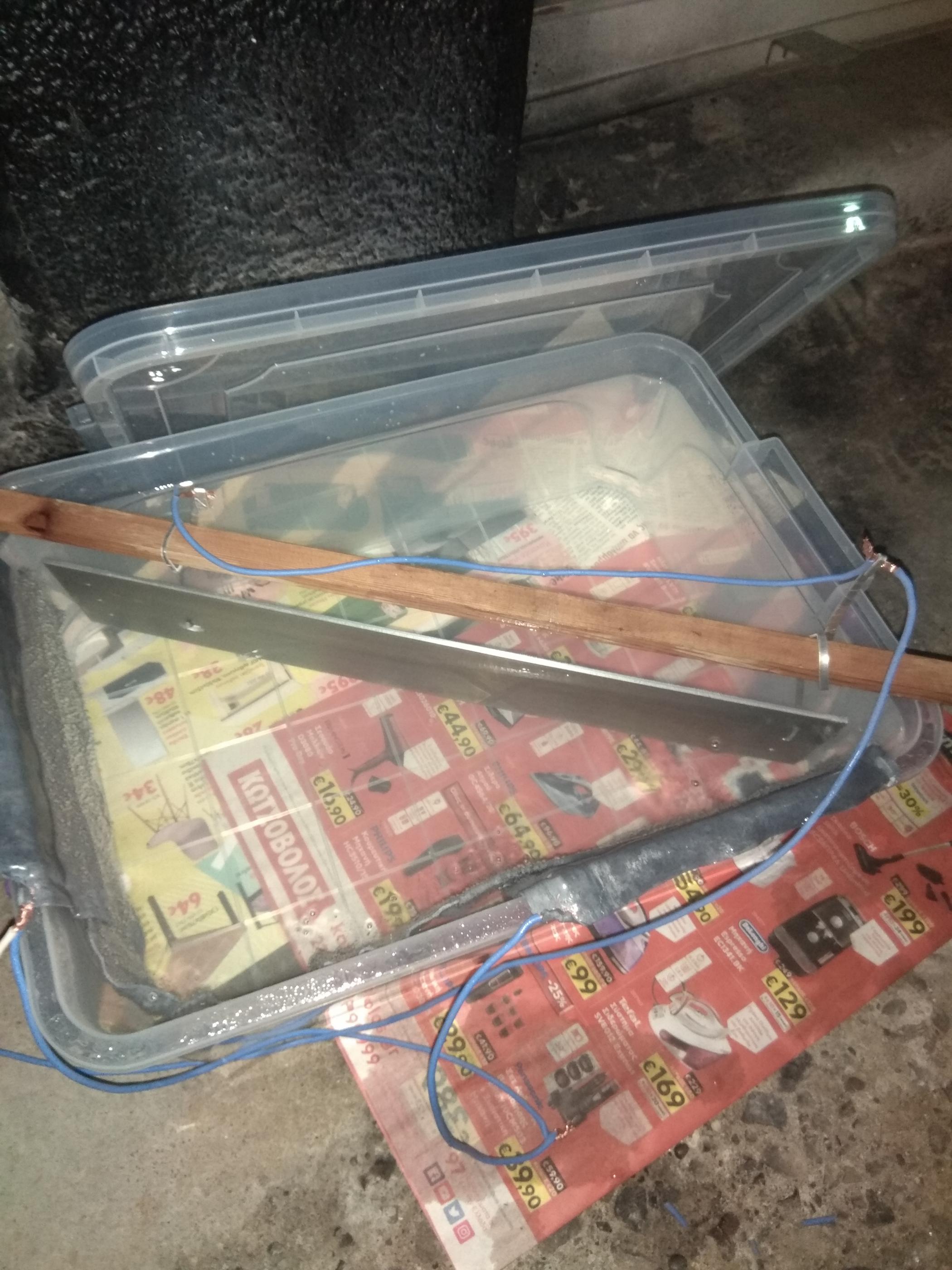

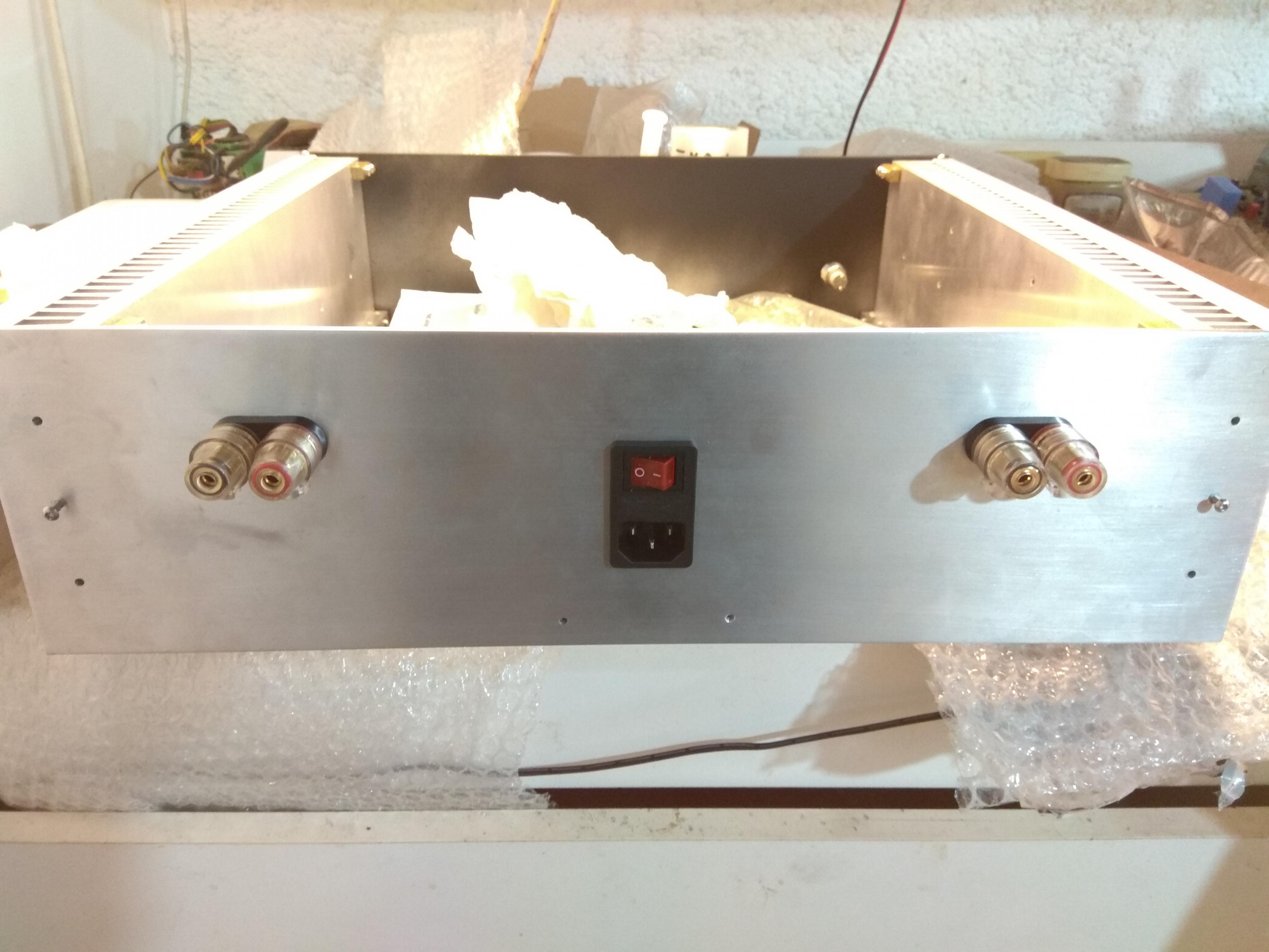

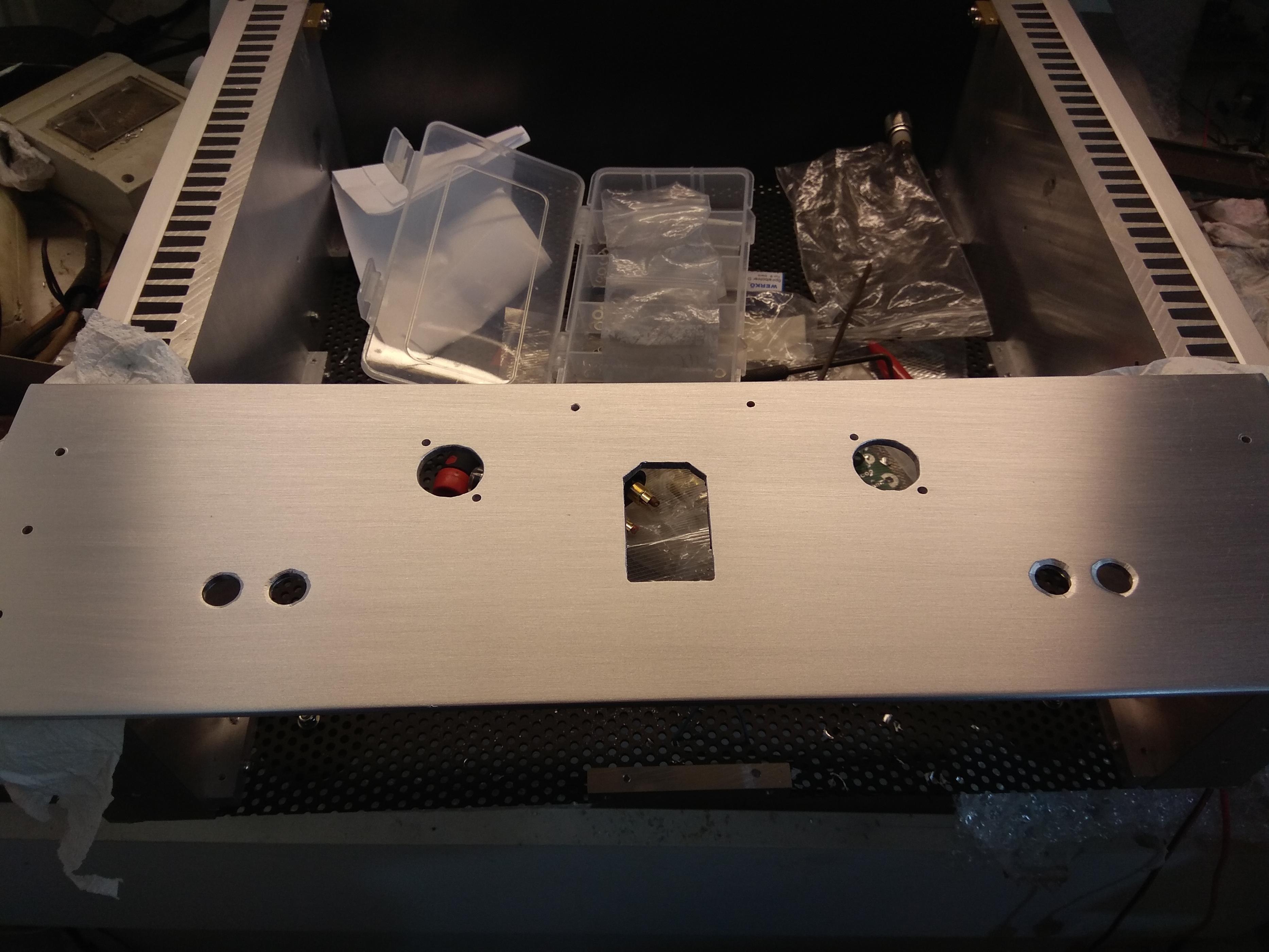

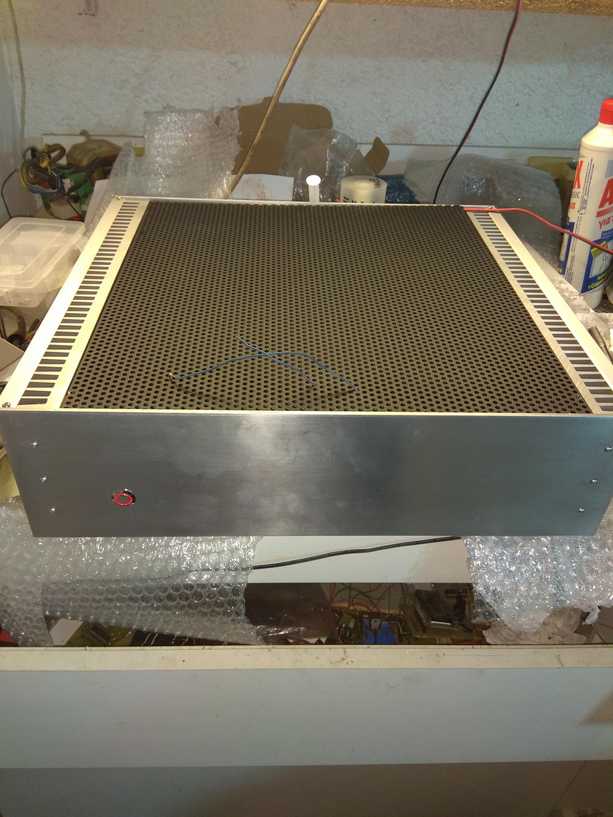

First paint layer.

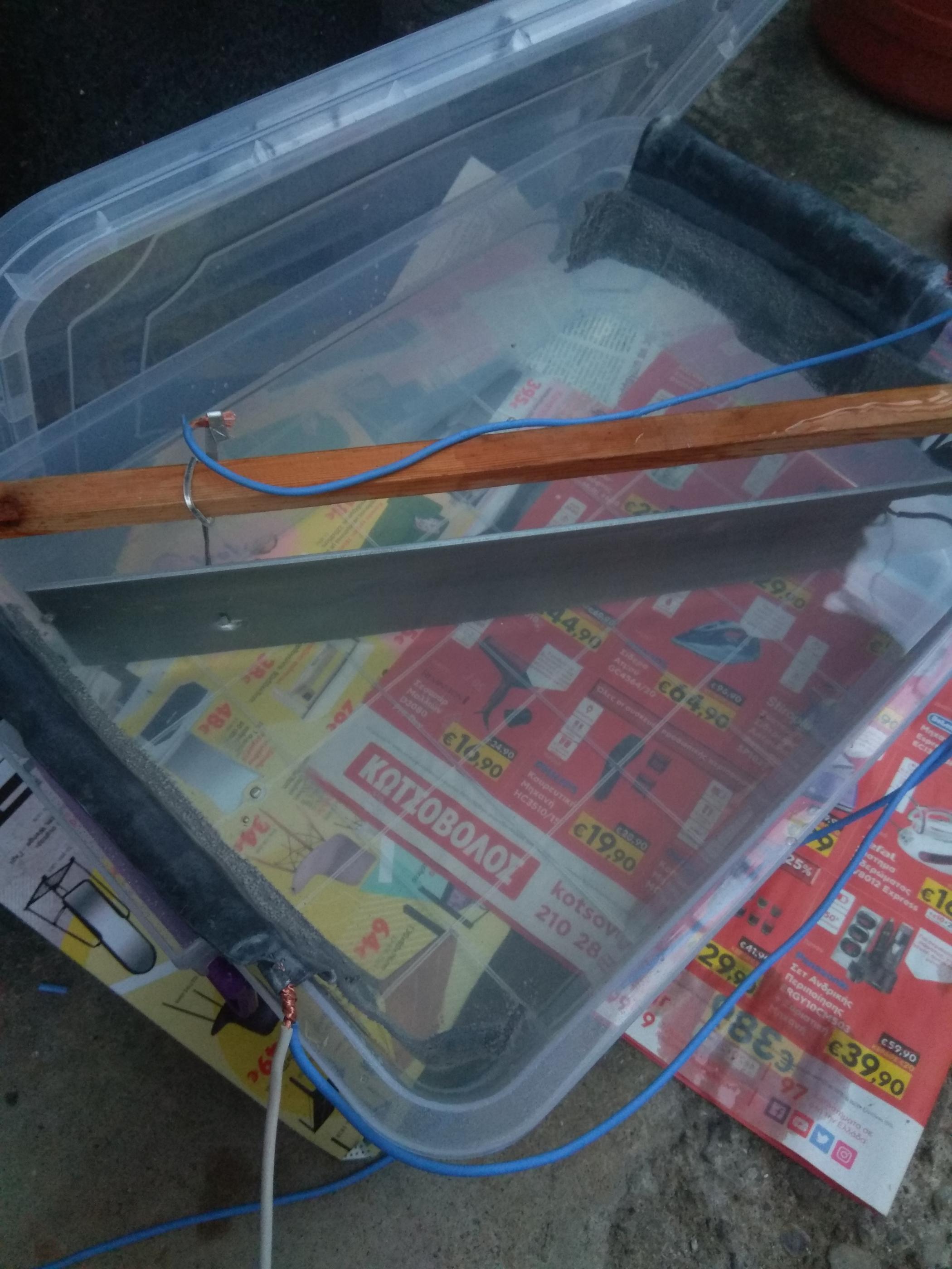

Looking good so far! Are you painting or dying the metal?
I haven't a way for dying, just painting.
Anodised surface works as primer. The paint is deeply moistened.
Finally is strong enough and scratch resistant.
Dye is easy, just warm the dye bath up a but (60C) and dunk the part for 20 minutes. Rit dye for clothing works if it's not going to see any sun and it's cheaper than paint. Proper black anodizing dye is expensive though. Any other colour is cheap.
Paint on the heatsinks isn't great for cooling, but black dye actually improves it.
Thanks jeff, i has tried this once but without good results.Dye is easy, just warm the dye bath up a but (60C) and dunk the part for 20 minutes. Rit dye for clothing works if it's not going to see any sun and it's cheaper than paint. Proper black anodizing dye is expensive though. Any other colour is cheap.
I will post a picture latter.I don't know what the problem was.
I will try again.
BTW i will not paint the heatshinks.

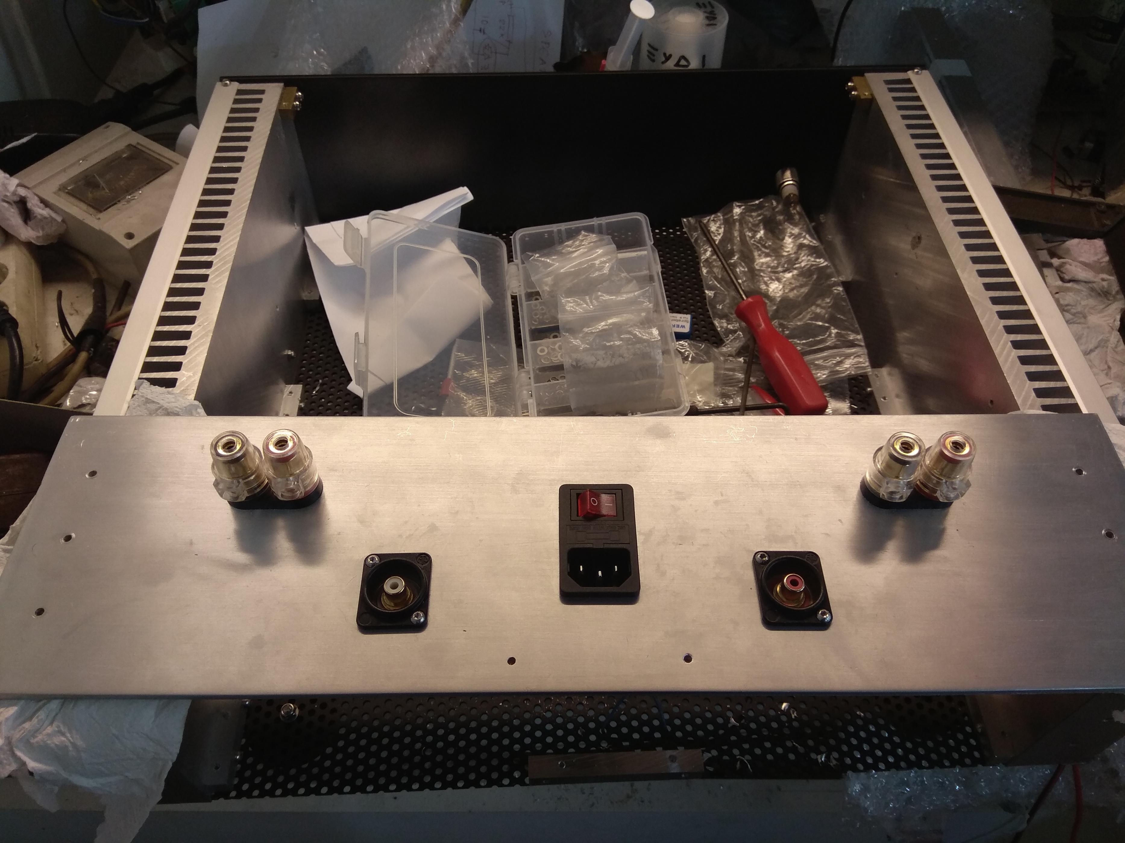

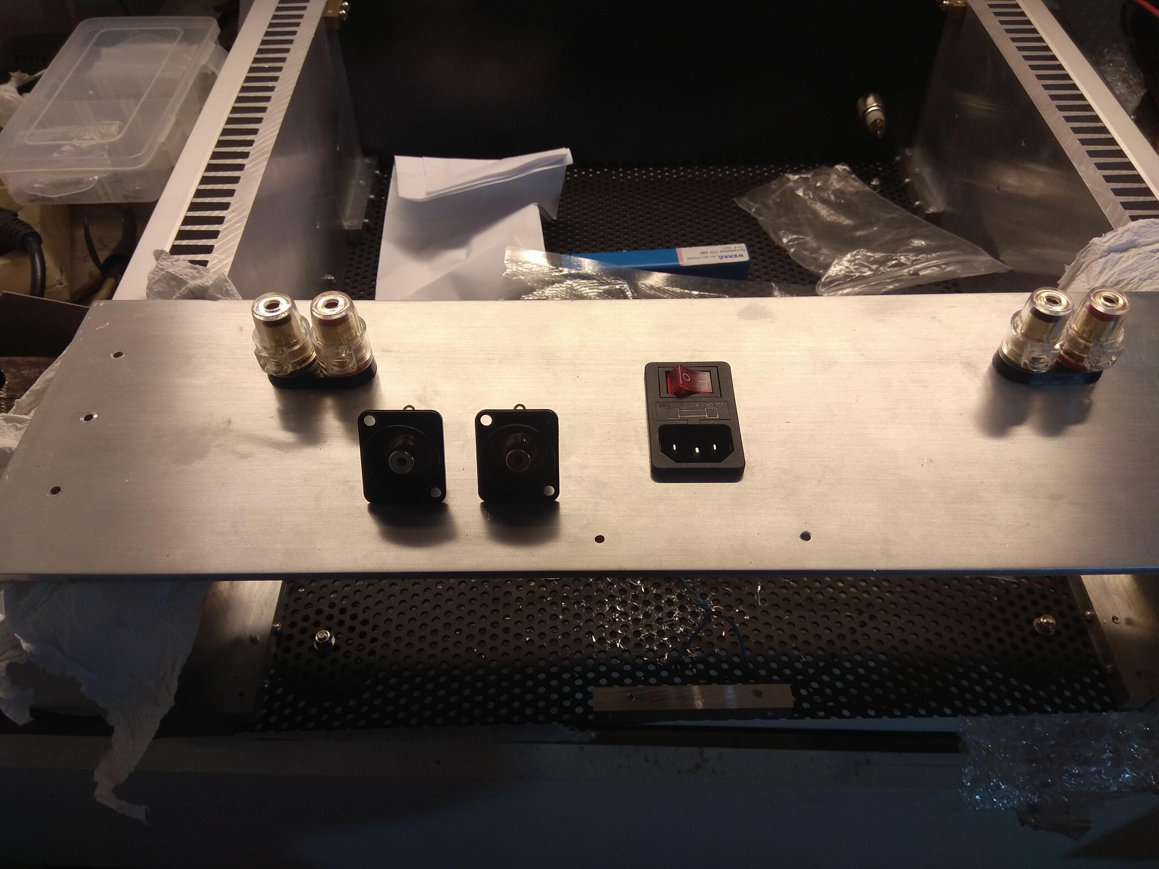

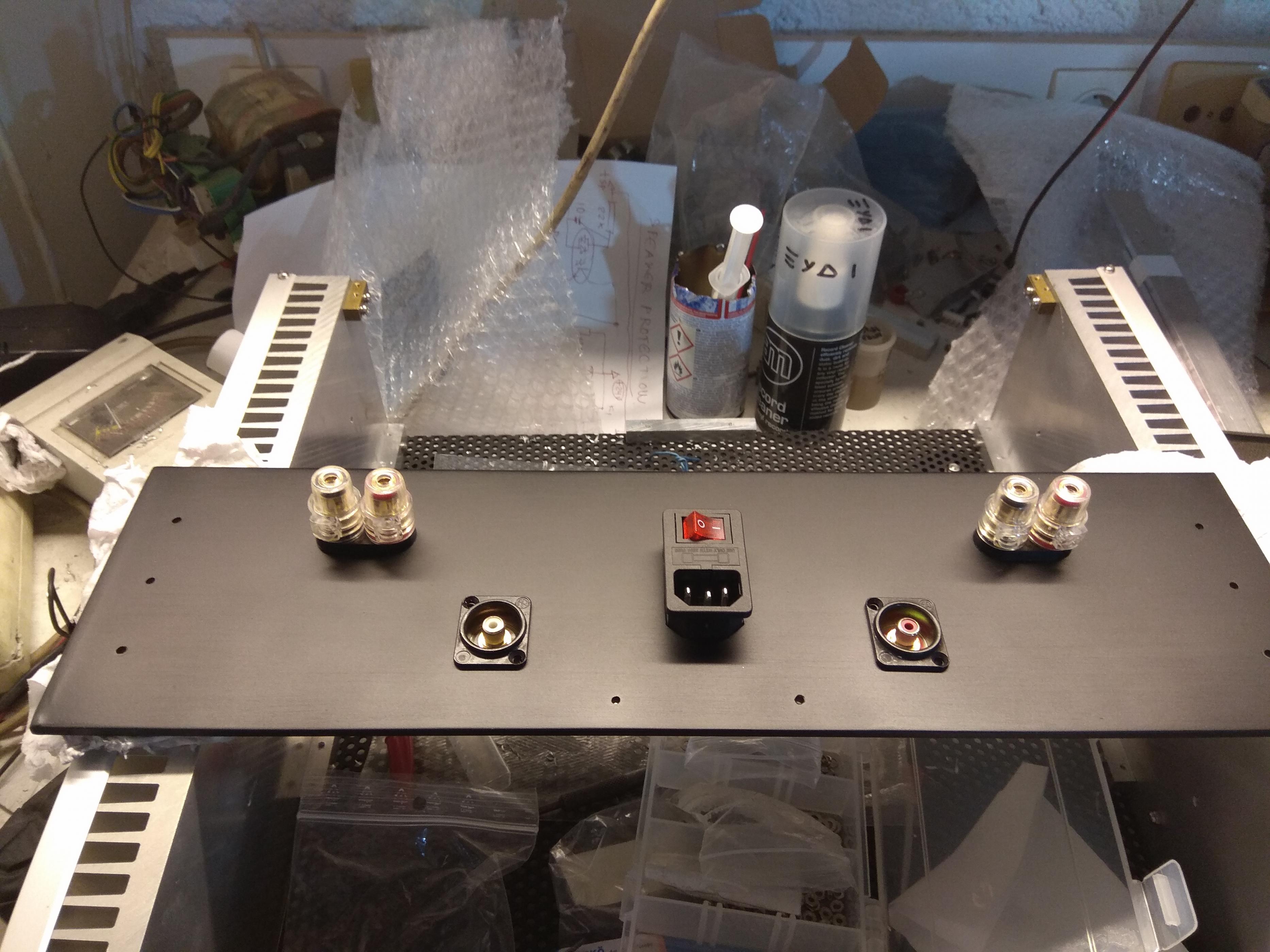

What is better RCA position ?
Like picture 1 or picture 2?
I see commercial amplifiers putting, R&L RCA closed each other.
Short common GNG.
This can eliminate the hum.
Short common GNG.
Thimios, I prefer the 1st option, build all my amps like that, never had hum.
That is my way too but let's wait for a while.
Thanks Valery!Great job man!

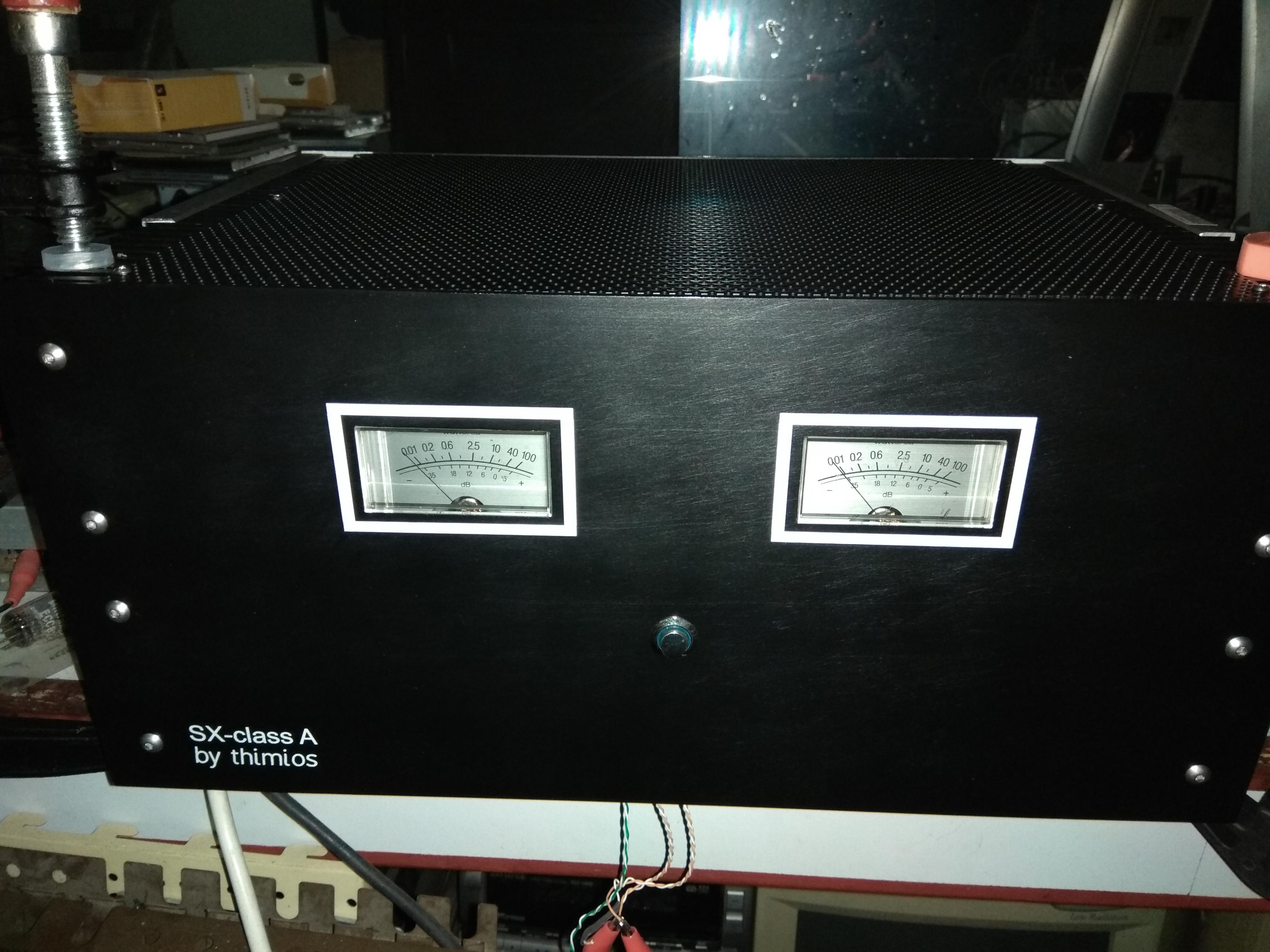

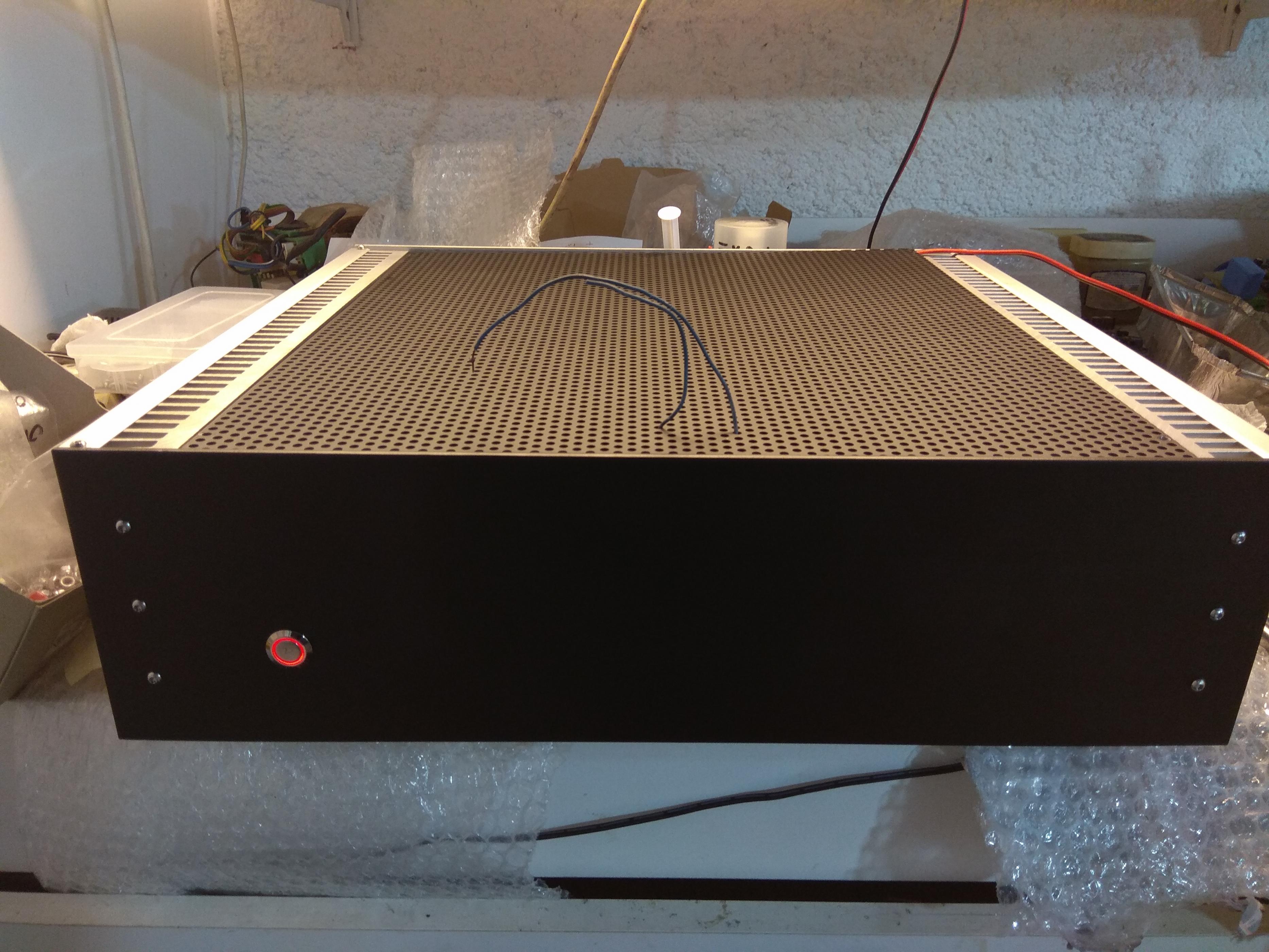

After the final layer willbe the lettering procedure like this.
