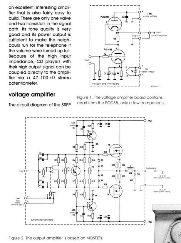

Hi all!
Please let someone views the original scheme Hybridnog amplifier with PCC88/(2SK176/2SJ56) from Elektor 1997.
Thank you
I have found an old article about the Hybrid from Elektor 1997 August.
I attach here a picture with simplified schematic.
But you have to guess the values of resistors.
So, if you want some details, you have to search the web for more information.
I could send you the full article in PDF, if you give email.

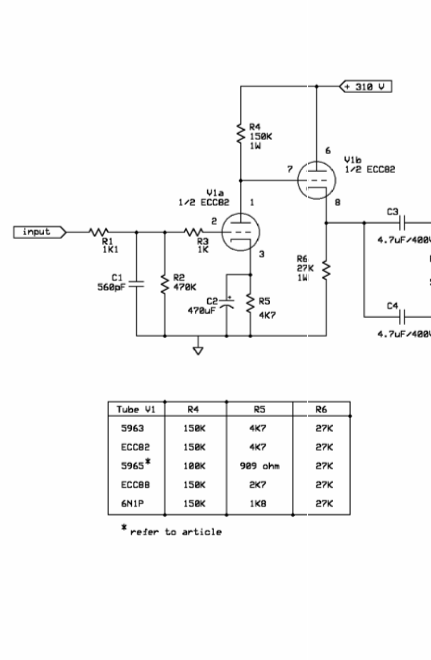

I finally got this built and am quite pleased with the result, I am using 6n1 tubes in this setup:
R6 turned out to be 32K instead of 27, what would the effect of that be?
Also I have a slight hum, nothing too bad but what can I do about that? Pin 9 (grid) is as yet not attached to anything...What can I do with that?
Any comments are appreciated!
