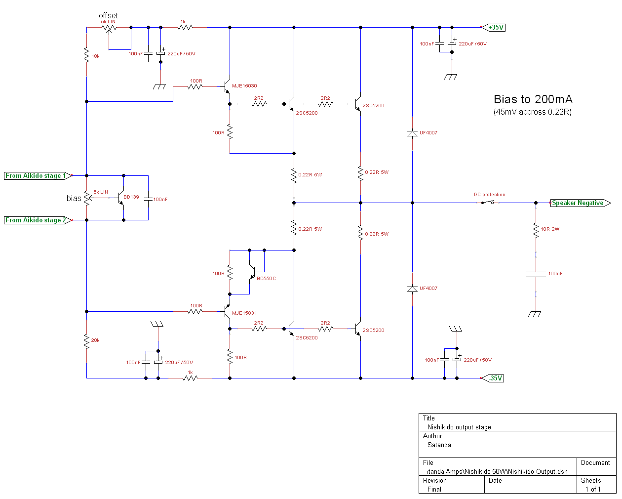

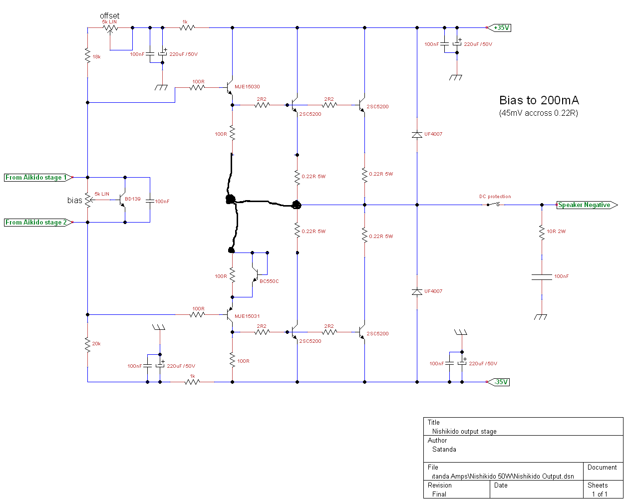

is this proper way how to implement parralel output devices?
That doesn't look right. Rather connect the 100R resistors to the output node.
