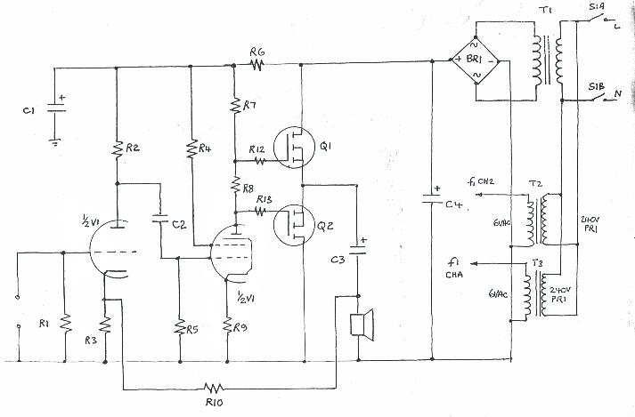

He will build the Nishiki Hybrid Amplifier = the real topic 😉
http://www.wdehaan.demon.nl/hybrid/nishiki/index.html

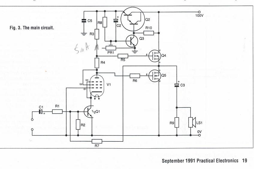

Neither of the above are very good, they both generate quite an excess of heat from the output stage because of the limited swing of the tube stage, they both generate a rather big thump in the speaker when powered on, and they both use their tubes in suboptimal conditions because they try to use the same power supply for the tube and SS stages.
