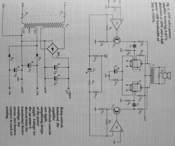

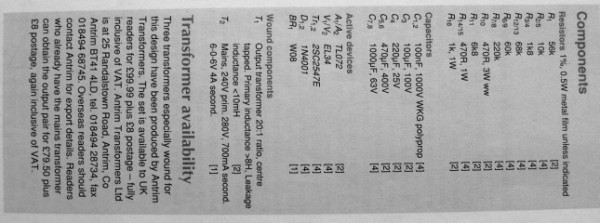

smoking-amp said:
I was reading some stuff over at John Broskie's Tube Cad Journal and there is a mention of an interesting hybrid published in Electronics World, October 1995 by Jeff Mcauly titled "Hot Audio Power" The only library around here that carries the magazine has the page turn out of it. :xeye:
Anyone happen to have a schematic for it?
Don

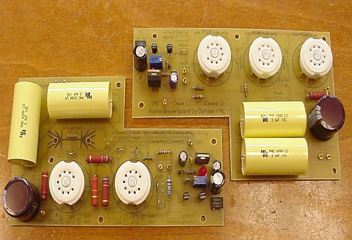

I will update my website regarding the Nishiki Hybrid design begin january or so and I will post the complete circuit. But until than people could (should?) buy the AudioXpress if they are interested or buy for just 20 euros the complete manual including a complete set of datasheets as mentioned on my website.
At that time the Pioneer version will be finished (this project is slow because my time is limited these days). I made a circuitboard that excpets either a 5965 or 6N3P as long-tailed with CCS and a 6N1P as cathode follower. Board is made in such way that you can use also a current source (IXYS) for the cathode follower. The final amp will use a complete PC88 circuit (photo attached). The PC88 is not a ECC88 or PCC88.
Other thing why I don't mention all details on my page is the fact that I made an version with better specs. Sound differs, because the used driver tube is very suitable for audio. Driver stage is different and output stage yields 100 watt into 5 ohm at 0.3% distortion (output stage set to +/-38VDC), this with no overall feedback. Some known magazine is interested to publish it and it will maybe be published, will know this in some weeks I hope. Project will be including a very nice professional housing all for a very interesting price; the intention of the project, good sound for good money
So stay tuned and please be patient, if interested of course 😉
Wim.
www.wdehaan.demon.nl/
