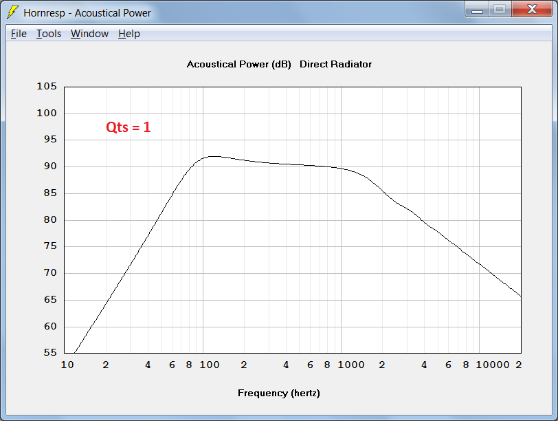

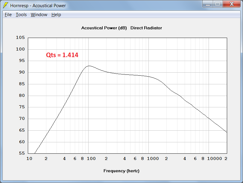

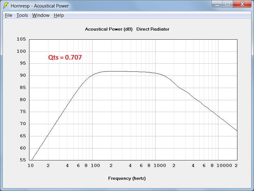

.707 is a reasonable compromise between frequency response, power handling, size and all the other variables.
Excellent illustration and from "the horse's mouth" no less.
But I suspect my conclusion in looking at those swell pictures is rather different than David's. I'd say anybody knows the Q=1.4 will sound the best (assuming the bump is deep low enough). Or maybe Q=1.
Something that looks flat to your eyeball isn't necessarily something that sounds right as a subwoofer. And that is a message for the sim-lovers.
Anybody want to dispute that?
There's no magic (or even reasonable compromise) in ".7". It is just a mathematically convenient number. (Hint: it has something to do with the square-root of 2.)

You quoted me saying ".707 is a reasonable compromise between frequency response, power handling, size and all the other variables."
I was talking about qtc so I'm not sure why you showed a qts comparison with that quote.
However this does illustrate a good point - contrary to what Ben thinks there is no "whomp up" at fs unless driver qts is quite high - a value of 1 or higher. It was in the church organ thread where Ben went on about the "whomp up" and would not believe my illustrations of qts effects, would not believe weltersys when he said there was no "whomp up" and where he asked for a decisive ruling on the matter despite plenty of evidence.
The more you type the more you reveal you don't know what you are talking about. This shows a comparison of driver qts, not system q aka qtc. You can tell by the way the midband efficiency (the higher frequencies) drops with higher q. Oh, and the graphs are also labelled qts.
Yes I'd like to dispute that but it's hard to know where to start, there's so many problems with this.
First, there is no driver I am aware of (probably no driver in the world) that will have a qts of 1.4 combined with flat response down to fs combined with an fs low enough to put that bump "deep low enough" as you say. If the driver did exist, the sensitivity would be horribly low and since high qts drivers are almost always very cheaply made it wouldn't have enough power handling to overcome the low sensitivity and provide any kind of decent output.
Second, a driver that is flat down to fs and having a bump at fs like the 1.4 qts graph will sound absolutely terrible in room as Kravchenko pointed out. It will boom terribly, sound "slow" and have all the characteristics that you attribute to resonant enclosures like tapped horns.
There's no problem having a bump at low frequencies, in fact most people will prefer that type of house curve, but having a flat 2 pi response all the way down to the bump will sound terrible in room.
Ben
Again, you couldn't be more wrong. The reasonable compromise in a .707 qtc is exactly as GM explains. It's a "max flat" alignment, providing the lowest possible f3, a reasonable enclosure size, a reasonable power vs excursion level and reasonable compromises in all other areas. This means the .7 qtc enclosure could be expected to work reasonably well in a variety of different environments for a variety of different purposes.
On the other hand, if you have a very high qtc (like 1.4) the box will be incredibly small but f3 will be very high and with very low qtc (like .5) the low frequency efficiency gets better but box size gets way out of hand quickly so the potential usefullness of the alignment is limited to applications that can handle a very large box size.
Respectfully, a couple of dbs extra south of maybe 40 Hz (and we are talking about good subs here) would typically sound real nice, not boomy and not sound one-note'ish.
Ben
