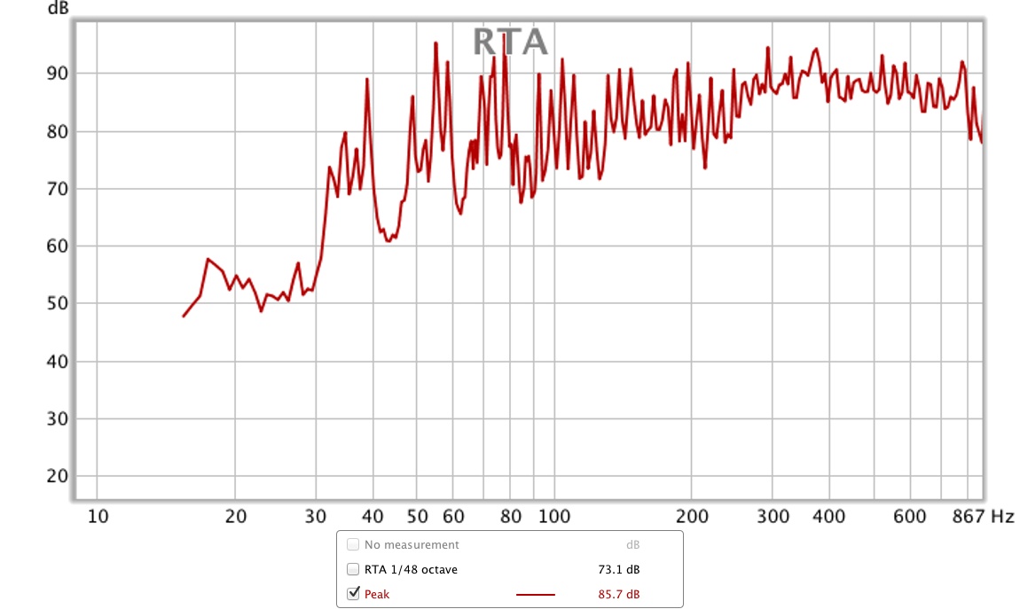

The Cassavant family make beautiful organs - biggies as well as great tracker instruments. And the recording may indeed be profound (although the concert hall acoustics are strange to the ears of regular church organ fans).
But YouTube clips are quite another story.
The sound is wonderfully full and organ-thrilling. Maybe esp nice without church reverberation. That may come as a surprise to those who think going down to 16 Hz is necessary to their happiness in life because this great sound is really coming at you at 55, 41, and 48 Hz with some at 32. But it just ain't low. Dunno if YouTube cut off the low bass or what.
Ben

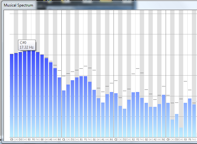

During the Quiet section towards the end there is some serious soft thunder.
I just missed the peak but you can see how high it got.
And again close to the end. Because of how the chords progress in the music the very end chord is not the lowest. Helps if you can dig up the sheet music and look at the score as you are looking for the lowest notes.

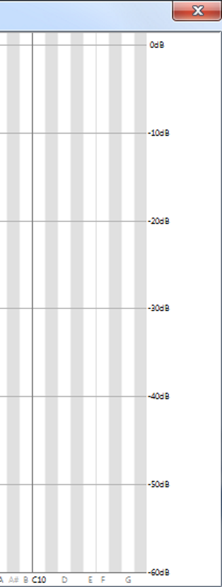

And a look at a blow up of the vertical scale.
It's 10 db per division on the vertical scale. The loudest low notes are almost 40 db louder than the orchestra at some points in the quiet section.
And the orchestra is pretty darn loud to begin with.
In the ending the organ still smacks around the orchestra by 10 to 15 db. 10 db is perceived as twice as loud. But power output is considerably higher.
If you play this at concert levels it is real work out. And can be pretty good at creating shredded woofers.

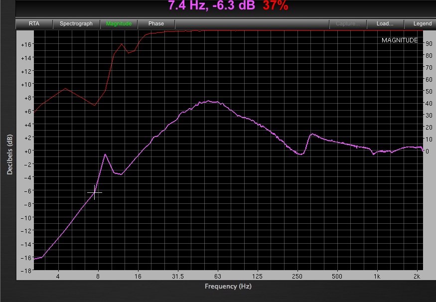

Although there are no portable live sound systems capable of 7 Hz reproduction at near the relative level present in the "Bass I Love You" track, the headphones DJs and recording engineers typically use for monitoring are capable of going loud and low.
An example is the Sony MD7506, about -6 dB at 7 Hz.
Art
Art
