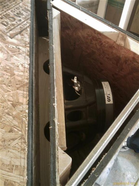

Sealed box in back of driver?
You mean like this?
A rear chamber to anull the reactance that stops woofers from flapping wildly in the breeze below their pass band?

You mean like this?
Never heard of it!
Mark
You mean like this?
Never heard of it!
Mark
Mark - hard to tell from a picture, but I think yes. Is that a cross-section picture of a true horn?
By "never heard of it" do you mean "yes I've heard of it"?
Do I gather correctly you think control-of-flapping is a good idea?
And your opinion of Doppler, etc?

That is the rear chamber of a true horn. A twenty three foot monster that I recently built. It's good down to 16 hz. With the proper volume of air behind the woofer you get a nice roll off below the woofers pass-band. Takes some calculation but it is not to hard to figure it out. When done right it acts like a shock absorber on a car. They are there to dampen spring oscillation in your vehicle. Without shock absorbers or strut assemblies that have an integrated shock the car bounces all over the place. When the shock absorbers are functioning correctly the springs in the suspension bounce and are dampened out almost immediately. Same goes for a properly sized rear chamber on a front loaded horn. Unwanted cone flap is dampened out very quickly.

Big box. The one in the picture is the 23 foot horn it is 16.5 " x 32" x 92". Only addicts may apply! But once you hear one of these brutes all other sub-woofers sound.....neutered is the best term.
