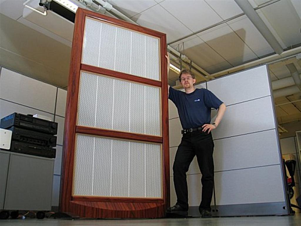

Home Page of Arto Kolinummi, Audio
Check out his fullrange ESL and stepup transformer. This is one guy I like. And he is quite open about helping you work on a copy of his design. THe transformer your on your own though. But if you have enough readoing time and some persistence it can be worked out.
