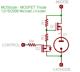

UH-Ohhh I can hear chopper sounds outside. OH-No..... They took my box! Darn!
Well they didn't get the $2 dollar ones at least: (a common high gm video amp tube in triode mode, see attached)
I'll give you a hint on the mystery "tube", it uses Schading and has a 6DN3 damper in series with the "cathode".

Yes, thats basically it. I didn't bother with the source follower on the input, just the resistor r2, since the curve tracer has a low Z step generator for testing bipolars too.

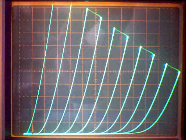

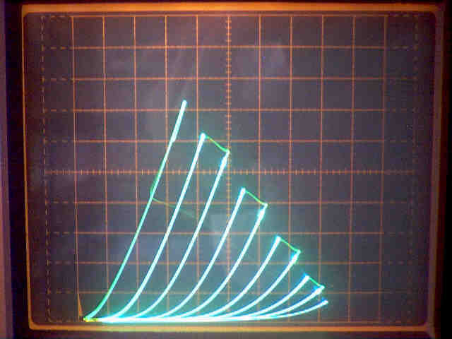

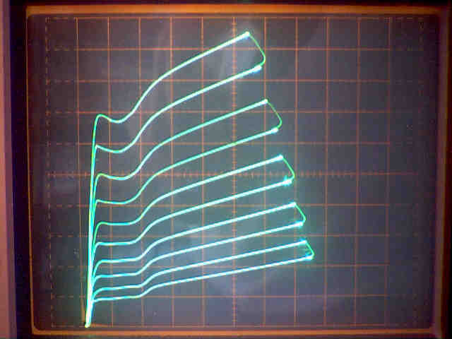

And speaking of 12AT7, here it is:

That was the FET (FQP1N50) setting on a damper diode (6DN3) with Schade feedback from drain to gate. Like Michael drew. The Schading gives it "plate" resistance and the diode gives it nice 3/2 power law curves like a triode. One might also be able to use a Schaded and degenerated Mosfet down bottom, in place of the diode, to give it square law curves which would look more like a power triode. Putting just a resistor down bottom makes for tilted straight line curves.

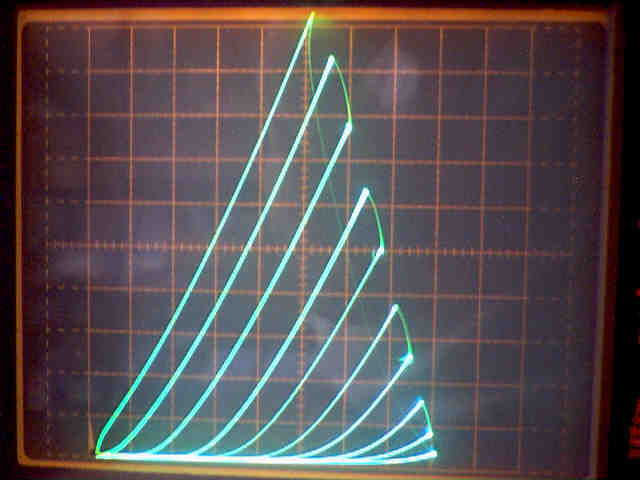

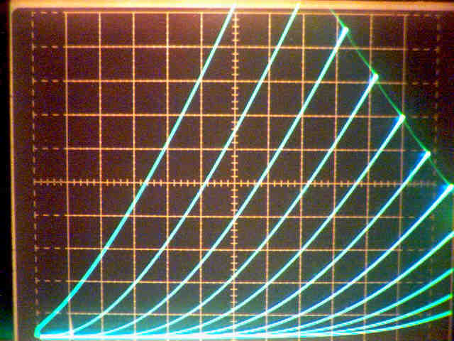

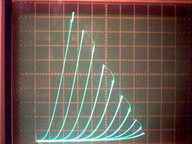

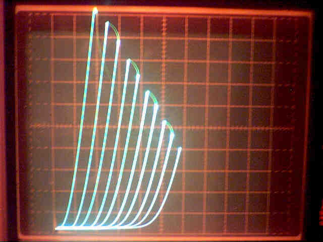

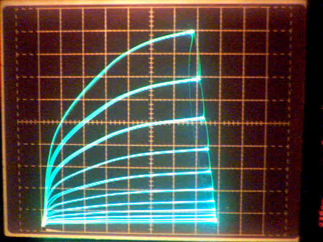

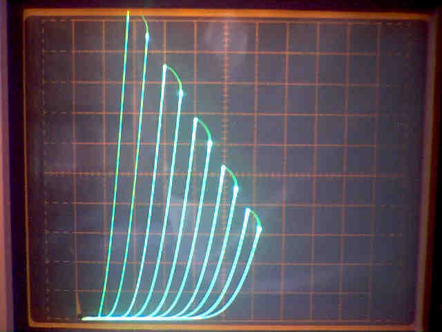

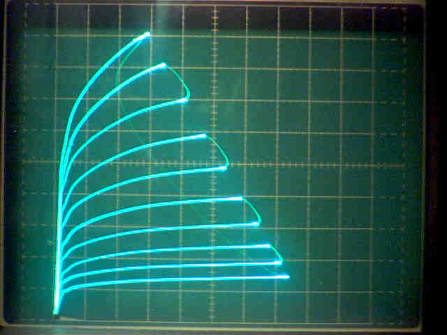

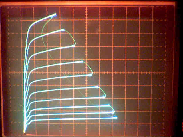

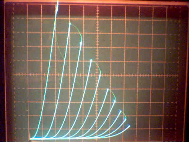

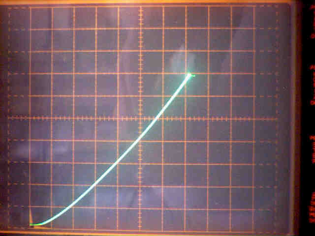

A lot of triodes look pretty similar on the tracer except maybe for different step voltages or V and I ranges, unless they are stand out non-linear ones. Here are a few device plots, usually with some distinguishing features to give some hint. OH, I likely grossly exceeded the max Watt diss. on some of these to get a more complete curve set.
A: 200V /div. horizontal scale, 10 mA / div vertical scale
C: DHT 50 V/div horiz. , 2 mA/div vert.
D: section #1 50V/div horiz., 1 mA/div vert.
F: section #2 50V/div horiz., 10 mA/div vert.
(sections #1 and #2 above are from the same bottle)

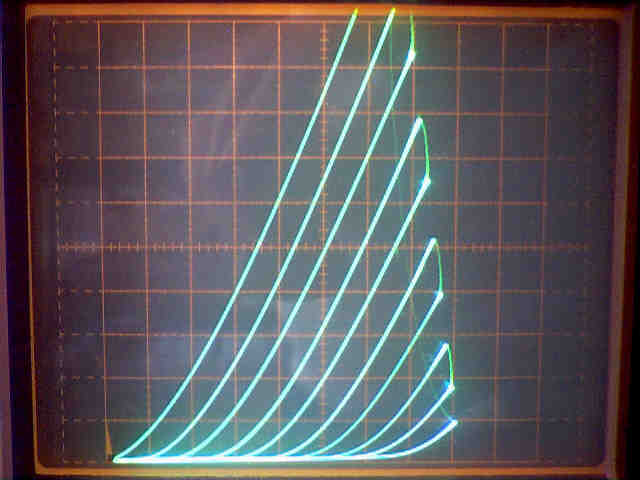

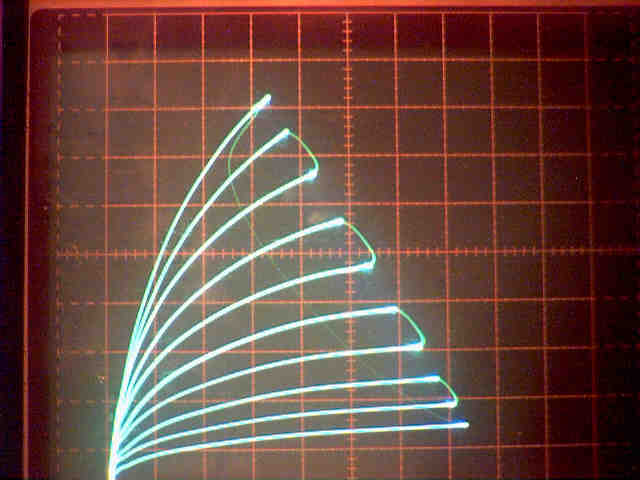

Here is another tube, pentode + ?.
G: pentode mode 50V/div horiz., 20 mA/div vert., g2 at 120 V

Notice how the really ugly pentode curves turn into rather nice triode curves. Also, the data sheets for this tube I have seen do not show the nasties in the pentode curves near the knees. But most of the samples I have tested do have this to some extent.
