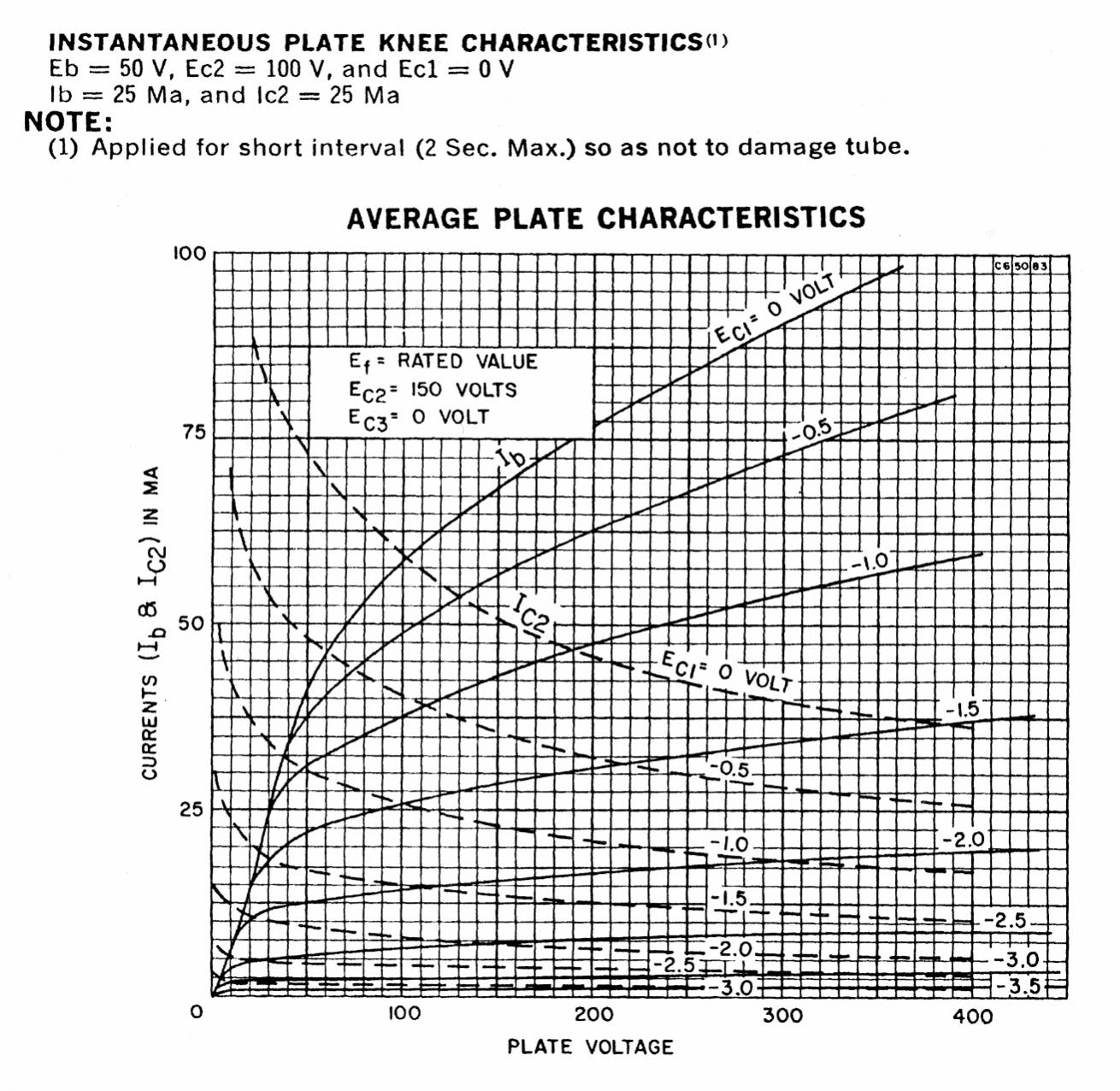

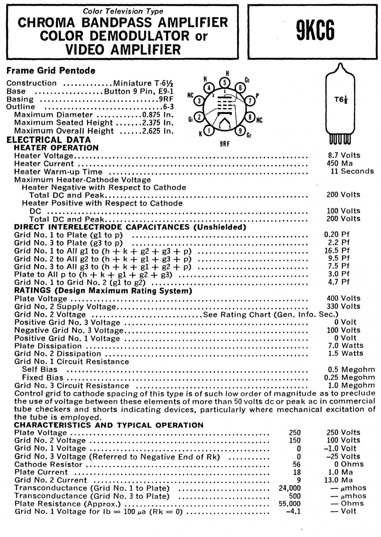

Does each cell voltage and current value is the number?Lets see what 9KC6 and 6LE8 look like in triode mode:
Again, I don't have the data anymore. But from looking at the datasheets I would guess around 0.5 V/step for the 9KC6 and 1 V/step for the 6LE8.
6LE8 datasheet:
http://frank.pocnet.net/sheets/135/6/6LE8.pdf
9KC6 datasheet in the 1968 Sylvania Receiving Tubes Technical Manual.
6LE8 datasheet:
