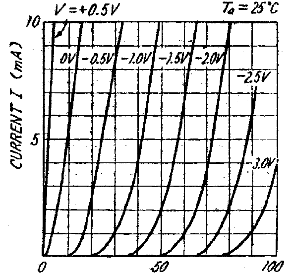

Guess no one could figure out the mystery tubes in post #53 and #54.
For the record:
A: 6JK5 beam triode, main clue was the 1400V horiz. axis range
C: 19 DHT triode, clue being the DHT and very small current scale
D: and F: 6GF7 dissimilar triodes, limited # of dissimilars to pick from
G:G2:G3: 38HE7 power beam pentode combo with a damper diode, the low Rp of the pentode
curves gives it away. Notice how nice the triode configured curves are.
Probably the best 16 Watt triode around for the $0.35 it cost, or even for $1.

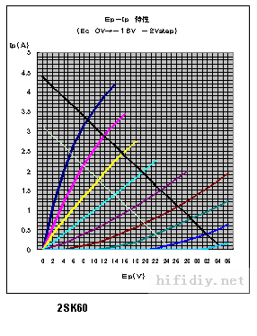

Think back, I showed a Schaded IGBT atop 5V4GA. Calling the top portion a "Mu Starver".
Cause my thinking then it was a linear amp starving a vacuum diode to produce curves...
My complaint that it was still too darn linear, and didn't lean over to the right like a real
triode! Which led to the discussion with Smoking, where he proposed an average of triode
paths with slightly different cutoff caused the leanover... Then I go on to sim dissimilar
Mu Starvers in parallel to see what happens? Need at least four to fake realistic curves.

Does each cell voltage and current value is the number?Lets see what 9KC6 and 6LE8 look like in triode mode:
Again, I don't have the data anymore. But from looking at the datasheets I would guess around 0.5 V/step for the 9KC6 and 1 V/step for the 6LE8.
