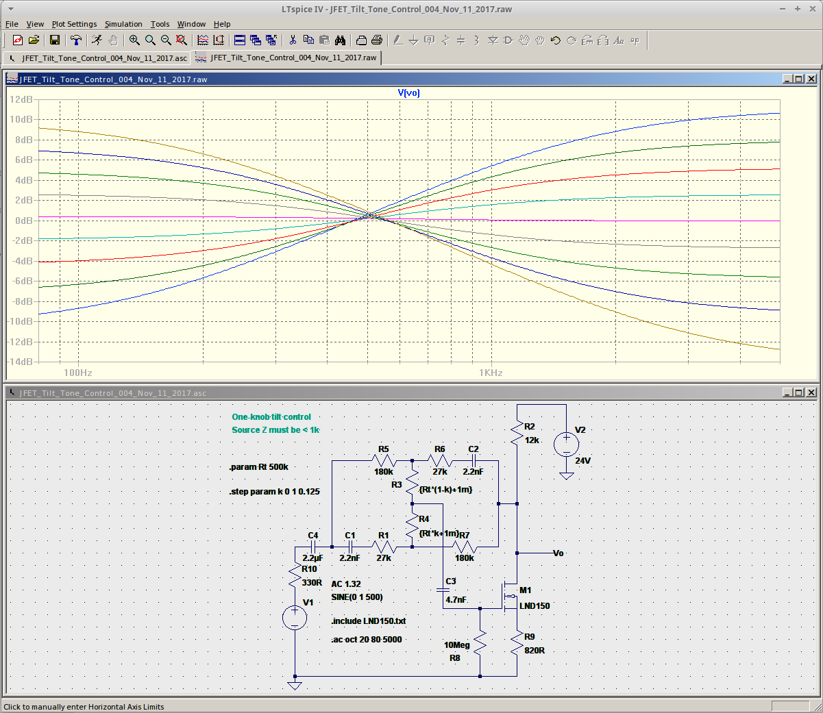

I'm attaching a simulation of the one-knob (tilt) tone control I mentioned earlier. This is an active tone control, and I used a JFET in the final build. The attached LTSpice simulation shows a MOSFET, however, and this works equally well.
This particular MOSFET will also handle several hundred volts, so it can easily be used in the middle of valve circuitry if so desired.
As with any active tone control circuit, it must never be driven into clipping. The trick is to put some sort of fixed two-resistor attenuator ahead of it, arranged so that the preceding stage reaches full clip (and full output) without the tone control itself being driven hard enough to clip at all.
As the curves show, this tone control has a flat response at the centre setting (it doesn't change the existing tone of the amp), and progressive, smooth, symmetrical curves as the knob is turned off-centre. It's great for making quick and easy adjustments to the overall tonal balance.
(But that's all it can do - you can't dial in bass boost alone, or mid scoop, or both bass and treble boost, and so on.)
Incidentally, this circuit has no insertion loss at the centre frequency, i.e., it has unity gain there. That makes it a good choice for use in an amp that doesn't have a lot of extra voltage gain to throw away - as long as you're okay with the limitations of a one-knob control.
-Gnobuddy
Ideally, but I have high expectations from a tone control. I wanted this one to have a flat frequency response with the knob centred, and symmetrical curves around that point. I used it in a solid-state preamp, where it was easy to achieve such a low Zout."Source Z<1k"
It needs to be driven by a tube or FET 'follower' then?
It's not so easy in a valve preamp. How does that affect performance? The attached image shows what happens if the source impedance is 10k. The curves now droop by a decibel or so at the right end of the graph. Not quite symmetrical any more. But a decibel of droop is a very slight thing, probably inaudible with guitar as the source signal.
In other words, even with the droop, this tone control still produces far smoother and more symmetrical curves than you can get under any circumstances from crude passive "tone stacks" like the one that was invented for the Williamson amplifier, but which became known to guitarists from their use in Fender amps fifty or sixty years ago.

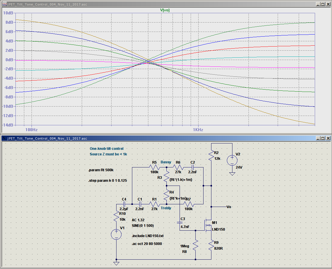

What if Zout is even higher? Typical Zout for a half-12AX7 with a 100k anode resistor is around 40 kilo ohms. With that high a source impedance, the droop increases to about 5 decibels across the entire width of the graph.
This is still easily compensated for by simply turning the knob to tilt the response the other way. But now the amount of boost and cut are not equal on the treble side, which isn't what I wanted (though the circuit is still much better behaved than the FMV "tone stack".)

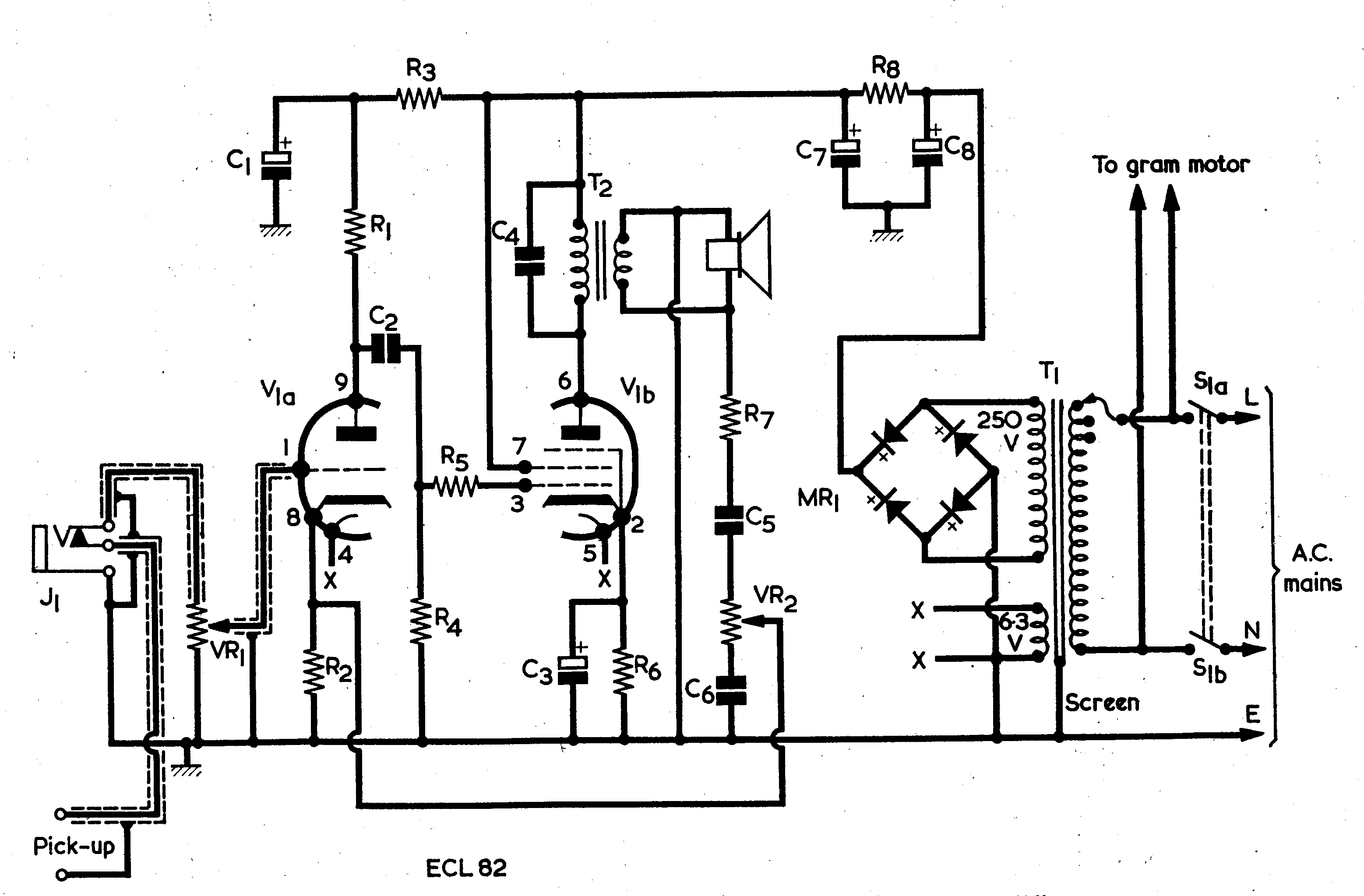

Progress report on the "one valve guitar amp" project: I can tell (from previous posts) I am treading a well worn path but this is where I ended up:
1: You can't quite make a one valve amp with an ECL82. You need more gain. If you want a conventional tone stack as well, you really do need more gain.
I'm limited by my 10w power transformer so I can't add a second valve, and anyway that would be two valves. Mostly it is the extra heater current.
So, in the spirit of engineering compromise I fitted a FET front end. Hey, rules are made to be broken, and anyway you can see the valve loud and proud. The FET is hidden where no one can see it 🙂
The FET provides gain and a moderate output impedance. This also allows a Fender blackface tonestack to go in before the volume control. Now a guitar pickup can push the amp properly.
2: I was able to reduce the triode anode resistor. I had pushed it to 180K but I felt that is just a tad too high, so now its 120K. This seems to clean up the amp at low levels.
3: I played with 2K on the screen grid feed (unbypassed) but the results seemed a bit harsh - so I went back to 200 ohms.
4: I have added a three position switch in the feedback loop. Position one is clean lower gain with quite a bit of feedback. Position two is Marshall mode - more gain with lower feedback using diode bending to simulate early breakup, finally in position three it can be Vox mode with no feedback. All three positions have some merit, though I find the "Vox" position a bit harsh. Pentode clipping seems to happen first at the positive excursion of the waveform. Increasing the bias current raises the clipping point, but I don't have much spare current I can give it.
5: I'm using the pentode cathode as a power supply (at 19 or 20v) for the FET front end. That seems to work just fine, with extra decoupling. In fact I put a LED in the feed so it slowly lights up as the amp comes to life. Cool touch 🙂
I'm testing it with a Fender 8 inch speaker and it sounds OK. However I also tried it with my 12 inch Greenback and it sounds just excellent (and a lot louder).
When I have settled on my values I will start a new thread and put the schematic up.
