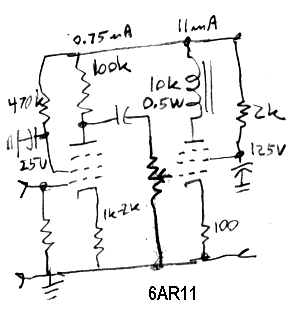

The attached seems to be a HIGH gain single-bottle amplifier with some pretense of power. By thumb-count the (bypassed) gain is 5mV input for full half-Watt output, which is generally more gain than you can stand. Hence I drew it unbypassed and expect 20mV sensitivity, which aint bad. However this is a HEAP of gain from first grid to power plate, and maybe can't be stable.
http://www.mif.pg.gda.pl/homepages/frank/sheets/123/6/6AR11.pdf
The 'power' stage runs essentially at book values. (B+ is 150V) The 1st stage runs much lower current for more voltage gain. Yes, Vg2 is very low. (G3s strap to cathodes.)
Gnobuddy is quite right. Long tailed pair and class B don't belong in the same sentence. Power output and LTP don't belong together either.

The 6AR11 twin pentode looks fun, and they are not too expensive. But they seem to be signal devices not power devices. Nice idea though.
