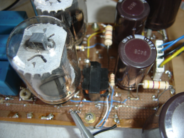

There are two kinds of feedback: negative or degenerative, and positive or regenerative. Both can be current or voltage loops.
Usually a positive voltage or current positive feedback is inside a negative global negative feedback, and has been used extensively in the era when obtaining high gain from a single tube was mandatory, and opamps chips were only a dream. I can help, as I am making a tube amplifier with positive current feedback as in the 50's with good results.
Hi Osvaldo, may I ask you how you managed it? I know from old (1950ies) German magazines that positive current feedback serves for minimizing an amplifier's output impedance . One may even make it negative when exaggerating the PFB. The main issue appears to be the varying loudspeaker impedance, which makes finding the optimal FB rate almost impossible. After all, I suspect that this kind of FB is not what the OP is after :).
Best regards!
You can manage the loop response to maintain PCF only at low frequencies around the bass resonant frequency of the loudspeaker(s). In my current project, I used a current transformer with the primary in series with load, and the secondary tuned with the parasitic winding capacitance and (possibly) any other added at hoc and that it becomes inoperative or NCF at medium and high end. This idea is robbed from industrial environments where current transformer are used extensively.
This is partially my design currently working pretty fine. In the schematic there is omitted a 22Ω in parallel of the transformer's secondary. No cap still, but I don't know in the final project may be one of them.
Also the idea is robbed from here.I found scanned the original article.

I tried it in my amp, but it seem to be unusable. All set becomes unstable with signal.
