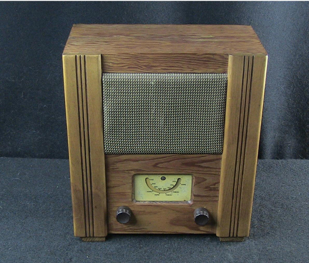

Yes I remember... I grew up with valve radios. The warmth, the smell, the wait, the hum... Lovely.
This wartime civilian wireless set formed the basis of my first diy record player. The RF section had long ceased to function, but the audio amplifier performed remarkably well when fed from the crystal cartridge in my Garrard SRP 10 turntable. This was my introduction to the world of diy audio as a young teenager. Happy days! 🙂
Wartime Civilian Receiver
