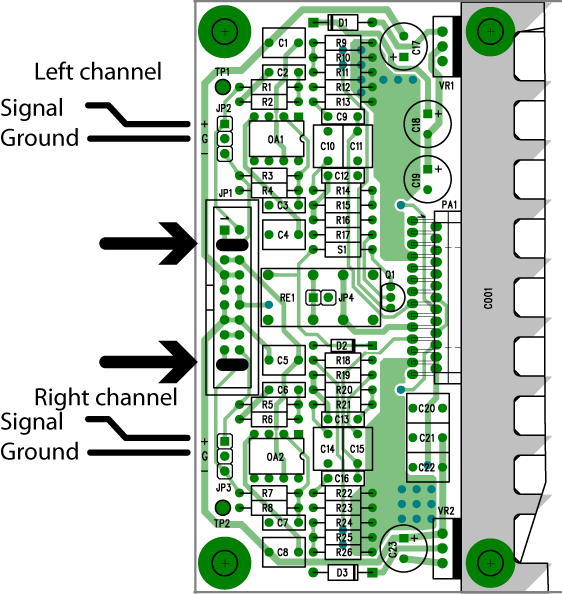

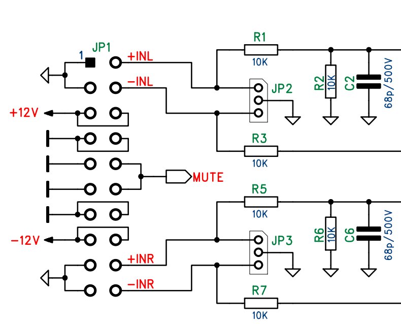

I think you will discover why when you start soldering. I recommend that you take a look at the schematics. There you will see that +INL, -INL, +INR and +INR shall be connected in a certain way. You must always have two jumpers so also connecting the input wires there is a bit hard.I'm a bit confused about the input connection in JP2 and JP3, though.
Why all of you guys soldered jumper pins here? Can't you just solder the inputs directly to these points?
Thanks, clog. The image you posted showed me how I'll connect the input wires.
I was going to replicate the connections from your build anyway.
But I always try to understand things first.
The schematics and the text explanation from PD's documents are still unclear to me.
I'll just follow the image and I'm sure it will sound great.

IMHO you can solder the input signal wires directly to the ports, but i guess it adds more flexibility to play around with the configuration if you use the pins and a propper connector to connect the signal cables.
