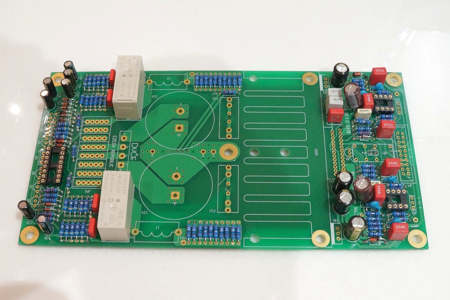

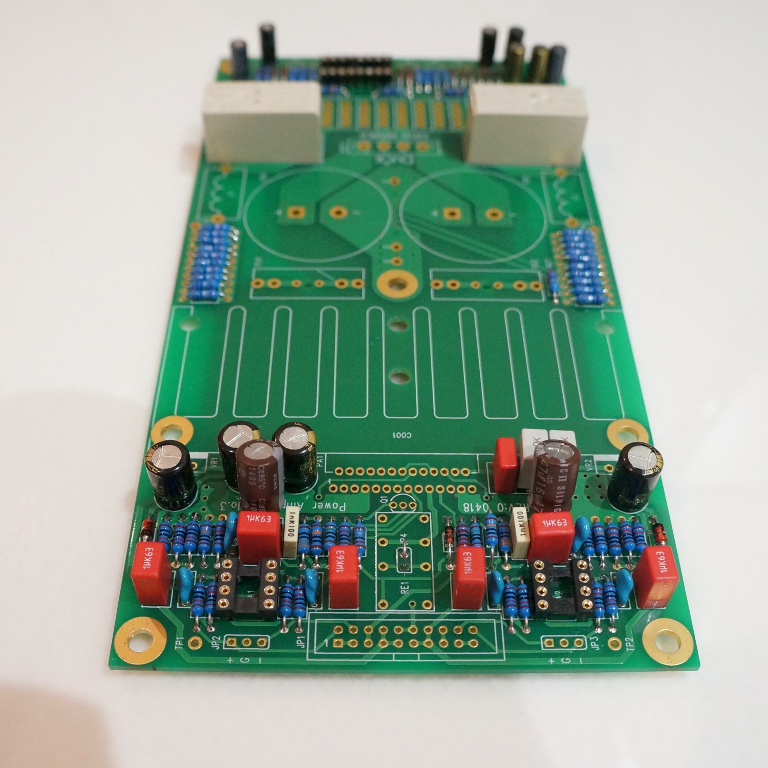

Work in progress here.
Started yesterday evening and very few parts still missing on the board.
Free time gets scarce when you have kids in the house.
As you can see, I hard wired jumper JP4. Will do the same with the inputs at non inverted mode.
Also, on C11 and C15 I opted for the 47uF electrolytic as recommended by Dudek for normal stereo operation.
On C12 and C13, PD specifies 1nF/500V "kerko", which probably means ceramic.
I used metallized polyester 1nF/100V. Do you guys see any potential problem?

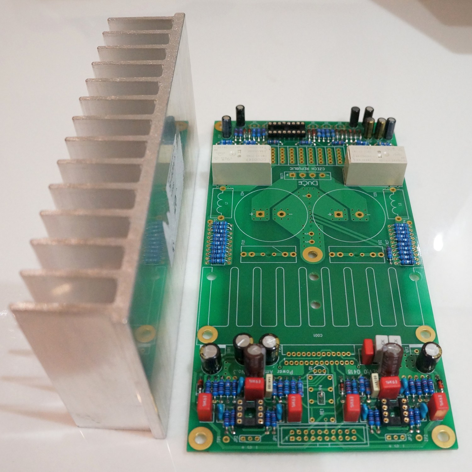

How about the heatsink? I still can't figure out how to attach this heavy piece to the PCB.
Any suggestions?
I'll post more pictures (and questions) as I progress.

Most people screw the heatsink to the board. There are two holes for that purpose.
.................How about the heatsink? I still can't figure out how to attach this heavy piece to the PCB.
Any suggestions?
Thank you very much!
The two middle existing holes will be under the narrow fins. Twp more holes out at the ends of the sink but also into the narrow fins. Not much good for that shape of heatsink.Most people screw the heatsink to the board. There are two holes for that purpose.
Tap two 3mm holes into the edge of the heatsink backplate.
Attach using plastic/nylon screws.

Andrew is right, the heat sink base and fins doesn't align with the PCB screws.
I'll attach it to the chassis floor as suggested. But do I have to isolate it with nylon screws? I'm not sure if nylon will give it a tight grip.

The holes in the middle of the heatsink dont need to align with the fins. I guess they are for an alternate way to mount the heatsink. I think you could use a metal plate on top of the heatsink and long screws or a threaded rod.
But I went for the two holes at the edge of the PCB. You will need to drill holes and cut threads into the heatsink for that. I used M3 screws, despite also M4 screws would have fitted. But you will nyways need M3 screws for mounting the voltage regulators and the amp chip. So no need for bigger drills and thread cutters.
To keep things simple just look at the pcb. The heatsink is clearly outlined on the board. To the left and to the right there are mounting holes that correspond with the base plate of your heat sink. Both mounting holes are isolated. I tapped M4 threads in the base of my heat sink and fastened it with steel screws and washers. There is no need for nylon screws and washers. On the contrary it is weakening the connection. Ragerino is right about the LM4780. For better heat transfer you can decide to mount the LM4780 without insulation. That's what I did. But in that case the heat sink is connected to the negative power supply so you be careful. Speaking of heat transfer. At times I played my music almost unbearably loud. The PA03 never tripped the Build in SPIKE protection.
Very good idea. That's what I'm going to do then. I'll try to brace the heatsink against the PCB using a transverse bar. I hope I can do something visually pleasant.
The heatsink that I bought doesn't match the PCB outline.
I also used a different heat sink, because I didn't want it to have a height of 100 mm which would require an enclosure with an inner height of ~110 mm. I wanted it to be more compact.
Therefore I selected a heat sink with a similar cooling performance which was 160 mm wide, which means I have excess length of 30 mm on both sides. I mounted it with the two bottom screws because this seemed to me to be the best mounting method. I used 3 mm screws with a washer for mounting.

The same here. My heatsink was wider too because I couldn't accomodate the height of 100 mm. So no problem, use the two bottom screws into the base plate of your sink.I also used a different heat sink, because I didn't want it to have a height of 100 mm which would require an enclosure with an inner height of ~110 mm. I wanted it to be more compact.
