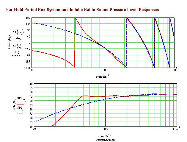

Actually, I have quite a few crossover worksheets. These range from the simple ones that assume a perfect filter loaded by a constant resistance to ones that read in measured driver impedances and SPLs and do the circuit analysis using specified caps, resistors, and inductors. The real interesting worksheet reads in the frequency response of the passive filter components and use those when simulating the system response, if you have never measured the impedance of an inductor you should since it will surprise you big time. The problem with most of these worksheets is that they read and write data files which is a function disabled in the MathCad Explorer program.
Both driver size, XO response, and beaming are simulated in my open baffle worksheet when calculating the open baffle response. For a reasonable calculation, one that does not include every possible degree of diffculty and refinement, I think that this approach does a very credible job and gets most of the answer correct. If somebody wants to track every response ripple the calculation approach is probably is not refined enough.
Baffle shapes other then rectangular will come later, but not too exotic since probably 95% of the DIY designs are rectangular or trapezoidal baffles. Curved baffles will not be considered since only a few would really be interested.
Where and why does the fidelity go?
The math I use is definitely reversible. Not sure what math would not allow the reverse calculation from being carried out to reproduce the original transient response.
I guess my goal is to extend the simple T/S style of calculation out beyond the internal box boundarys to include some of the room environment. Including the shape of the front baffle, the position of the driver and any openings, the floor, and the rear wall sort of made sense as a starting point because everybody has these influences effecting the response of their designs. Maybe I need to add a side wall option because most people will also have this boundary. But once it gets beyond these near boundary influences everybody's room is different. So I am trying to elevate the worksheets to be better than other simple design packages that are available for free or a nominal charge. The intent is to make a big step up in the accuracy of the calculations and to keep improving. There will always be something not included or considered that will reduce the accuracy. The user has to determine if this is an acceptable tool.
I believe the worksheet calculates both effects.
Special baffle shapes could be considered, I plan to add a trapezoidal shape for ML TQWT enclosures. Rounded edges or addition of felt is not considered and at present I have no plans to include either.
At present room modes are not included in the worksheet. However, for a few years I have had a room response calculator that simulates rectangular rooms with different floor, wall, and ceiling reflection coefficients and arbitrary speaker and listener positions. At some point this might be the next level of accuracy for a future upgrade to the worksheets.

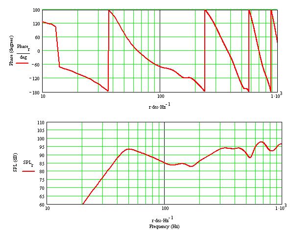

The effect of baffle on frequency response also depends on driver size and XO frequency due to beaming effects.
Additionally, the 2D shape and the surface curvature also plays a role in the smoothness of the response. These cannot be realistically compensated for without losing fidelity. Most engineers that rely on the FR amplitude response too heavily don't realize this.

There are two aspects of baffle design. One is the radiation space, and the other is the additional transient wave caused by sudden lose of support as the wave reaches the edge. The former is considered mostly, and thus the BSC. The latter normally is less considered, and cannot be acurately compensated for electrically.
Another approach is to design round baffle edges, design special baffle shape, or add felt around the drivers in order to spread the lose of baffle support over time. I believe Martins Worksheets may not handle the later approach.
To solve the radiation space issue, I think it's a more simple problem. But you also need to consider first without the room modes, so that you get the right transient wave front, but then there is a tradeoff between the room modes and maintaining the correct transient wave front energy. This is where both need to be considered separately and not just looking at the frequency response charts.
