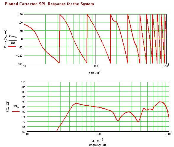

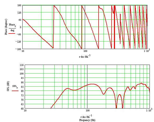

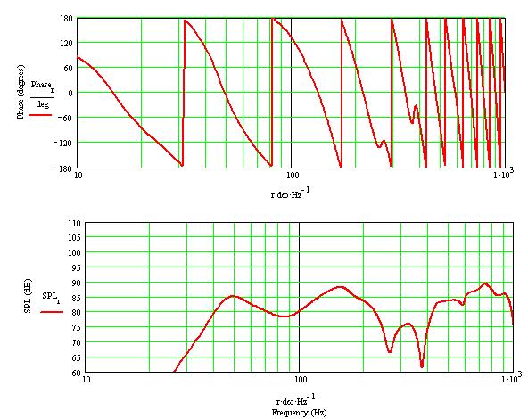

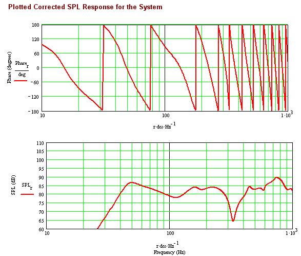

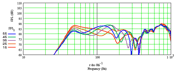

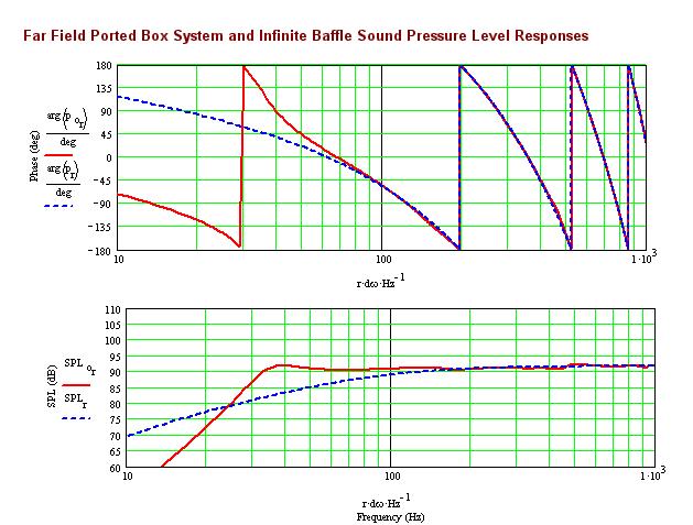

Moving away from the stuffing debate, I mentioned I'd present a bit more on in-room matters. So...
Here's a selection of responses from my Ariel MLTL thoretical design mentioned a couple of pages ago. They all assume a wooden floor, with the listener 3m away on-axis with the drivers. All I have done is move the speaker progressively from being rammed right up against a rear wall, further out into the room. Here's the first response: front baffle 15" from the rear wall. Bit of a suck-out in the mid to upper bss and lower midrange. Interesting double-dip -I imagine the second of these is floor-bounce, as it remains in basically the same place in all the graphs, but I'd be lying if I said I knew for certain -if anyone can put me right on this I'd be grateful.
55" out. (Last one of this series this). To my eyes, this suggests that everything should be in moderation. Note that the double-dip is deeper than at 45" out, and though the bss is probably the best of the lot, it's even more ragged in detail above 500Hz.

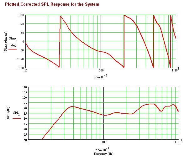

Quick divergence time. I remember hearing comments elsewhere that the F200a doesn't work in an MLTL. Well, assuming the measurements on the Fostex site are correct... it does. Bit of a pain trying to it upon some decent dimensions, but this should do OK. I extrapolated a few of the measurements not put up in the listed parameters, but I tried variations both ways and the basic response didn't alter much at all.
42" line length. 10 1/2" wide, 12" deep (internal.) Driver 12" down from So. Port 4" up from Sm, 4" diameter, 5" length. 0.35lbs ft^3 of stuffing.
Predicted in-room nearfield response assuming it's a cabinet depth away from the rear wall and the floor is carpeted. Not too bad. Pity about the dip in the mid-bass -I think that can be mitigated against by positioning as suggested int he Ariel MLTL plots above. Overall though, I like. Should be a good one this, assuming the published specs are accurate, though I haven't yet heard the F200a driver unfortunately. Anyone out there who owns a pair and has some meaurements they've taken?

Scott,
There are two obvious sources for the narrow dips, floor bounce or the distance between the driver and the port. To help distinguish which effect is causing the dip, make the driver and the port coincident at the driver position and then at the port position and study if or which dip is impacted. This sometimes gives you a clue to the source of the cancellation.
Cheers for the advice Martin -I'll have a go tomorow when I get in from work (the joys of supply-teaching, but it helps pay for the post-grad fees)

Scottmoose said:Interesting double-dip -I imagine the second of these is floor-bounce, as it remains in basically the same place in all the graphs, but I'd be lying if I said I knew for certain -if anyone can put me right on this I'd be grateful.
Greets!
Floor bounce is distance dependent and I calc ~118" (3 m) = ~318 Hz and 40" closer (55"-15") = ~229 Hz, so no good correlation with these dips per se. Standing waves between the floor and a sound source is often mistakenly referred to as floor bounce though, so one around 19" off the floor could explain the dip around 350 Hz, peak in the 700s, etc., which shows up in all the sims 'close enough' when you factor in it's being affected by standing waves between the speaker/wall, actual floor bounce, etc..

Hi Greg -I'd no ideas you'd come up with an MLTL for these (really should have looked more carefully: please accept my apologies), though if mine is similar to one of yours at least it means I'm on the right lines! I rechecked BB's site and it was actually his comment: 'it became clear that these drivers were not happy in a straight pipe' that I must have remnembered: his FTA-2000 is basically a traditional TL geomentry, which I'm not much of a fan of. I imagine thery're very good; Bob doesn't make bad speakers (understatement!), and th response curve looks pretty good, but I prefer the straight pipe approach myself when possible, and I don't like high-mounted vents.
Thanks for the claification too about the in-room curves. Very interesting, and your note about the standing waves sounds extremely probable to me (something else I've learned! Great!). Actually, in the sims, the distance to the listening position always remained 3m, which I should have made clearer in the first pose, as I was reluctant to alter more than 1 variable in this case (so someone would have been moving the sofa back a bit as the speakers moved forward!) -still not great correlation to the results but best to mention it!
