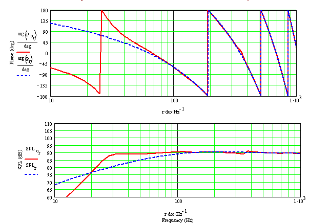

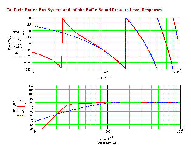

FWIW, here's my Vb = Vas, Fb = Fs ML-TL based on my way of calcing them:
L = 45.22"
CSA = 133.5"^2
zdriver = 17.81"
rp = 1.25"
lp = 2.13"
zport = near/at the bottom
Obviously, this puts the driver too low, so a mass loaded bottom chamber is required, which can do double duty as stabilizing stand. This long a pipe needs a massive top also, whether multiple layers of wood, or my fave, a marble, slate, or similar decorative top plate.
Since MJK's WS's adds the flexibility though of what's possible with increased stuffing that I wasn't willing to explore on an experimental basis decades ago, a longer pipe to shift the driver up to ear level can yield most of the smoothness without what I consider the excessive damping required when the driver is placed near/at the top and the vent near/at the bottom typical of BR 'tower' designs:
L = 55.38"
CSA = 133.5"
zdriver = 20.2"
rp = 1.5"
lp = 2.13"
In each case ~2.35 ohms series R is required based on published specs for a T/S max flat alignment.

Well, it had to be done: I've just modelled GM's two MLTLs for the F200a in the latest MathCad sheet. Absolutely superb (as you'd expect). Here's the anechoic prediction for the shorter enclosure assuming just 0.25lbs ft^2 of stuffing (in gif format Dave!!!). As you can see, there's a slight decrease in the response just before cut-off which will likely make their in-room performance better ballanced than one with a peak or a completely flat anechoic response.
I didn't run the in-room response for this one however, as Greg appears to favour the second, longer enclosure. Here's the anechoic prediction of that one with the same stuffing density (there will, however, be quite a lot more of it, by virtue of the longer line-length). A fractional increase will clobber the tiny wriggle, but personally, I wouldn't exactly be loosing any sleep over that whatsoever.
And here's the in-room prediction. Don't set much store by this, because it's dependent upon many factors, not least the HxW dimensions used, and is not going to be optimal. Carpeted room, front baffle 32" from the rear wall, front port, nearfield and on-axis. Very, very good indeed I would say.

Scottmoose said:Well, it had to be done: I've just modelled GM's two MLTLs for the F200a in the latest MathCad sheet. Absolutely superb (as you'd expect). Here's the anechoic prediction for the shorter enclosure assuming just 0.25lbs ft^2 of stuffing (in gif format Dave!!!). As you can see, there's a slight decrease in the response just before cut-off which will likely make their in-room performance better ballanced than one with a peak or a completely flat anechoic response.
Greets!
Thanks, but my default calculation is a T/S max flat, so I'm curious what specs you used since even the IB plot is a bit different.
As your room sim implies, it's typically not a good in-room alignment unless the room's quite large and the speakers are well away from any wall/corners, but it's what so many folks want/expect to see for comparison purposes that I've given up posting more room friendly ones unless specified. EBS alignments or vent damping works well to get a flatter in-room response for when Fb is down below the beginning of room gain and of course any sealed alignment with a <0.7 Qtc is typically room 'friendly'. In a perfect system though, the room will have a 12 dB/octave room gain curve and the speaker will have a complimentary sealed alignment with a matching F6 so that they sum flat.
Most rooms become increasingly transparent with decreasing frequency though, so to get a ~flat alignment to very low frequencies normally requires some peaking at Fc/Fb/Fp, so huge IB, BP, or TL loaded with very low Fs drivers has historically been the preferred way to do this. Today though, mass quantities of power and drivers that can handle it combined with digital EQ can be had relatively cheaply, so has become the new 'standard' in this 'brave new world' of miniaturization, shrinking room size true sub systems (as opposed to the typical LF systems being pawned off as 'sub' systems) into 2 ft cubes. Just like comparing optimum Vs 'small' horns though, something gets 'lost in the translation'.
GM
