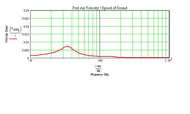

New feature guys: a plot showing the air velocity in the port and when it hits 'danger' levels. Very useful indeed. See below picture. That red line? When it reaches 0.03, you need a bigger port!
Sorry it's been a while but I knew Martin was fixing a few bugs and adding this and a couple of other tweaks, so I decided to wait. However, I promised some notions of an MLTL using the Lowther PM6C. Martin was kind enough to send me the correct T/S parameters, as those published on the Lowther site are... a little bit off. In fact, they're so far off it isn't even funny in my view, but there you have it. Fs in particular, to give just one example, is grotequely optimistic. 36Hz is claimed, Martin's pair were circa 57Hz. None of which is to suggest they are anything other than superb drivers, I gather they are, and Martin rates them very highly indeed. I'll probably buy a pair in the New Year myself, which is perhaps the best mark of my confidence / opinion. It is however a cautionary warning -don't assume the published data is particularly accurate. That goes for most other manufacturers too.
OK, so I could have just done yet another regular MLTL for them, right? Well, I wanted to try something different. I can do normal MLTLs practically in my sleep by now, I've modelled so many of the things in Martin's software, and I'm not knocking them -they're great. (I've built a fair few in the last 18 months or so too -6 pairs if memory serves, not counting the 3 pairs of ML TQWTs and various other boxes). But I wanted to do something a bit different to show you what the new software can do for you (ahem). See the next post for exactly what.
