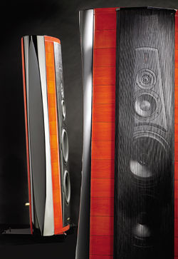

Scottmoose,
I'm glad to read about your interest and positive experiences with wide-ish speakers placed close to the wall. I think on-wall flat panel TVs will create a large demand for up-against-the-wall speakers, and good CAD tools to model speaker placement, point sources vs. linesources, and optimizing cabinet shapes at the wall boundary would be very helpful. Maybe modest depth waveguides can create a more 3D soundstage for on-wall speakers. There appears to be a market waiting for new solutions.
from Sterophile Sonus Faber recommends near wall placement.
"The Stradivari's wide baffle produced a singular sonic picture. Instead of the more common narrow-baffle, low-diffraction sound, in which a speaker "disappears" to leave behind a ghostly apparition of a three-dimensional sound picture, the Stradivari presented a more weighty, unusually solid picture that seemed to be a three-dimensional curtain wrapped behind the baffles and extending well back into virtual space. While more conventional baffles have produced wider, more transparent soundstages and perhaps more focused and upfront images, none has delivered such a solid and physically believable three-dimensional soundstage in my room—aided, I'm sure, by the Stradivari's rich, palpable midrange."
Now that is very interesting, as it seems to bear out what I'm finding from running the simulations in Martin's software, and my practical experiences with a pair of WB MLTL mules I knocked up a few months back. Thanks for letting us know. I've not read any reviews of these beasts (all £22,000UK of them I believe) -I think the only UK magazine that featured them was Hifi News, and I don't buy that very often. Looks like we're on the right lines anyway!
