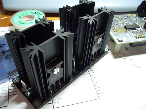

What is the best Diode for this application:
Aleph-X 2*100 watt's monoblock's?
There is a lot to choose from, so hopefully some of you guy's
can answer this. To list some options:
Mur1560 to220, Mur3020 to247 dualdiode, Rurp1560,
Rurp3060 to220 and propoply some more!
I also have some of the Fairchild Stealth diodes, R3060 to247,
this is a to247 single diode, but would that work in the rectifierboard? It is also made in to220 case, and that would also be an option.

Also, as far as the best diode choice goes, you may be better off asking in a seperate thread, as I haven't tried out as many different diodes as a lot of other people on the board have, so probably aren't the best to advise. However, I can say that if you have a diode in a TO-247 case with two legs it will not fit into the board, and if you have a TO-220 with three legs they won't fit either so that kind of limits your choice a bit. And, if you are asking in relation to an Aleph-X then I can tell you that the diodes used in the PASS labs amplifier are the BYW99W-200's which are the diodes that are included with the kits, so these may be a good place to start.
