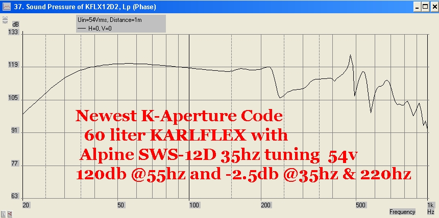

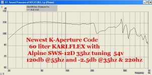

I slapped the new Aperture onto the Alpine SWS12d simulation to try it out and experiment ...I attached a response graph to this post... Looks like it works well, the bandwidth is limited to about 220hz but that is just the nature of that driver, it is not meant to be a midbass device and 220hz is actually pretty good in this case .... You can see the resonance of the front chamber and aperture attempting to create some sort of output around 450-700hz but it is not consistent enough to be useful ........ This is with an aperture CSA of just over 700cm2 so perhaps i could reduce the CSA and shift that upper resonance downward making it more useful for this particular cab...
Decent output for a 60 liter box 😀 , and really not terribly different from the guesswork sims we were doing with Hornresponse, but this is a nice way to verify that work 🙂 According to these results i am thinking the LAB15-4 should also look pretty good in the 90 liter Karlflex. but i will try it out to be sure ..

MJM,
Nice work there - the 220Hz and the shape of the falloff seems about right - playing with the aperture's profile can change this. What I found is if the aperture starts small (like a cusp) and expands following the Karlson profile scaled to the length and width needed it can smooth it out pretty well. If the profile starts with a finite slot width you get higher SPL output but at the expense of more peakyness.
I described how I automated it in the Karlson thread. Basically I curve fit the Karlson profile into a parabolic non dimensional unit function that goes smoothly from 0 to 1 for an input of 0 to 1. Use that function multiplied by desired aperture width. The input variable is distance along aperture from small end. Use real aperture distance divided by total aperture height to get non dimensional height as input into function. Use that function to set, automatically, via equations, all the radiator sizes (Width and Height and x & y position) along the aperture length. Then you have one master equation that controls the profile. If you modify that equation it can change the profile shape or whether or not you have a cusp or a slot. It's a lot equations but if you use a recursive programming structure you can copy and paste and modify the indices.
Hope that helps.

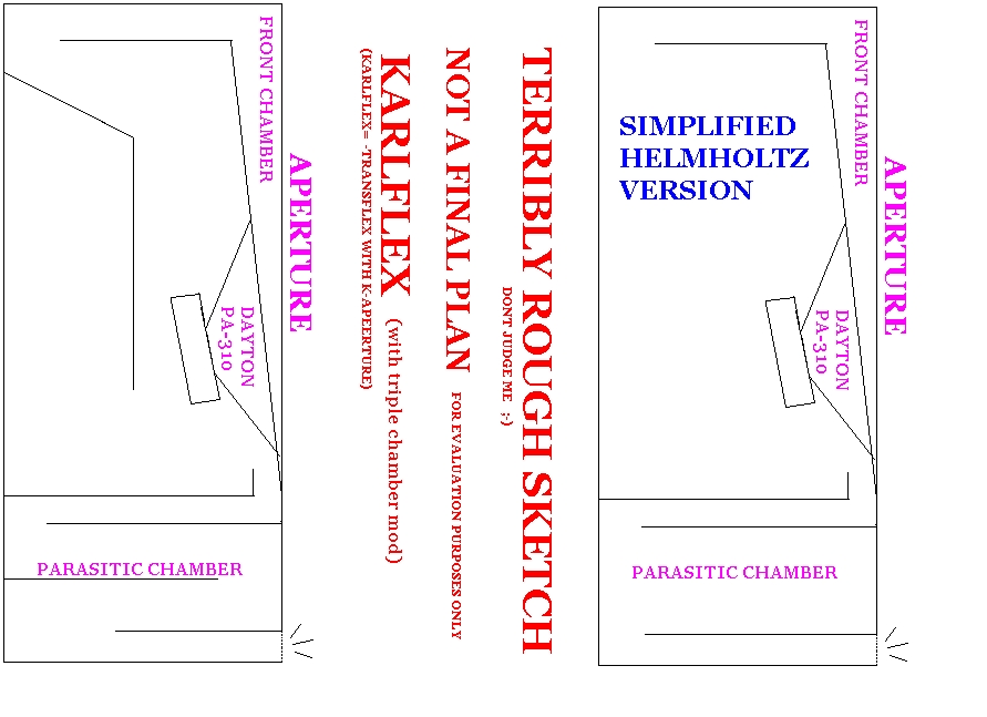

I am working on a simplified version of my tri-chamber K cab that looks like it might have potential for smaller drivers, but right now it is scaled up for a 12" Dayton ...
X , You might find this interesting

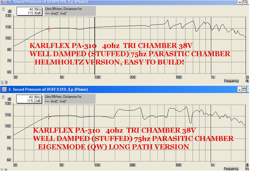

But hey , XRK, I did figure out something intriguing yesterday that might be of interest to you since you build K-subs with smaller drivers .... I am able to get (according to sim) the same output and excursion control from a simplified (more helmholtz based) tri-chamber Karlflex type cab (Like a DCR-Kcab hybrid) compared to a Tri-chamber Karlflex with long path (eigenmode version) ....... Not sure if i believe it since i have always had better luck getting satisfying low-end with quarter wave loaded cabs, but this is so simple and easy to scale down for small drivers that it is very tempting.
The parasitic chamber is well damped (using stuffing) on this cabinet tuned to between 1.6 and 1.9x fundamental and it reduces excursion by 2mm on the PA-310 which allows 38v input (instead of 28v) while still staying within the safe physical range for that driver ... Along with the extra 30 liters of cabinet size gives me an additional 4db output according to Akabak! 😀 This is a great thing for a driver that has so much thermal power handling yet so little physical capability ..... Might be something that could be useful for an XKi type box with drivers that like this Dayton have plenty of electrical power handling yet low xmax 🙂

XRK,
Ok , i am trying out cusp versus slot style apertures and it does change things a bit .... Pipe harmonics still seem to create some interference with bumps & dips in the midrange response but i am curious to see how similar the real world measurements look ... Do you notice some midrange discrepancy between your simulated K-boxes and their measured response?
I will read through the Karlson thread in order to try to better understand what you are describing here ..... I have managed to link the dimensions of the K-ap ports to the radiators using the "DEF=" command which speeds up the process of adjusting the aperture contours and areas, but i have a way to go before tying everything into a master equation ...
Both sims here are using the "cusp" style K-aperture ...
That is interesting that the parasitic chamber is connected to its own vent? What does that do?
Btw, you can scale your plot box vertically and it will increase resolution to 5dB per div. Then go to the edit menu and copy as bitmap. Then paste into paint or whatever program and save a png file. Your plots will look better and not have the windows dialog box around it.

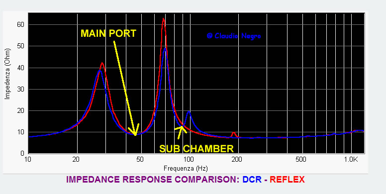

Here is what i meant (in the rant above) about the distinct DCR impedance curves ....
One is Claudio Negro's comparison of a DCR Reflex (blue) versus standard Reflex (in red) where he shows the DCR's upper impedance peak being slightly suppressed with a notch being taken out of the upper slope ...
The second photo is a screenshot of the impedance graph produced by my DATS unit connected to our homebrew DC-OD-MTM-TL towers that we crafted for my friend's home theater system about a year ago ... You can see the resemblance except the notch in the upper peak is more prominent to such an extent that it basically splits the big peak into two almost equal peaks .....😀
So if i can do this with an offset-driver TL (QWP) , then why not a Karlflex or a Tapped Pipe or even a Tapped Horn if i wanted? ..... It complicates the design but when you are using a driver that severely lacks excursion (in relation to it's thermal power handling) then it may be worth the extra effort🙂
Hopefully the impedance curve of this Pa-310 Karflex will look similar to either of these other dual chamber examples so i know that i landed the parasitic resonance in the right range:xfingers: ..
The third picture shows the special DC-style MTM-TL towers, thanks to our comely friend Annabelle for modeling with them :happy2::hbeat:

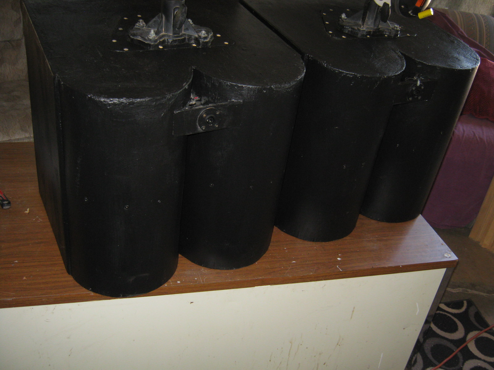

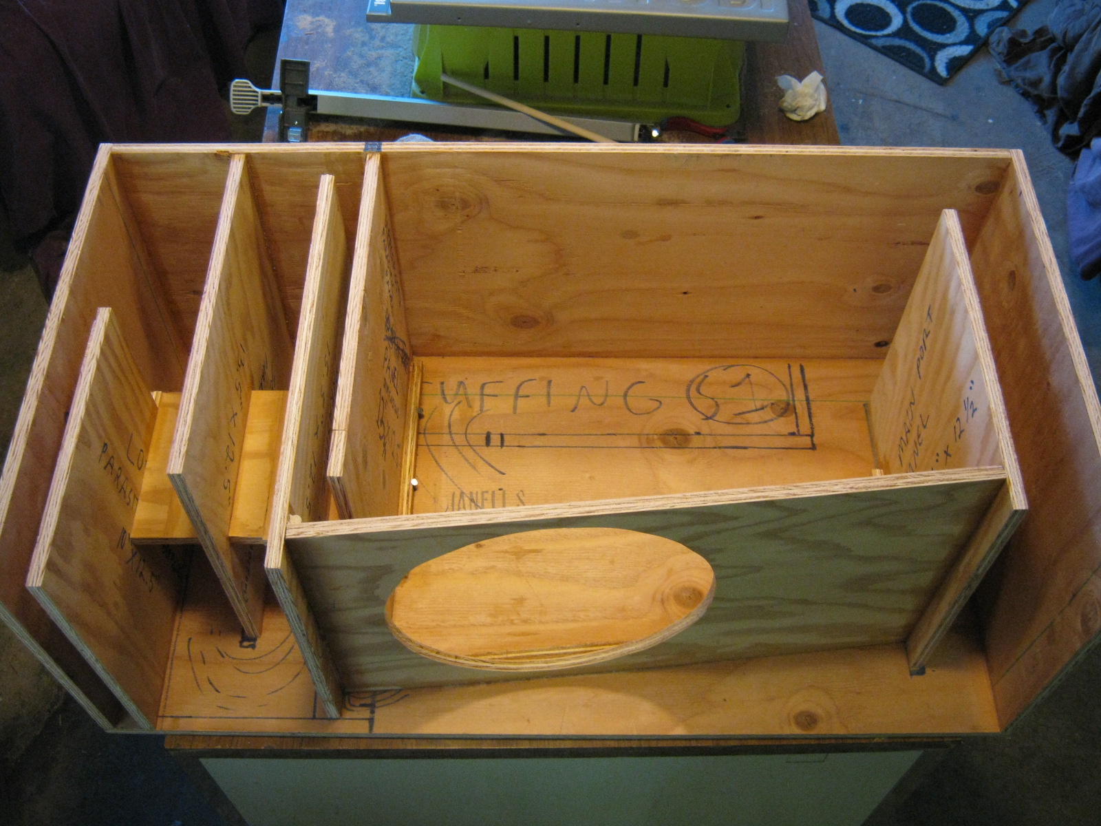

Almost there🙂 (check out the attached photo)
Nice work, the understanding you have on ports and resonances as applied to these designs is impressive, thinking outside the norm, not being a follower leads you to explore things only a few have an understanding of, rather than trying to copy the latest trend. It is great that you are now able to build and test your hypothesis. I wish I had the time you have to enjoy such persuits.
I do notice in the pic that the joints are less than perfect, this is where PL glue works wonders with such a complex box. It would be a shame if leaks hindered the performance.
I still intend on building your design for the 10s you gave me. Shed is almost done, just where to find the time.
:wave: Mr Pete !! Good to hear from you! 🙂
Thank you Sir! I have been working on developing a better understanding and a "feel" for how it all works with the intention of making something different, something refreshing, because i was just so tired of seeing everyone regurgitating the same alignments over and over and over again, tapped horns , front loaded horns , sealed boxes , reflex boxes blah blah blah , i wanted something different, or at least an interesting modification to the tired old designs ...
I am very happy to have some of the proper woodworking tools now so i can build things without having to rely so much on folks like my buddy Tim or others to use their woodshop, it was just too inconvenient having to work around their schedules and projects ended up being delayed and drug out for far too long, progress was too slow ............ Now i can hang out on my patio in my bunny slippers and my bathrobe zipping out panels with the tablesaw and gluing acoustic contraptions together while sipping lemonade that my girlfriend just made and hanging out with my cats 😛 LIFE IS GOOD! 😀
You have a good eye Pete! Yes, you are right, my cuts aren't all very precise yet ..... I bought a couple of tubes of the PL ("premium 3x" it says on the tube) in order to put the side panel on so everything seals well, but before i do that I have some weather stripping on the edges of the panels for experimentation with stuffing & such before i use the PL to permanently attach the side ...
I will post some measurements & pictures here in a bit ........... I think i might have a leak in my application of weatherstrip or a phase issue or something so i am trying to sort that out before moving forward .... :scratch:

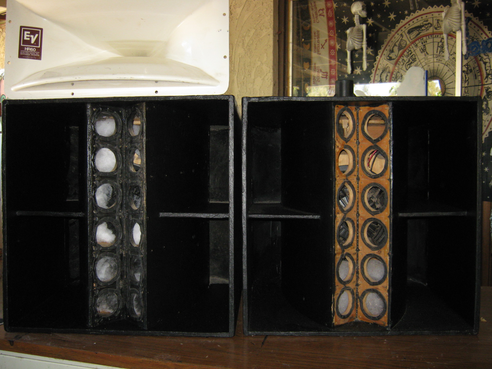

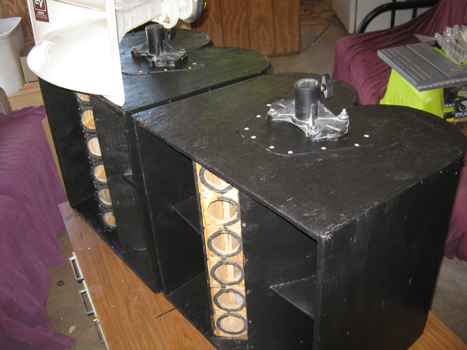

I patched up your old DR250s , fixed the damage, and Adam and I just finished painting them with black Duratex on tuesday , they are looking pretty sharp! ... I even got new neutrik speakon connectors for them and new cabinet corners (still have to put on the corners) ... Also still have to seal the front columns (where the piezo tweets used to go)..... I will attach a few pictures for you to see ...
We also found out that pairing up those big white EV HR60 horns with your DR250s seems to be a winning combination ..... I screwed on a few of my Selenium d220ti compression drivers to the back of the EV horns and used a super simple crossover (one that compensates for the "CD horn" tilt in response) which gave us support down to around 1k ( precisely what the 250s really needed with those P-audio drivers) ... Good match, sounds nice ..... I guess these will go together as a set now, so i am going to build small boxes to enclose the HR60s , and they should fit nicely on top of the 250s because they are the same width :bullseye: ..............
The Facebook sound group misses you, I have been doing my best to keep it somewhat active while you are on vacation 🙂
