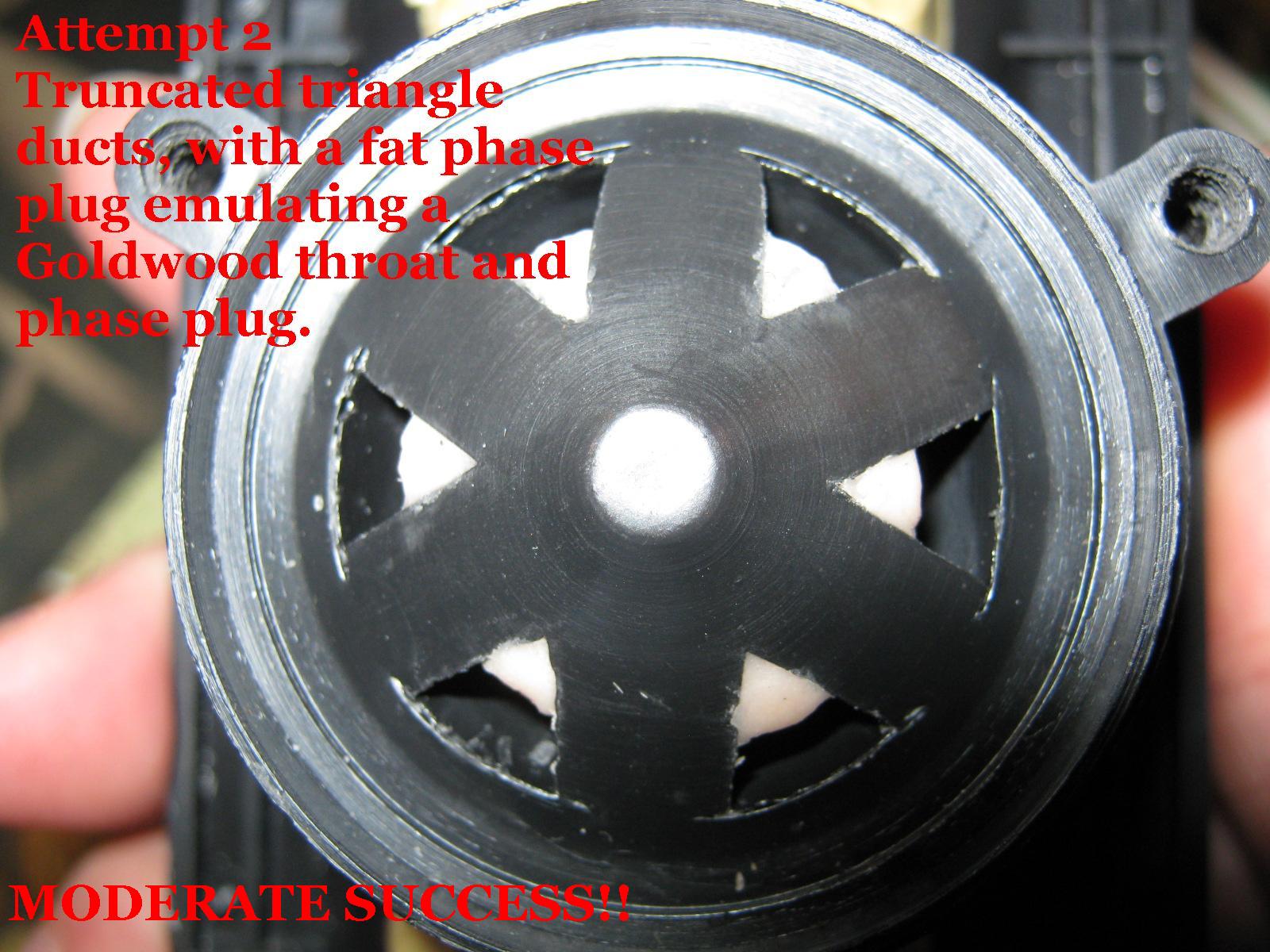

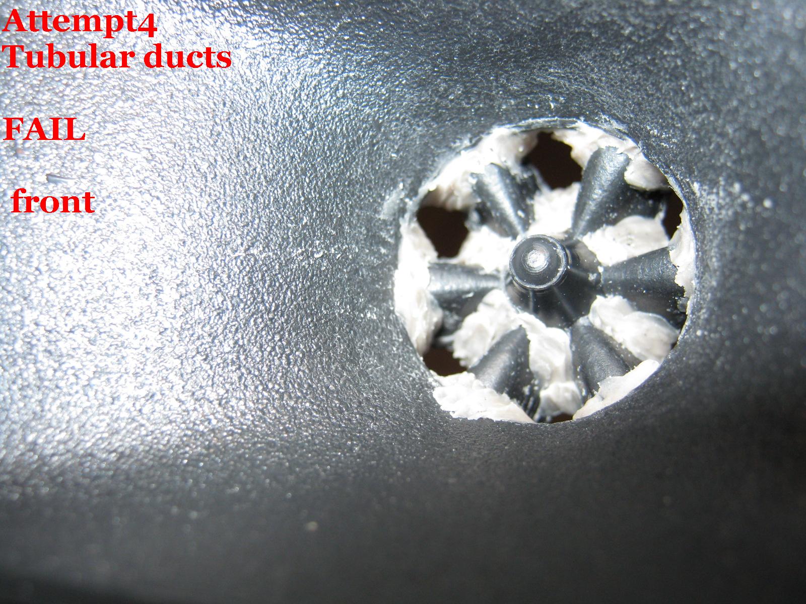

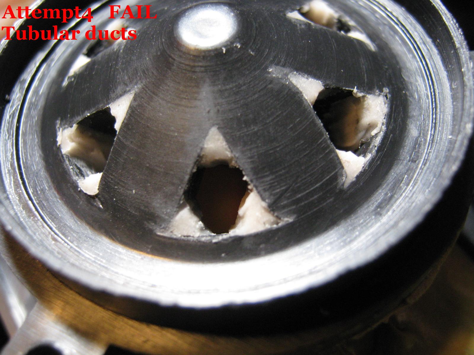

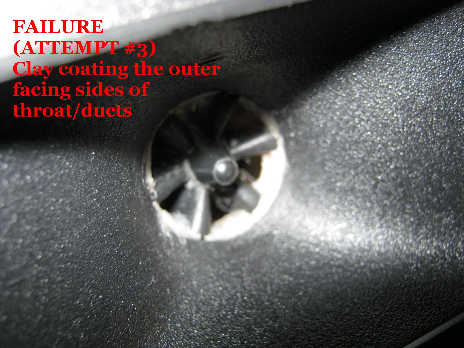

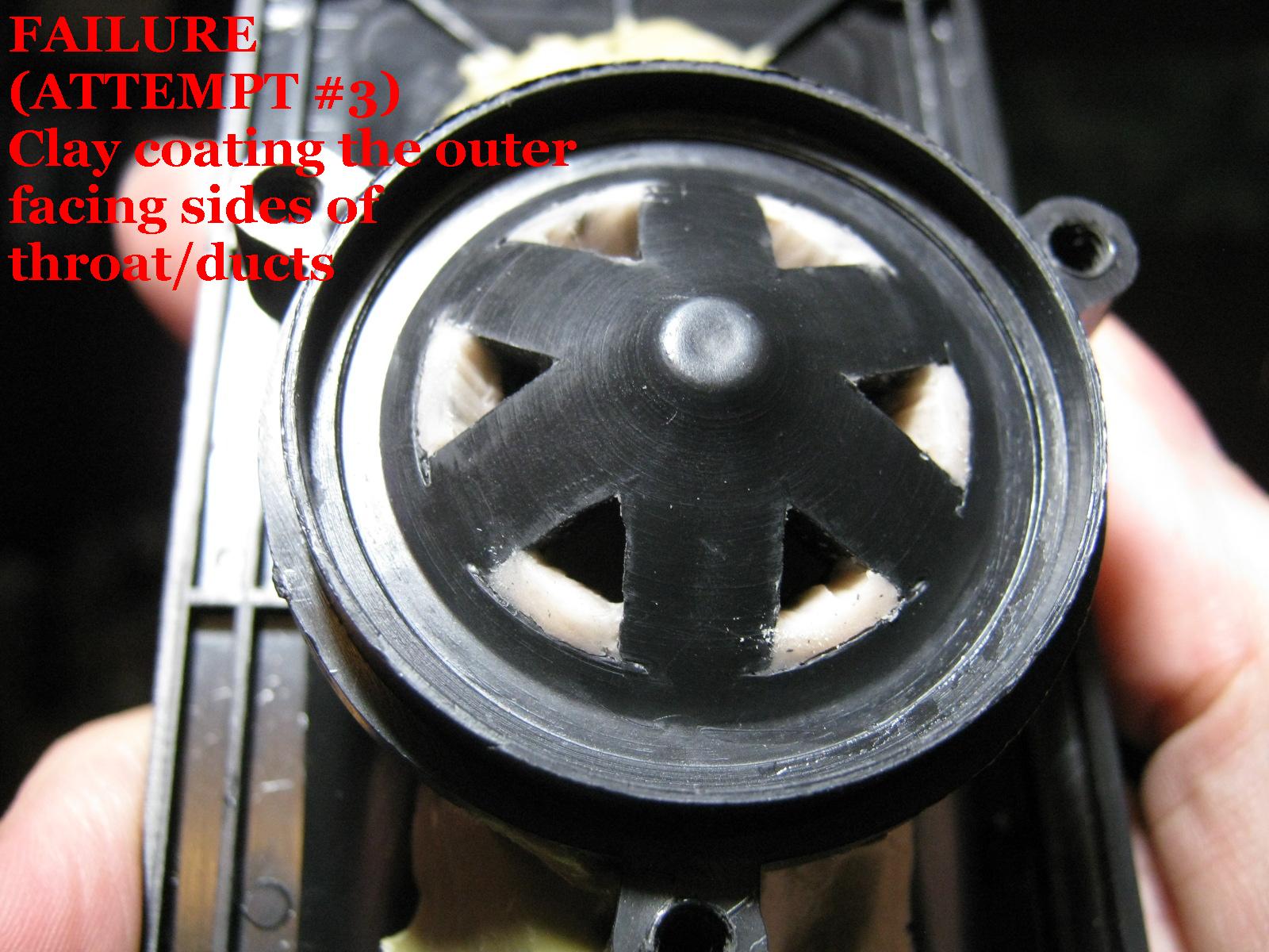

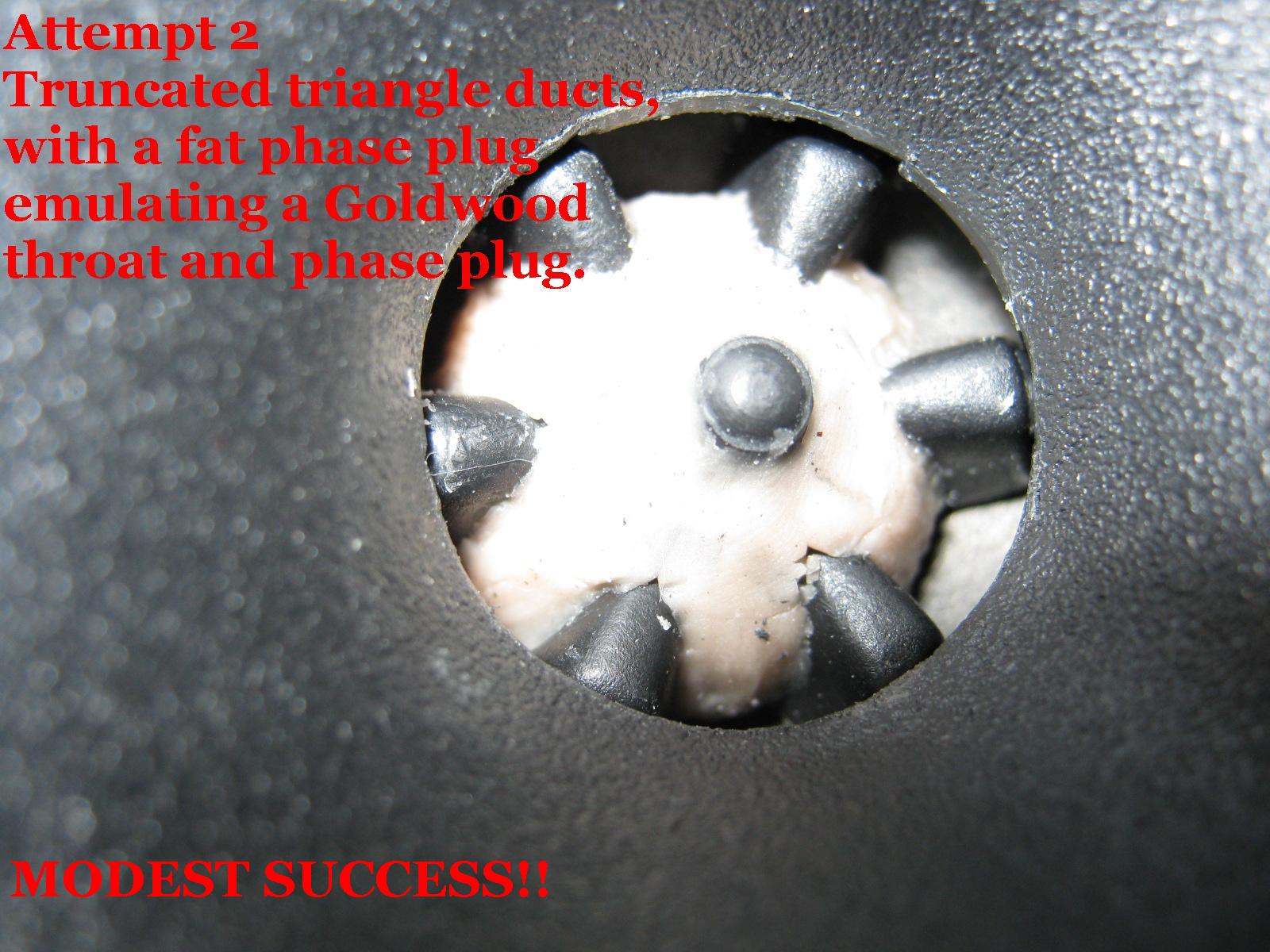

Ok , i ended up getting some clay from my artist friend who makes clay figurines .... He gave me two different types, one is something that he called a polymer clay which is a type that you can harden by baking in the oven like Don Hills recommended and the other was a type of modeling clay .... I ended up using the softer of the two (the polymer clay i believe) for ease of use and i knew this was all going to be very temporary, so the soft stuff works , if i wanted the modifications to last longer i would use the harder modeling clay....
I basically only wanted to see if i could modify the GRS 1016 throat to match the performance of the Goldwood horn with the GRS element/cone assembly loaded onto the back of it ....

- First of all i tried plugging a few of the throat ducts on the GRS horn throat to increase compression in an attempt to match the total CSA of the Goldwood's throat, and this method produced ragged response with two ducts plugged , and then with three ducts plugged it made the response even more erratic so it became clear that this isn't going to be as simple as needing some increased compression, there is going to be more to this Frankenmystery 😛 ...
- Second: I added the clay to the inward-facing point of the triangular ducts making them truncated triangle shapes just like the Goldwood 1016 uses , and the clay lined the inside of those ducts all the way through the channels up to where all the channels merge at the other side of the phase plug .... This basically results in a thicker phase plug (more girth), once again resembling the Goldwood horn ....... THIS METHOD PRODUCED THE BEST RESULTS ... A reasonable improvement over the stock GRS horn , and almost as good as the Goldwood horn (and in some respects better, such as less of a dip at 18khz) ...
- Third attempt: I attempted the opposite of the above by moving the clay to the outer edge of the throat ducts , basically filling in the bases of the triangles ..... This produced terrible results with a response that was even inferior to the stock GRS horn .....
- Fourth attempt: A combination of the above methods filling in all points of the triangular ducts making them more like tubular ducts and the results were mediocre at best, no real improvement over the stock GRS horn ....
All of this experimentation gives me a good idea of what changes would have to be made to the GRS horn to make it perform more similarly to the Goldwood horn .... It seems like (at least part of) the magik of the FrankenPiezo revolves around a much thicker phase plug and ducts that have a trapezoidal shape ..... I feel as though performance could have been improved further if this same (GW style) trap duct shape and large phase plug were used along with enlarging the triangular duct's bases (outer facing edge) ...
