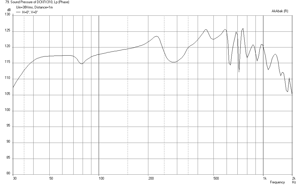

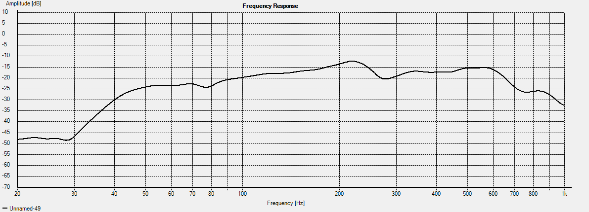

Here is the 5db per division graph from Akabak for the 40hz Tri-chamber Karlflex loaded with a PA-310 ..... Hopefully the real world results won't be quite so volatile but it will likely be somewhat midrange dominant ....
HolmImpulse and DATS measurements to be posted later today 😀

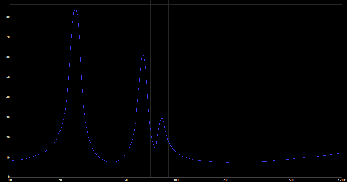

The parasitic chamber seems to be functioning properly and it's resonance landed right around 75hz which is exactly what i was shooting for .....

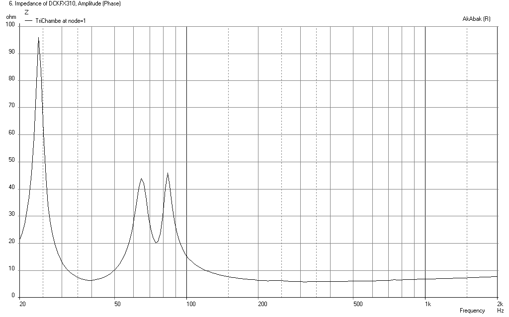

I attached impedance curves measured by the DATS unit (without aperture attached to front of cab) , with S1 fully stuffed and a small amount of stuffing in the parasitic chamber/pipe ...... I also attached the simulated impedance generated by Akabak ..... You can see that the measured impedance closely resembles the classic DCR but it may change a little once i add the aperture ...

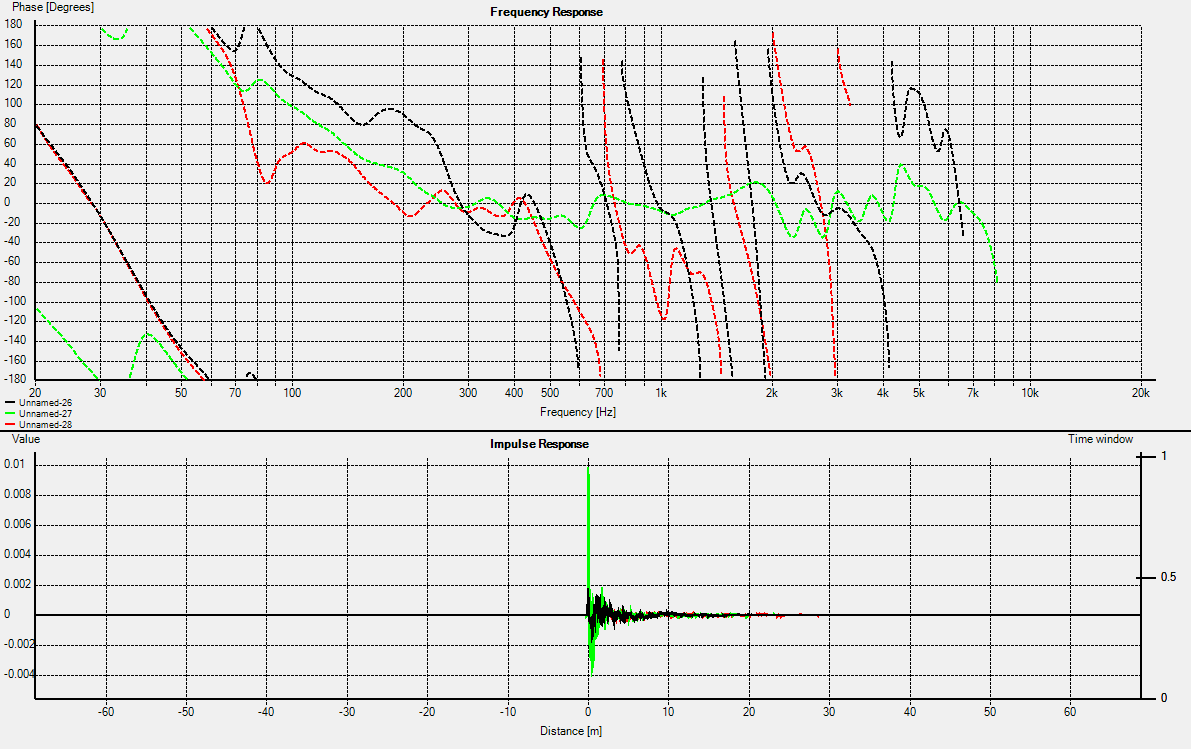

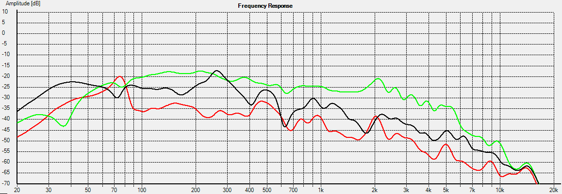

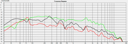

Using HolmImpulse and my Dayton EMM6 mic i measured the output at each port and also the cone ...... Green=Cone .....BLACK=main vent .... RED=Parasitic chamber's vent ...
Output shows signs of being highly overdamped right now which is to be expected since without an aperture it is basically operating as just an undersized Offset-Driver-ML-TL with parasitic chamber, the K-slot aperture will add two orders and makes the system behave more like a series tuned 6th order box with some tapped effect and should alleviate the overdamped condition to some extent allowing for more output at fundamental ...
The phase plot shows that all ports and the cone become fairly phase coherent around fundamental which is GREAT! Then they deviate around the parasitic resonance which is to be expected in a DCR-ish design, then above that they become fairly coherent again out to almost 500hz which is actually pretty awesome 🙂 But once again , things will change some more once i get this box tuned, and a K-slot slapped onto the front ...
  • Tri-Chamber-Karlflex-stuffedS1-ModerateParachamber-stuff-Black=main-vent__ Green=cone__ Red=para.PNG
  • Tri-Chamber-Karlflex-stuffedS1-ModerateParachamber-stuff--AKABAK-IMPEDANCE.PNG

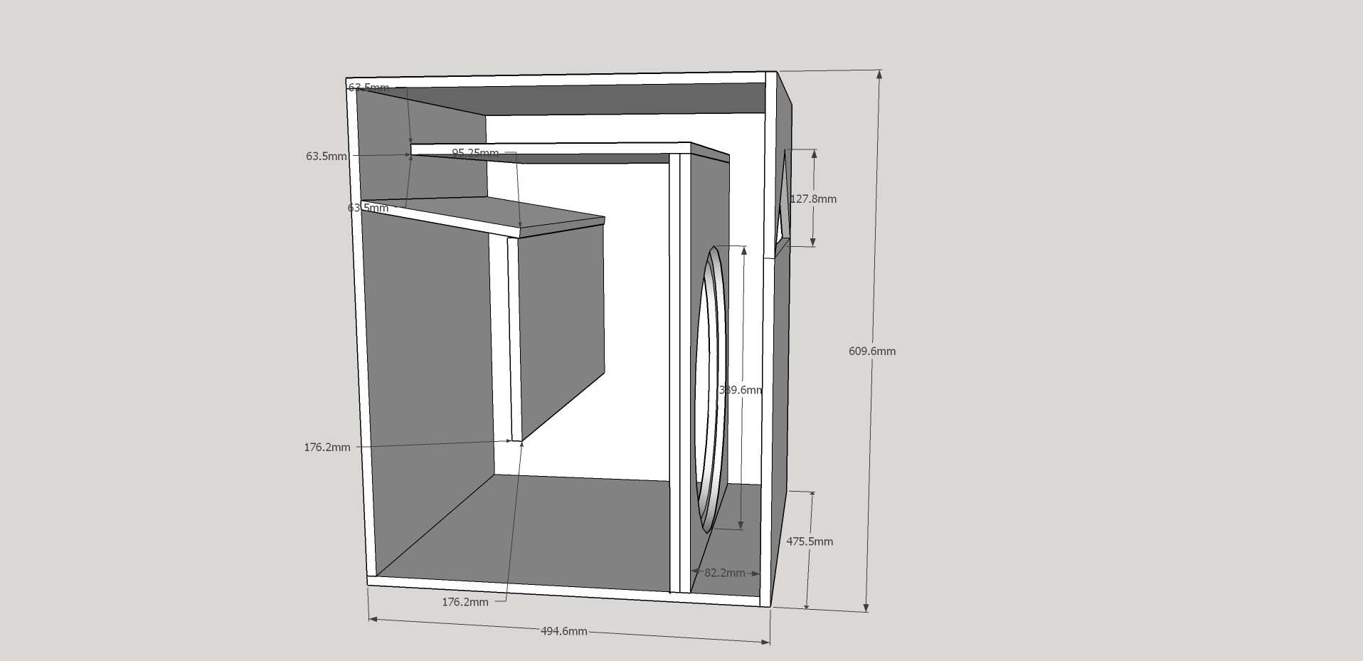

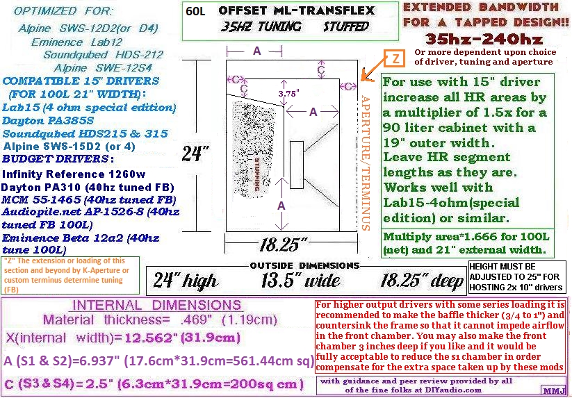

New to the party, I'm interested in building using one of the lab15-4ohm that I picked up. Just wondering if I'm on the right track using 12mm ply. I know the internal tilted portion didn't come out too well on sketchup, but you get the idea. Design was utilising the attached plan by MMJ and the 'fire-in-the-middle' karlflex apeture.
I have an inuke 3000 and dcx2496 for power and xo, finish exams mid-june so should begin construction there-abouts.
Quick conversions:
H = 24" = 609.6mm
W = 19" = 482.6mm
D = 18.25 = 463.55mm
A = 6.937" = 176.2mm
C = 2.5" = 63.5mm
3.75" = 95.25mm
Matt.

Hello Mattcalf!
Glad you were able to pick up some of those Lab15-4s , i keep telling folks about them because they are one of the best values in the subwoofer driver market right now, it is a very good dollar-per-decibel deal 😀 (they are still available on ebay for the moment, but who knows for how long, so people should grab some while they can!)
I can see that you made the box a little deeper to compensate for the extra front chamber depth and double-thickness baffle 🙂 .... No problem at all, looks good , your slightly larger front chamber will increase the midbass presence a little bit and lower the bandpass cutoff, depending on the size of the aperture's opening which are all effects that are totally acceptable for that driver .....
Your sketch and numbers get my stamp of approval :up: However this box will need some bracing of course, fairly similar to how i braced the Tri-chamber Karlflex that i posted the pictures of recently with a brace on top in the main vent , one in the S1 area , and one on the bottom panel connecting to the S1 panel ... If you would like i can sketch it up for you.... You may also want to put a small vertical brace behind the front panel (below the pyramid) , of course it could not have too much depth or the cone will smack it at high excursions..
The Fire-In-The-Middle aperture is a good choice (as is the inverted K-slot) for this heavy driver because it adds some parallel loading and adds gain in the midband and midbass (below cutoff) .... I would suggest that the Pyramid shaped mouth/terminus have a cross sectional area which is no less than the SD of the Lab15, if you make it much smaller than that it will likely tune the box too low and you could lose performance .... The Pyramid's vertical placement will also effect the fundamental tuning of the box (placing it lower tunes the box lower) .... 35hz is a good target FB for this cab with this driver ... Do you have a way to measure your FB? If not just message me in private and i can give you a few methods ...
Of course since you are in Australia you will have to do all of this upside down 😉 but the same principles apply :usd:

So here are some pictures and graphs .... I ran some tests on the Tri-chamber Karflex loaded with PA-310 without the K-aperture attached, and i can already see that it tuned below my target ... The fundamental really needs to land around 44 to 46hz because the K-slot aperture will add more path length/loading and drive down the fundamental to around 40hz .... Attempting to tune below 40 with this driver in a small box is counterproductive, so i am going to stick with my ending target of 40hz, which means i will have to make a few adjustments to the box ....
NOW FOR THE GOOD NEWS! 😀

The sim and measured impedance plots do have a strong resemblance, and i was very happy to see that 🙂 Once again , thanks a bunch to you and the other awesome folks on here that got me started with Akabak ..

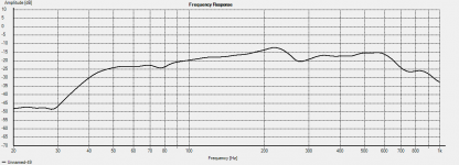

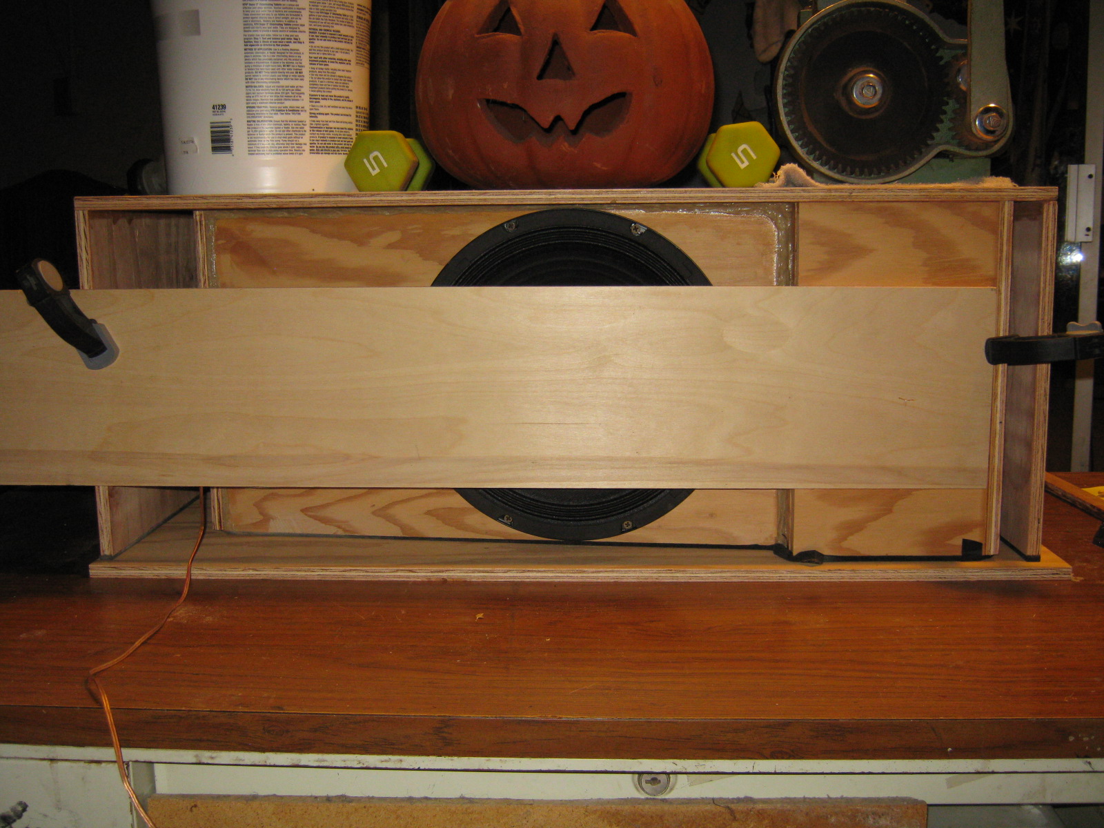

Over the last couple of days while i was doing some testing with different amounts of stuffing i also experimented with a simple clamp on plank-in-the-middle sort of aperture (something i could easily slap on the front while the side panel is still just temporarily sealed with weatherstrip) ..... I attached a picture for everyone to see , and you can also see some of the heavy items i placed on top to apply pressure to the weatherstrip ... hehehe ...
The plank style aperture allowed for a rather large mouth area at 860cm sq , and despite the large mouth area there was still a noticeable bandpass cutoff around 600hz and FB was shifted down by about 2hz ...... I attached the measured response graph .... Still looking somewhat overdamped , but not sounding too bad really (I do however notice a small amount of that muddy delayed or echoed mid sound that you mentioned XRK) .....
I have no doubt that the actual K-slot styled aperture will probably behave a little better, but i still need to trim up the main vent a little more yet (FB needs to come up by a few more hertz) before i glue the cabinet side on permanently ..... 40hz output should come up a little more with the additional tapped effect i will get with a proper tuning & aperture (and smaller mouth area) ....
NOTE: I have found out that stuffing is a necessity with this cabinet using the PA-310 , sound quality drastically improved with fine poly-fiber stuffing added to the S1 area (and also a little in the parasitic chamber section where there was room for it without choking the path) , it really cleans up the midbass and midrange and makes this box much more pleasant to listen to. The difference to my ears was dramatic, but oddly enough the measured amplitude/frequency response didn't really change much at all, although the measured impulse response did look cleaner , so maybe that is what i am hearing (and or something phase related)......
  • Tri-Chamber-Karlflex-PLANK(IN THE MIDDLE)-APERTURE-EARLY STAGES-PA-310.png
