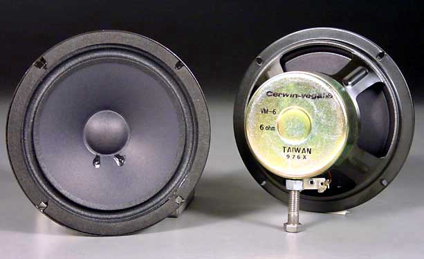

Yessir , that is the one 🙂
I am estimating SD at around 130cm sq ...
I have four of these .... They sound loud for their size, great clarity in the midrange and upper midrange , very strong out to at least 5k ...
Steve figures they handle about 50w rms ...
Initially i ordered four of these drivers and when the box arrived at my door i of course very enthusiastically tore the box open like a kid on christmas morning but was saddened to find that one of the drivers had it's frame bent during shipping, so i let Steve know about the damage and he sent another out immediately because he is awesome like that! 🙂
I ended up tearing apart the driver with bent frame so i could measure the top plate thickness and length of voice coil ... It turns out these little $6 drivers have between 3.5mm and 3.75mm of one-way xmax! (assuming the suspension will allow the cone to travel that far) ... Not bad for the price😀..
It uses an aluminum voicecoil former, if they had used a non-conductive material for the voicecoil former the QMS could have been higher but i am not complaining , i really like the way that these perform ...
I have two of these left that aren't being used for anything at the moment .... If you guys want me to put these on the DATS to verify T/S parameters just let me know, hopefully if there are any surprises they would be pleasant surprises .. 😉

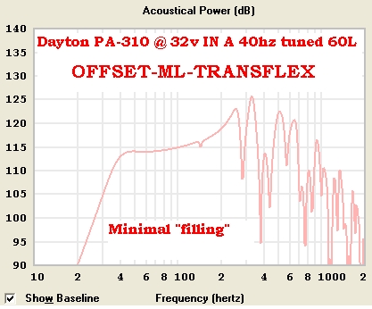

Here is the simmed response of a Pa310 in a 60 liter Offset-Ml-Transflex, which is very easy to convert into a Karlflex 😀 A scaled up & offset XKI would also have very similar response with potentially better output on the very high end (as in up around 1k or higher) since the driver would have it's cone facing forward (better for approaching full range) ... For bass cabinets i would stick with the motor-out method ...
This graph is with barely over 100 watts ... Decent efficiency for such a small cabinet and great bandwidth .. Good deal for a 60 dollar driver ...

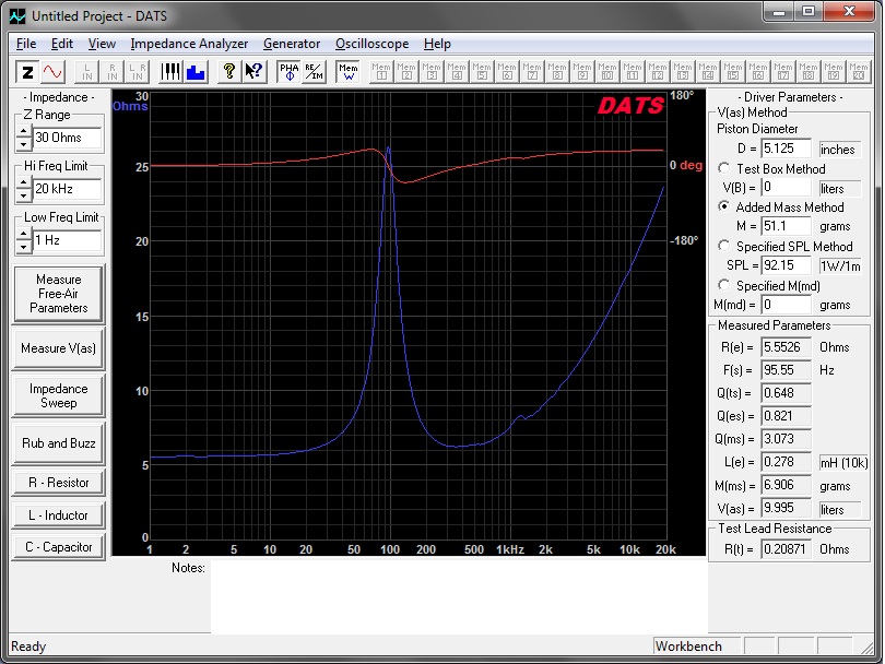

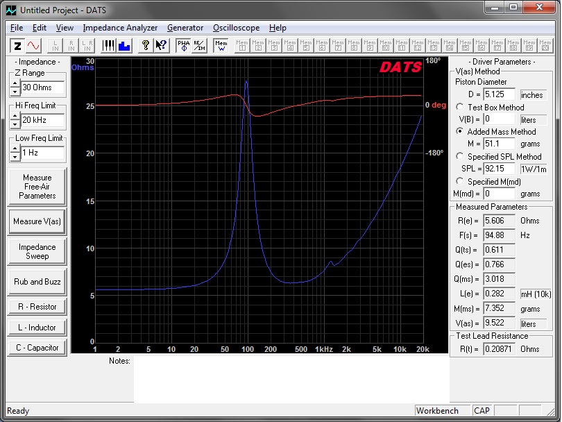

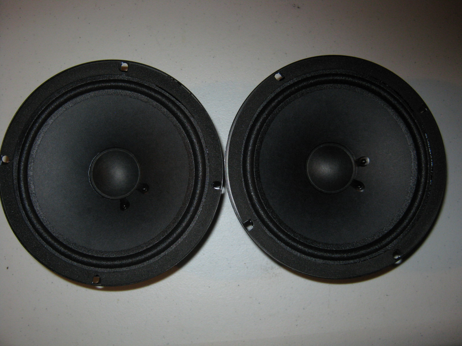

As promised CV VM6 measurements via DATS
Here are the screenshots of the measurements I just took with Dayton's DATS unit. As you can see these figures are extremely close to what Steve has listed on his website .... These Cerwin Vega VM6 drivers from ApexJr are fully legitimate! :up:
Mine were shipped zip tied together face-to-face .... Light paper cone, inverted & treated cloth surround, bucking magnet and main magnet enclosed in a metal cup (shielded i suppose they call it), good construction , glue looks clean and precise ...

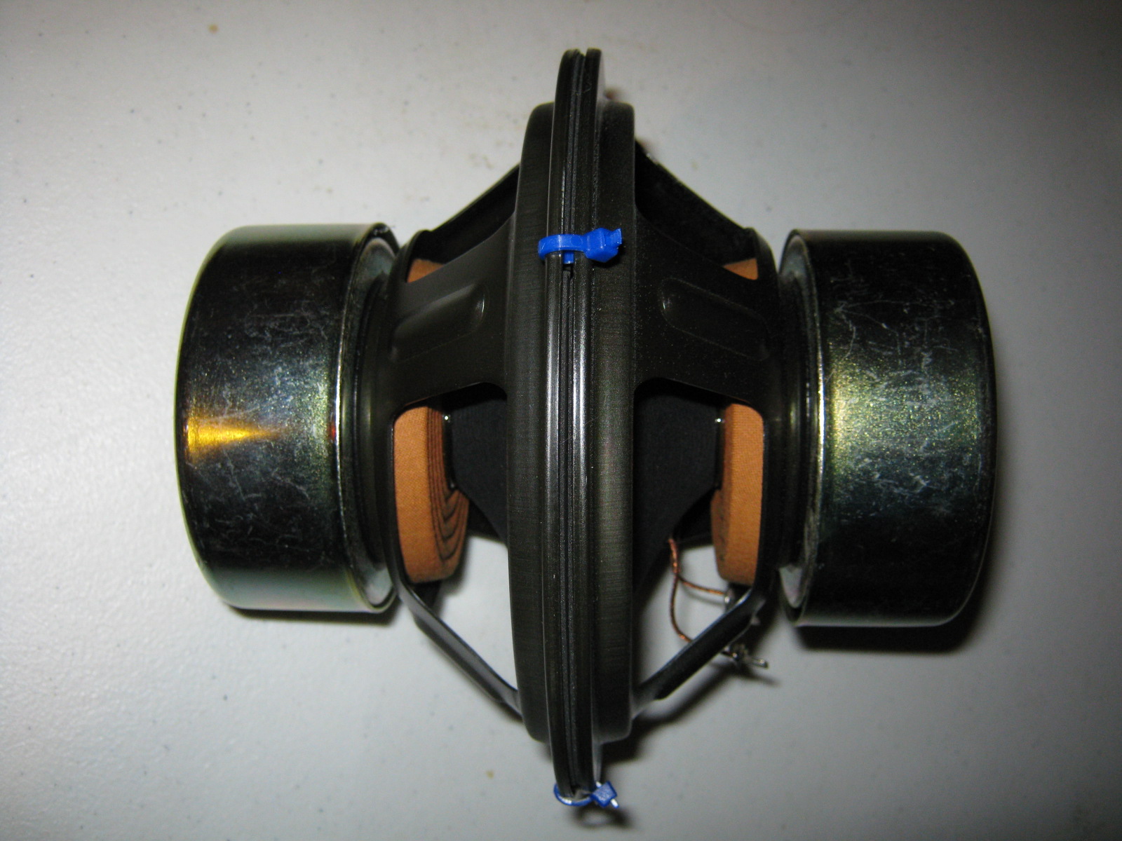

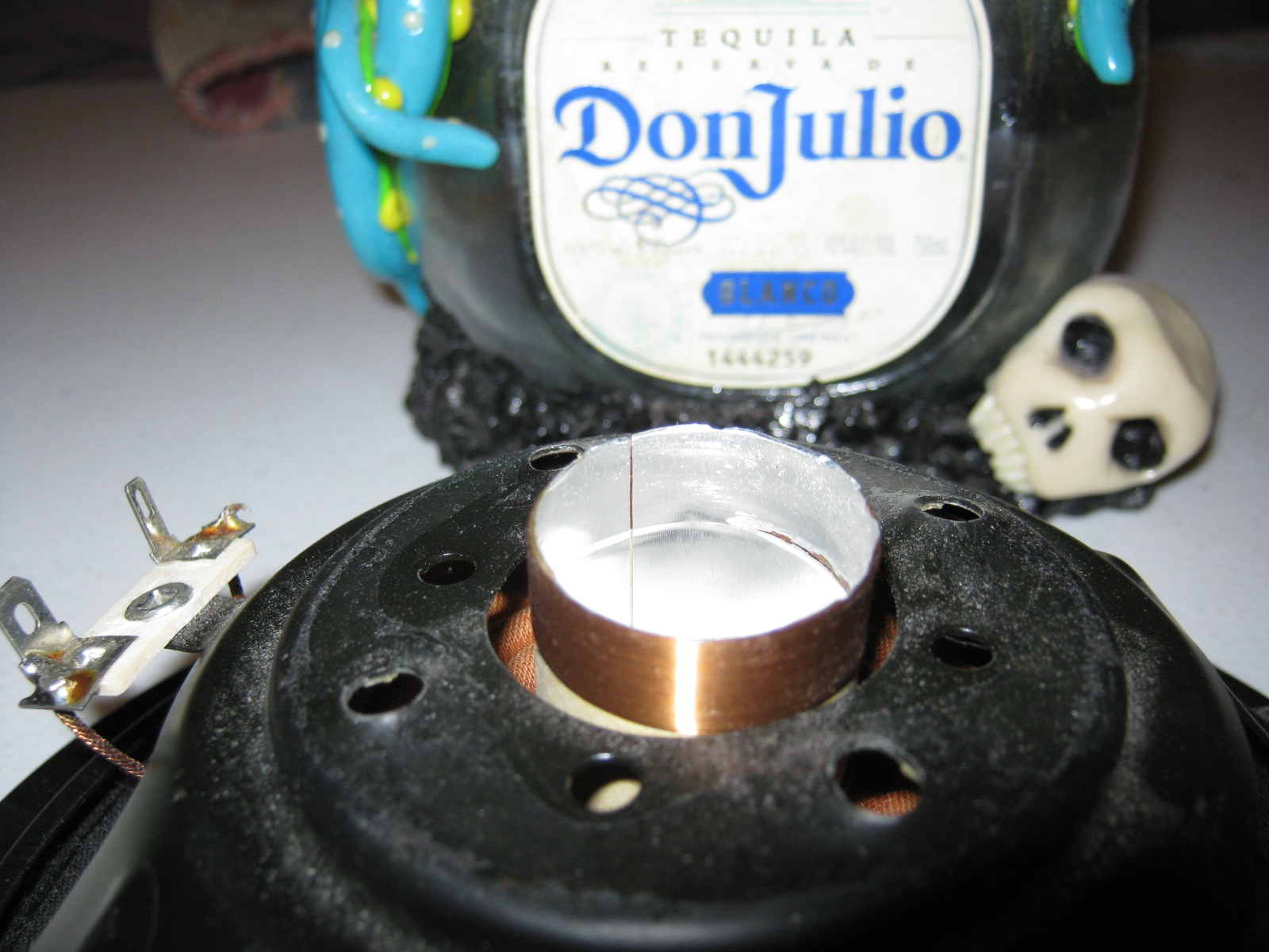

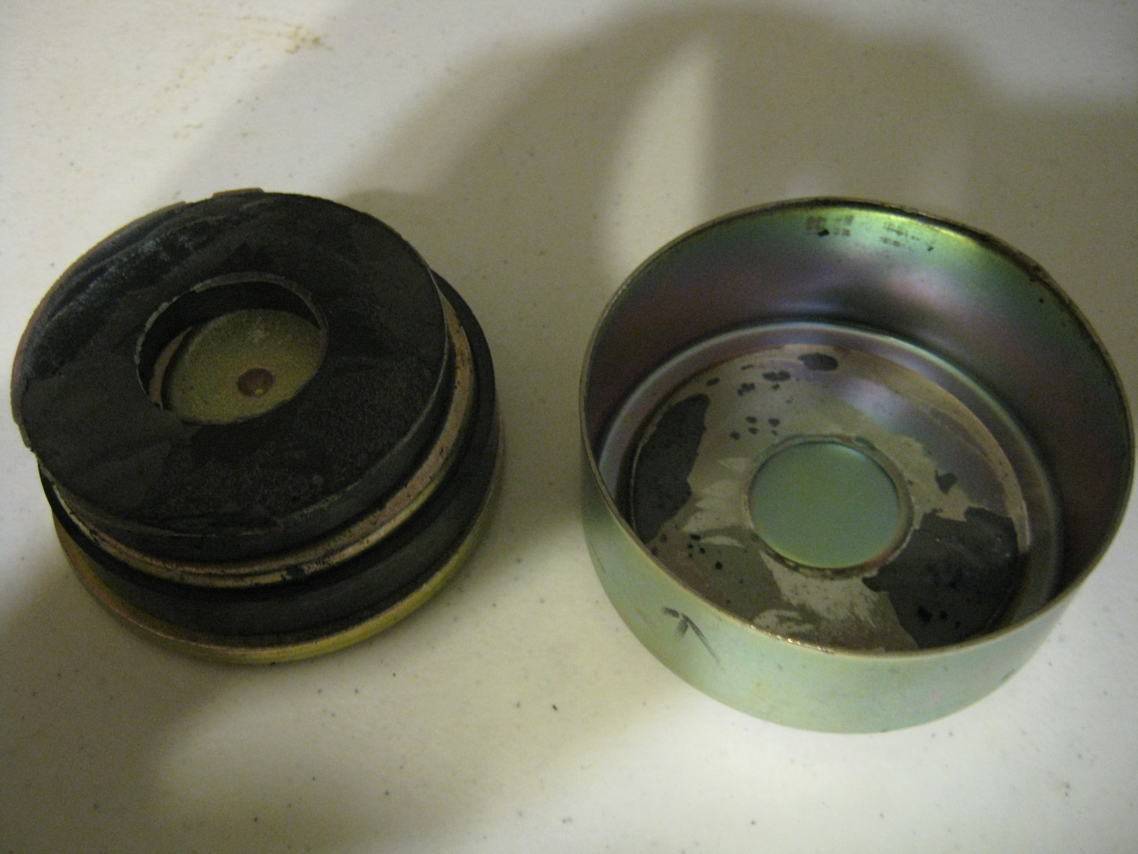

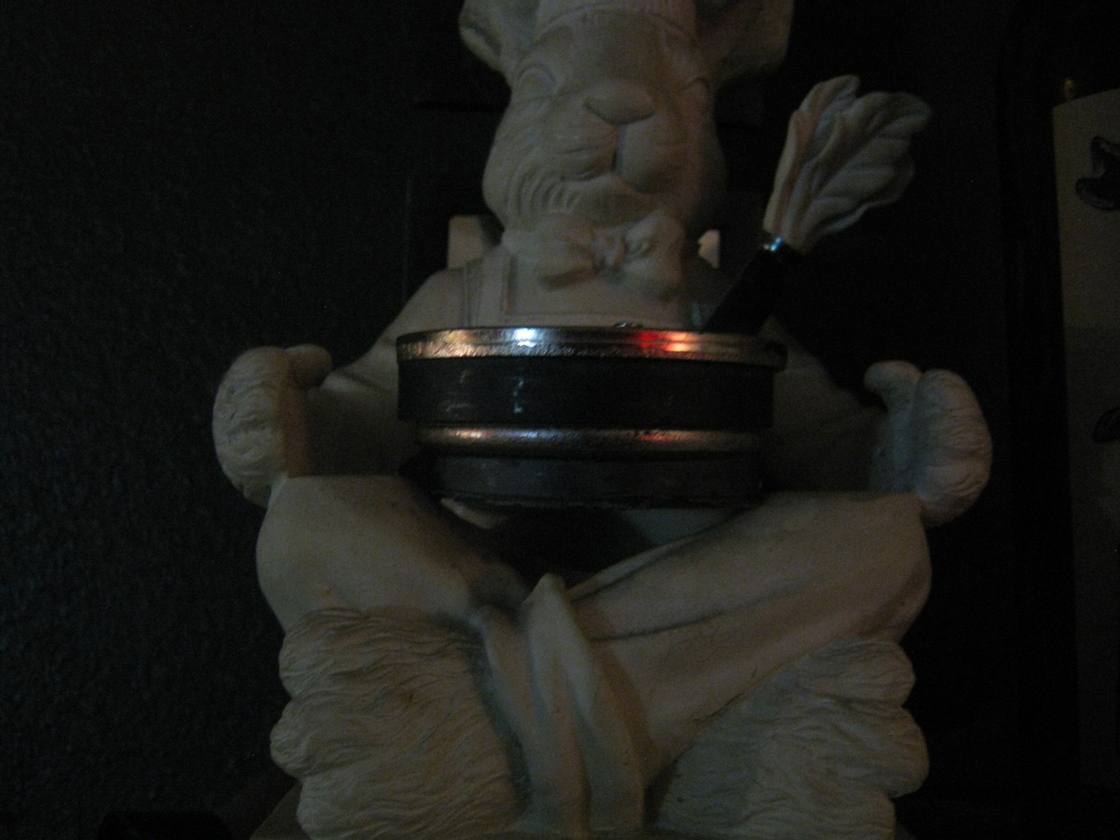

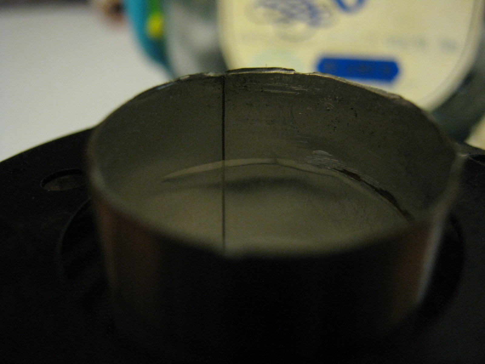

Here are some pictures of the Cerwin Vega $6 VM-6 driver that i tore apart ...
It was sacrificed in the name of SCIENCE! 😀
The frame was bent so badly that you can see it actually even caused the voicecoil former to crumple just a bit when i tried to free up the cone by hand ...
In these different pictures you can see the slit in the aluminum former (it is a 1" diameter vc), you can see the pole piece and the gap in another pic, you can see the nice thick top plate, and also the bucking magnet ...
The windings on the voicecoil look like copper or maybe CCAW?
