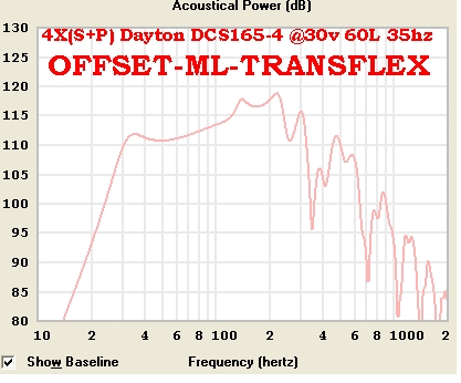

I am taking screenshots of graphs from various drivers simulated in the OD-ML-Transflex cabinets, i will post them soon .... I will add the 1260W and also the 4xDayton 6.5s ....

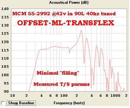

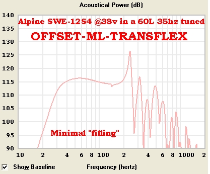

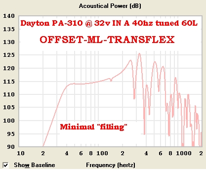

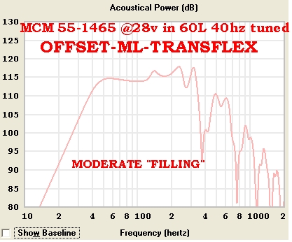

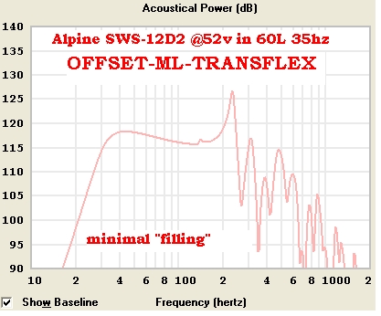

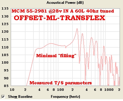

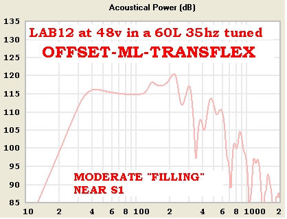

Response graphs with various drivers in OD-ML-TRANSFLEX CABINETS
Here are some simulated response curves with various drivers in our recent Offset Mass Loaded Transflex cabs , I haven't started on the 15" drivers yet but here is some of what i have so far
The Lab12 looks alright now, but the 12D still beats it and costs much less .... The SWE-12S4 looks respectable for the price! The Rockville W12T3-S4 looks exceptionally good in a 40hz tuned box but i honestly have no idea if their published specs can be trusted, they are a newer company and not much is being said about them so far, i am tempted to order a few and put them on the DATS, but i dread the hassle of returning them if they turn out to be garbage
I am somewhat impressed with how well the PA-310 and MCM-1465 performed with relatively low power levels (remember that 28v @ 8 ohms is half the power of that same voltage at 4 ohms) but also keep in mind that the cabinets were tuned up to 40hz in these cases which improves efficiency... Still, , not bad at all considering the small size of these cabinets.😀
The MCM 55-2981 and 55-2992 turned out to be somewhat disappointing in the simulations (due to their lack of motor strength), these drivers look beastly but it is really a shame that they don't perform accordingly (at least not virtually), but at least the 2981 is inexpensive ...... The 2992 is by no means the best Dollar-Per-Decibel deal out there unless you can pick them up when they are on sale (I got mine for $30 a piece!) , and it takes a 75 liter(minimum) cabinet of this type to accomodate them , the sim was at 90 liters tuned to 40hz ... The Goldwood was also not-so-hot ..
Enjoy the mixed bag,
MORE TO COME !
MORE TO COME !

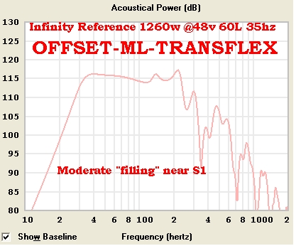

As requested
Freddi , your 1260w doesn't look bad 🙂

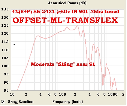

Tb46 asked about four 55-2421s in the 90 liter cab, here it is (based upon MCM's published specs)

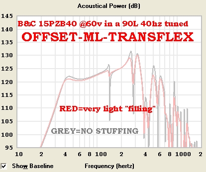

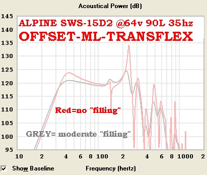

Will post some graphs for the 15s in a moment ..

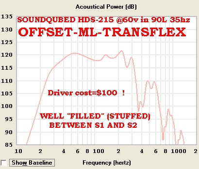

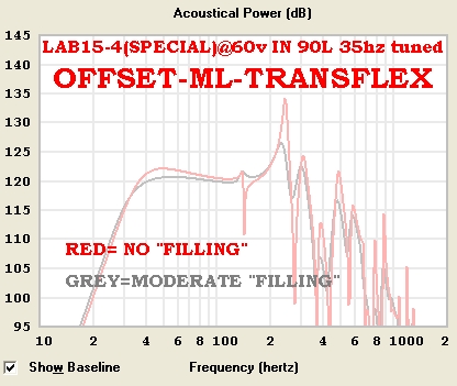

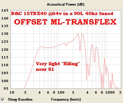

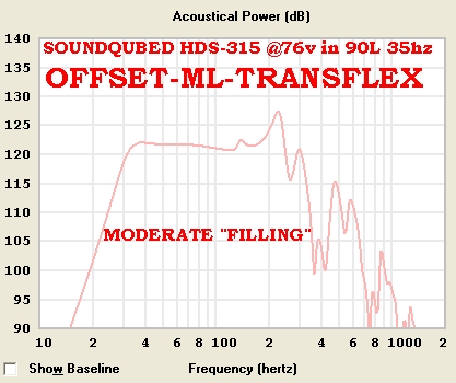

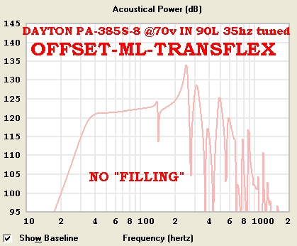

I am putting together those sims for the 15" drivers in the 90 liter version, posting them in a bit
So would we call this a Karlflex micro?
A KARLFLEX !!!!
HAHAHAHA I LOVE IT!

If i made one of these offset Transflex boxes with a K aperture would anyone mind if i also called it a Karlflex?
15" drivers for the 90L Offset-ML-Transflex
Here are the simulated response curves for some 15" drivers in this 90L Offset Mass Loaded Transflex cab .... Some of these drivers did not need any filling at all, others needed some, The HDS215 needed quite a bit to flatten out, and still didn't quite get there ..
The HDS315 plays very flat but lacks efficiency and requires a lot of power for high SPLs.
The Definimax did very poorly so i am thinking about taking it off of the list in the sketch completely
On a positive note the Lab15-4 and the Pa385S look FANTASTIC in this box!!
P.S. I appreciate the level of efficiency with the PA385S in this relatively small box (small for a 15" driver) ...
