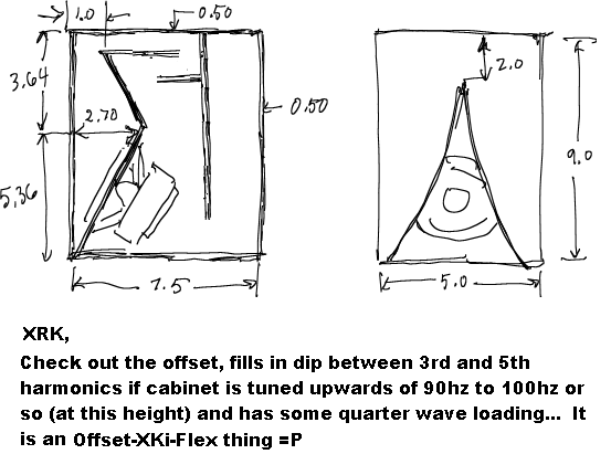

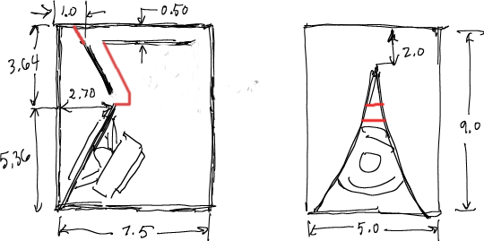

If it turns out that it does have some amount of ripple & dip in response between the 3rd and 5th harmonics when measured then i had an idea for an XKi offset modification ... I don't imagine the mod would be terribly effective unless the cab was tuned higher since the stub section needs to be in the vicinity of one third of the FB's quarter wavelength, but maybe some stuffing in the stub section would help if it is a little short in relation to FB ...
I think some 100hz tuned XKi boxes as tops for a Mini-Pa system would be super cool !
Xrk , how would one of the XKi boxes simulate tuned to 95hz with the fantastic $6 surplus Cerwin Vega 6" driver from ApexJr.com? 😀
A thought i just had
In regards to the above post (#976) ,
Since we are dealing with a shortened path via mass-loading maybe that amount of offset would still be fairly effective at smoothing out upper response ripple whether the box is tuned lower or higher as long as the port/constriction doesn't add an excess of path length ....... hmmmmmmm..:scratch2:...

Neat idea and it kind of resembles a Karlsonator now. Haven't looked at the Cerwin Vega blowout drivers before. I love cheap drivers. 🙂
