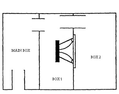

Saba, to answer your question about what an 8th order can look like , here are two types in pure helmholtz mode (attached) , but something like this can be arranged in any number of ways as Freddi and XRK pointed out even some of the Karlson cabinets could be considered 8th order ...
The 8th order examples that i attached to this post have three resonances (one more than a helmholtz based 6th order)... The extra resonance can be really useful if properly spaced but of course tuning a box like this can be trickier, ironically designing in some quarter wave action by converting one of the sections into a tuned quarter wave pipe might make it easier to predict and work with and provide better output as well , but we wouldn't know for sure until someone gives it a shot ...
If i understand how they count up the orders correctly i believe the driver counts as two orders (even if one side fires into a sealed chamber) , and then every resonant section that is tuned to a different frequency is considered another two orders (so that means every chamber & port set in our Helmholtz mode example).... You could see these resonant sections as components that can be placed in either series or parallel but you have to be intuitive about how the sections will interact with one another ..... Series arrangements of resonant sections (end to end) can cut down on the size of the box because the lower frequencies can see the two sections combined as one big section (combined airspace, path length etc) yet the higher frequencies can see the sections as separate ... So in other words a single chamber or pipe can be made to serve double duty in a system like this. 😀
If you want to keep the box size compact with the higher order boxes it will likely require drivers with high motor strength (or extension will be lost in an "overdamped" condition), the same phenomenon that is observed with the ABC/DCR variants but the results (if executed well) are more output, reduced excursion..... Other benefits are possible like group delay that is more evenly spread across the bass spectrum and a smoother roll-off on the bottom end that sounds more natural (ABC/DCR boxes can do this, i know this from personal experience) ..

Since i mentioned ABC/DCR alignments earlier i thought i might also throw THIS out there, it is a really interesting arrangement that employs a parasitic resonator... Many people that build this type of box may not realize that it adds quite a lot of damping and that the box needs to be bigger than a standard reflex box if using the same driver, however to get around this problem and to keep cabinet size down you can use a driver that has much more motor strength ... Something like one of the Soundqubed drivers would probably do the trick if you don't mind the foam surround ... They claim to have quite a bit of power handling for a low price ....
Output on these boxes is said to be pretty good , similar to a TL (qwp) but with better cone control ....

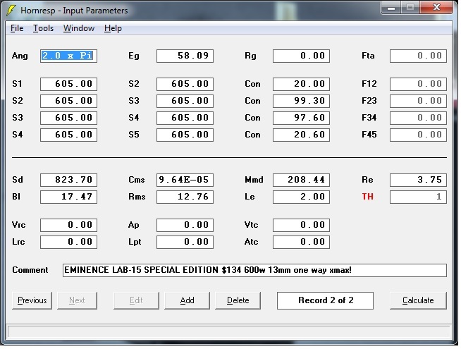

Here is that Special Run of Lab 15 ... Very affordable ...

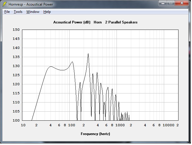

The cabinet that i simmed here is a simple 144 liter tapped pipe tuned to an FB of 35hz ...
2 cabinets (288 liter net) with 1200 watts give you pretty close to 130db in halfspace ... 3db down at 32hz ....Not bad at all really just not quite as compact as some of these other options we have been discussing here lately of course, the Alpines really seem pretty tough to beat so far when it comes to a high amount of output in a small space without spending too much $ .
The Eminence Tapped Pipe built very simply with a single fold would have a small footprint though because it would be just wide enough to squeeze the driver in, and not very deep , in fact i think the magnet would stick out 😛 ... It would also end up being about 4 feet tall, but as a workaround some mass loading could be added to make it into an ML-TP in order to shorten the path length and give it a larger footprint...

4 of those in a corner sim to 144 dB at 30 Hz. yeah, that's scary - and fits in the same size as my T60 🙂

Simply fold it in half = 119.45 cm i.d. [inside dimension] tall.
It's a simple pipe, so no taper, ergo its W x D on each side of the divider is = 605 cm^2 and since we need ~40.6 cm to mount the driver, then W = 605/40.6 = ~14.9 cm.
The vertical divider board down the middle will have a 14.9 cm gap to the top plate.
To confirm it’s at least 144 L net:
119.45*40.6*[2*14.9] = 144,520/1000 = ~144.520 L, so once the divider board and driver is installed it should be around 144 L, not that anyone could hear this small a difference down in the LF BW.
